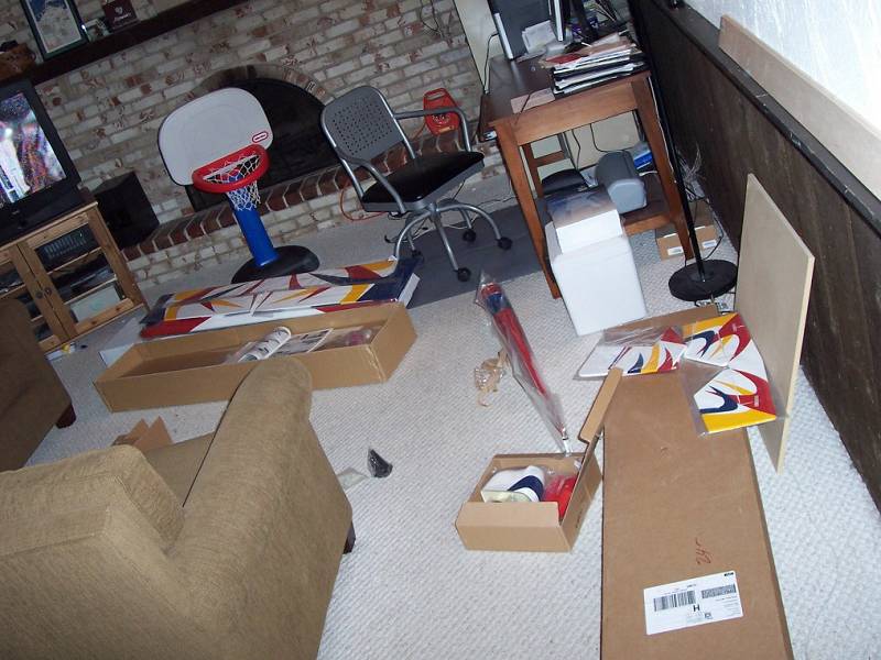

My U can was on the front step when I got home today. I haven't opened the box yet. I had to go pick up a Raptor 30 heli.
I was flying the Ucan on my FMS simulator last night and it sure likes to float. This thing flat spins almost as easy as the spa3d does.

WEE--HAA....... what a great feeling. a new plane
lets see.... the only thing i remember being concerned about were the pushrods being a little wimpy, i would go with 4-40 or carbon fiber from central hobbies on those.
i also hated the tailwheel,(but it will work) i used a sullivan tailwheel for 10-12lb planes
i always have problems(maybe just me) with the ca hinges supplied, i just reinstalled robart hinges and think they will last forever
