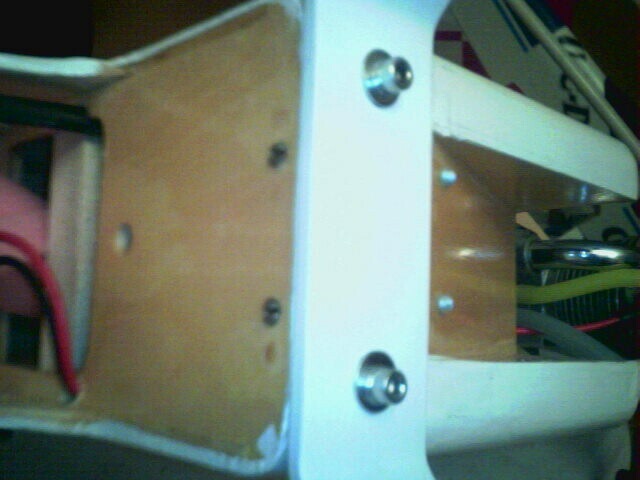

Rob, on my "Do" #2... Here's my almost info
.. on the tanks.. I did not fill test,
but it did look bigger than my stock tank... I had to trim the tank saddle and I also
had to trim/shave the bottom of bulkhead at the???>> Tank access hole to get the
tank in the nose.. The tank ends just about even with the bulkhead that the wing
dowel goes into.. But.... one problem
... I forgot which tank I actually got... I
really think it was the 12oz... But??... Both have the same dim.. H= 2 1/2 W= 2 1/8
except the L, 12oz is 1/4" longer.. 4 3/4 to 5"... I just checked mine and it looks
about 5" long.... This is from Towers... And its was either the Sullivan RST 10
(300ml= 10.14oz) or RST 12(360ml=12.17oz) I believe I got the RST 12... My stock
Tk. had printed on it 270cc(9.13oz)... You can check the conversions... But..........
Even if it does hold more fuel (Mine does)............. I still had/have a bunch of "out of
fuel" dead sticks [:@]...... But the "Do" floats" Great
.... But remember... in a 2-3'
hover>>> out of fuel>>> dead stick..... And....... As good as she is.........................
The "Do" does not float that good....
My Bat's are a charging.... [
].... Not the "Do" but three of my "others"... Just in case
the forecast is correct on the wind......

Rob.... I found my tower receipt... I got the RST 10.... The 12 will be too long, but can be
made to fit, just have to be more creative at the bulkhead/tank saddles....

Hello guys,
I have been flying that U CAN DO 46 with an Saito 82 apc 14x4W for a bit. Good plane but I don't know if I'm the only one but two times the landing collapsed on landing? What should I do to fix that, any experienced around? Let me know.
Eric
Eric

Choopi, Glad you're here. The 82 and 14x4 are perfect for it. As far as the LG collapsing are you saying the block has come out? If so that's a common problem with them but very easy to fix. A good fix for it is to take the LG off and drill a couple of holes for some metal pins that will go from the surface that the LG goes on down through at an angle and come out of the plywood section that is where the belly pan butts up against. It basically pins the LG block to the plywood bulkhead behind it. Let us know how you come out with it.
#5550
ORIGINAL: rclement
maybe it will help, we have all had that problem i think[:@]
make sure you use some 30 min epoxy down the holes after you drill and just before you screw in the screws. i usede 8-32 allthread rod on the first and on the second i used a couple of 6-32 screws about 3 in long.
