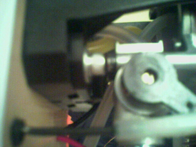

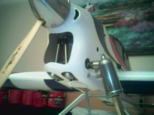

I just picked up a UCD 46. Will the Saito 100 be too much? What should I use for servos? I think I will be using standards and a HS-5625 on rudder. Any build tips?

ORIGINAL: mnrcaerobat
the 100 is a great engine, i use a 15x6 apc on mine, will hover great.balance will be easy, i have my rx and battery right behind the fuel tank and it balances at 5.5in behind leading edge.
you will want to beef up the LG a little, i just drilled a couple holes horizontally through the LG block and ran in a couple of peices of allthread with a little epoxy in the holes and on the threads and its still all together.
(pic below)
your servo selection will be fine.
just mount the engine as far forward ao the mounting lugs on the engine are even with the end of the mount, you may have to sand(dremil) off a little of the mount where the bottom left mount screw goes.
any more questions just ask

Did you use the stock supplied mount with the saito 100?
I am not sure what a allthread is or how to use it?

yes that is the stock mount in the above pic.
allthread is a threaded rod that you can get at any home depot type store, get either 6-32 or 8-32 size, then cut it to length(they come in approx 3ft lengths) and put a slot in the end for a screwdriver and you can screw it in for a snug fit (with epoxy all over it) just make sure that when you drill the holes you stay clear of the LG mount screws, (look at above pic)
