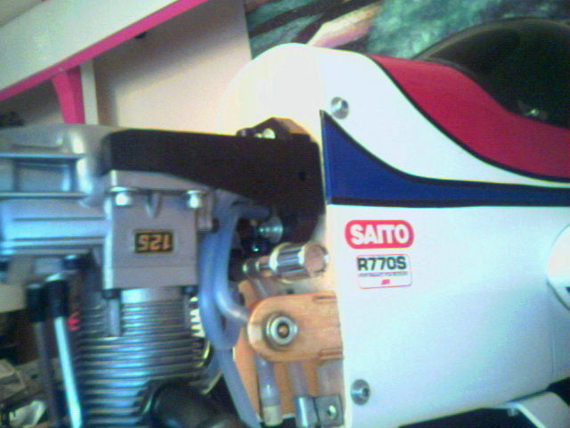

Mac, it fit on the stock mount, mount flanges have to go right to the end of the rails, cut a little on the bottom of the cowl for the rocker covers to fit through and its just fine

Mac, see the third pic? well you will have to sand(or file) a little on the screw hole so the carb mount screw will fit, other than that no more mods, i have over a 100 flights on this and the mount will handle the 100[8D]

G.......Wait, that's a 125 in a UCD 46???

OPPSSS, i did have that in it while i changed bearings in the 100, i couldnt see that in the small frame, but it did have unlimited vertical.....(the 125 does have the same mounting dimensions as the 100), all i had to do was adjust the idle a little
forget you saw that[X(]

acctually not a bad engine for the ucd, weight balances good, and since i use 60 size LG it had plenty of clearance for the 16.5x5 apc, it is a engine you really dont need on the ucd46 but it will work well......remindes me of Quigley when he said "i said i had no use for them....didnt say i couldnt use them"
