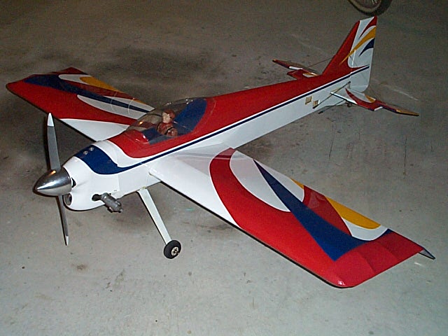

Hi Raideron, Try here for a 13x4w APC prop. [link]http://www.chiefaircraft.com/cgi-bin/rcm/hazel.cgi?action=serve&item=/Models/Accessories/Props/APCProps.html[/link]
#1219
Joined: Jan 2004
Posts: 1,693
From: Fort Mohave,
AZ
Thanks CeeGee.. I found a site... But :-( it cost me .25 more... Can't
wait to get my flight pack so I can see how she flys:-) Thanks again!!
On your expo.. I've never used expo, But I was going to try 15-20%
for a start, and adjust from there...
I was looking at your pic (like your pilot) and noticed your elevator
push rod on the bottom of the servo, shouldn't it be on the top?? Did
you use the stock rods?? I was just wondering if my setup had the
stock rods or not.. If you are using the stock rods, Does the clevis
have sprial type spring that hold the clevis close??

Raideron, I set up the elevator horn that way because I dont' have a servo reverser on board. I hope that's okay. I'm kind of new to this type of airplane. I'm going to have my former instructor maiden it so I'll ask him about it. I do have the stock control rods (2-56) installed but also have the 4-40 ones on hand so I think I'll swap them out before I maiden it. I'm waiting on a 14-4 prop anyway. For the clevis's I'm using the supplied fuel tubing as a retainer. Rob

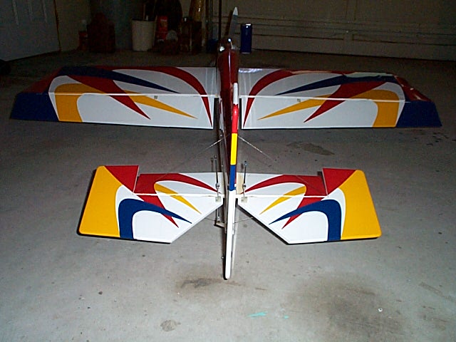

Hey CeeGee.. No I just thought you had a Computer radio since you
you were talking about expo's, And I saw the linkage as it was on the
Elev. on your pic.. I guess it's no problem.. But it's hard to tell from
the pics, but looks like the pushrod will touch the stab, in the full down
position.. But that's the advantage of having an instructor:-) Lots of
tips and help!!... On the pushrods... I was just wondering if my used
plane had the stock rods or not, I guess not, They look like 440 to me,
and since you had a new UCD I thought I'd just ask.. I took a pic, let
me know if it's the same... Well you have a great time with your UCD
and remember... Practice... Practice... Then more Practice:-) Have fun
and be safe!!
and be safe!!
