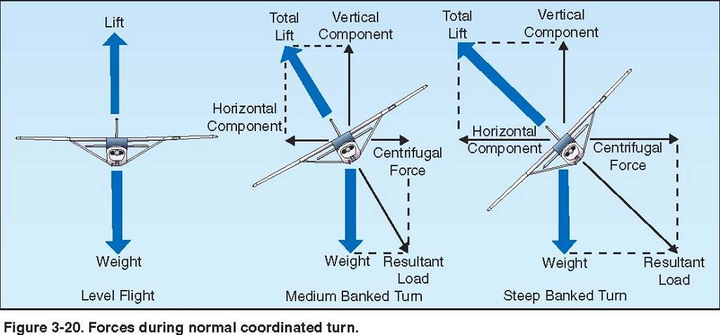

Below is a drawing such as the one Hossfly is talking about....have a good look at it.
Now I am going to pick on poor Top_Gunn for a bit (sorry Top) (<u>NOTE: For the following, it is important to remember, the WEIGHT of the airplane does not change....fuel burn during a simple turn is negligible)</u>.
This is not totally correct. While there is a sideways "push" do to the banked wing, which you can see in the drawing below, the tail surfaces, in particular the vertical fin, causes the airplane to turn when it trys to fly "sideays". You do not need elevator to convert that "push" into a turn, the design of the airplane tail will do it by itself. On many aircraft a touch or rudder is needed to help it turn, but that is usually do to adverse yaw...a whole seperate turning issue. In actual practice, the elevator is used to keep the nose up and prevent altitude loss, not to "turn" the airplane.
In your example of tightening the turn to stay on front of the flightline, simply adding elevator as you say is also going to cause a broken airplane. In a steady turn at a set bank angle, adding elevator will cause the aircraft to pitch up...NOT turn tighter, and may lead to a stall. In reality, if you want to turn tighter, you need to increase bank angle. Of course, the increase in bank angle will require more elevator as well, but again, it is to keep the aircraft from losing altitude, and not to turn. We will see why in my next point.
While these are both correct statements, you are missing an important statement there, the "increase the lift" part. Lets look at why that is important.
Now, go and have another look at the diagram. You will see that when the airplane is straight and level, the lift equals the weight. Alsonote that the lift is always perpendicular to the wings. But, when the airplane is put into a bank, the lift vector tilts to the same angle as the bank angle. Now, the lift vector can be split into two vectors, one vertical and one horizontal. The vertical one is what is opposing the weight of the aircraft, and the horizontal one is what is giving that "sideways push" discussed earlier. Here is the issue though:
Because the total lift is "split" between the two vectors, the vertical lift vector is reduced. That means that the weight now exceeds the amount of lift holding the airplane up, remember, the weight doesn't change. In order to get that lift back, we need to increase either airspeed or angle of attack. Increasing angle of attack is the most practical, especially in full size aircraft that do not have gobs of extra power. So, we increase angle ofattack, and the way to do that is to pull back on the stick (up elevator). This increases the <u>total</u> lift vector, which allows the vertical component to again equal the weight. Now, looking at that diagram again, you can see how in a set angle of bank, simply applying up elevator will cause the airplane to climb. There will be a small increase in the horizontal component too, but in a "normal" turn, not enough to even notice the increase in turn radius.
BUT, look what happens if we steepen the bank further. Now, the <u>total</u> lift vector is still being split, but the steeper the bank, the more of the lift is given to the horizontal vector. This will cause a tighter turn. (Remember, the tail area will cause the airplane to "yaw" when that horizontal lift "pushes" us sideway, thus turning the airplane.) So, now we havea large portion of our lift going to the horizontal vector and less to the vertical vector, now the airplane really wants to drop, so we need to increase the <u>total</u> lift a lot more. So, to do this we need to pull back some more to increase the angle of attack enough to increase the total lift to increase the vertical component to keep us up in the sky. Whew, lots going on here isn't there.
So, as we can see, the more we increase the bank, the quicker we will turn. But at the same time, the faster we will drop unless we pull back more to mainain enough lift to hold the airplane up. We can also visualise that for a set bank angle, and a set airspeed, there will be a set angle of attack that the wings need in order to produce enough lift to hold the airplane up while some of the lift is being "stolen" to turn the airplane. There will come a point where the elevator will become the primary "turning" control, but not until a nearly vertical bank. Until then, we still need to hold the airpalne in the air, and that is the job of the wings. They need to continue to produce enough "vertical" lift to overcome the weight.

Now, can Ipick on GarryHarris? (Sorry Gary
Your test will not really tell you to much. Both wings being equal chord, they will fly so close to the same that you will not be able to discern the difference. If anything, there will be a small increase in <u>drag</u> on the aileron equipped wing due to the gap, but that is about it.
If you would really like to see the difference in the lift made by the ailerons, just build one wing. Build it with the ailerons and go fly it. Fly it a few times to get used to the way it flies, and then cut the ailerons off, and go fly it again. That will tell you what difference the ailoerons make.
Now if you build two wings, one with ailerons, and another without ailerons , but of equal wing chord, I don't see how having ailerons would create any more lift than the wing built with ailerons. So I'm still saying no.

I don't really disagree with any of your argument, but you're leaving things out. When you increase the angle of attack of a plane that's banked, some of the increase keeps you from dropping and some of it makes you turn tighter because, as you say, the lift vector is not vertical. If you are banked 45 degrees, which isn't unusual for a model, about half the angle of attack increase contributes to the the turn. If you're banked 85 degrees, most of it does.
This increases the total lift vector, which allows the vertical component to again equal the weight. Now, looking at that diagram again, you can see how in a set angle of bank, simply applying up elevator will cause the airplane to climb. <span style=''color: #ff0000''>There will be a small increase in the horizontal component too, but in a ''normal'' turn, not enough to even notice the increase in turn radius.
</span>BUT, look what happens if we steepen the bank further. Now, the total lift vector is still being split, but the <span style=''color: #ff0000''>steeper the bank, the more of the lift is given to the horizontal vector. This will cause a tighter turn</span>. (Remember, the tail area will cause the airplane to ''yaw'' when that horizontal lift ''pushes'' us sideway, thus turning the airplane.) <span style=''color: #ff0000''>So, now we have a large portion of our lift going to the horizontal vector and less to the vertical vector</span>, now the airplane really wants to drop, so we need to increase the total lift a lot more. So, to do this we need to pull back some more to increase the angle of attack enough to increase the total lift to increase the vertical component to keep us up in the sky. Whew, lots going on here isn't there.
Anyhow, I totally aggree with what you are saying in regards to beginners, especially the bit about not such steep banks!! Personally, I don't teach to pull up to turn tighter, simply because at the early stage when this is even a problem, most students can not run the throttle and turn and everything at the same time, so the risk of stalling if they pull to hard is greater. For the same reasons they turn too steep, they also pull too hard. I gotta admit, I have never had the ''split S'' problem happen to me with a beginner though, but I can see it happening.
