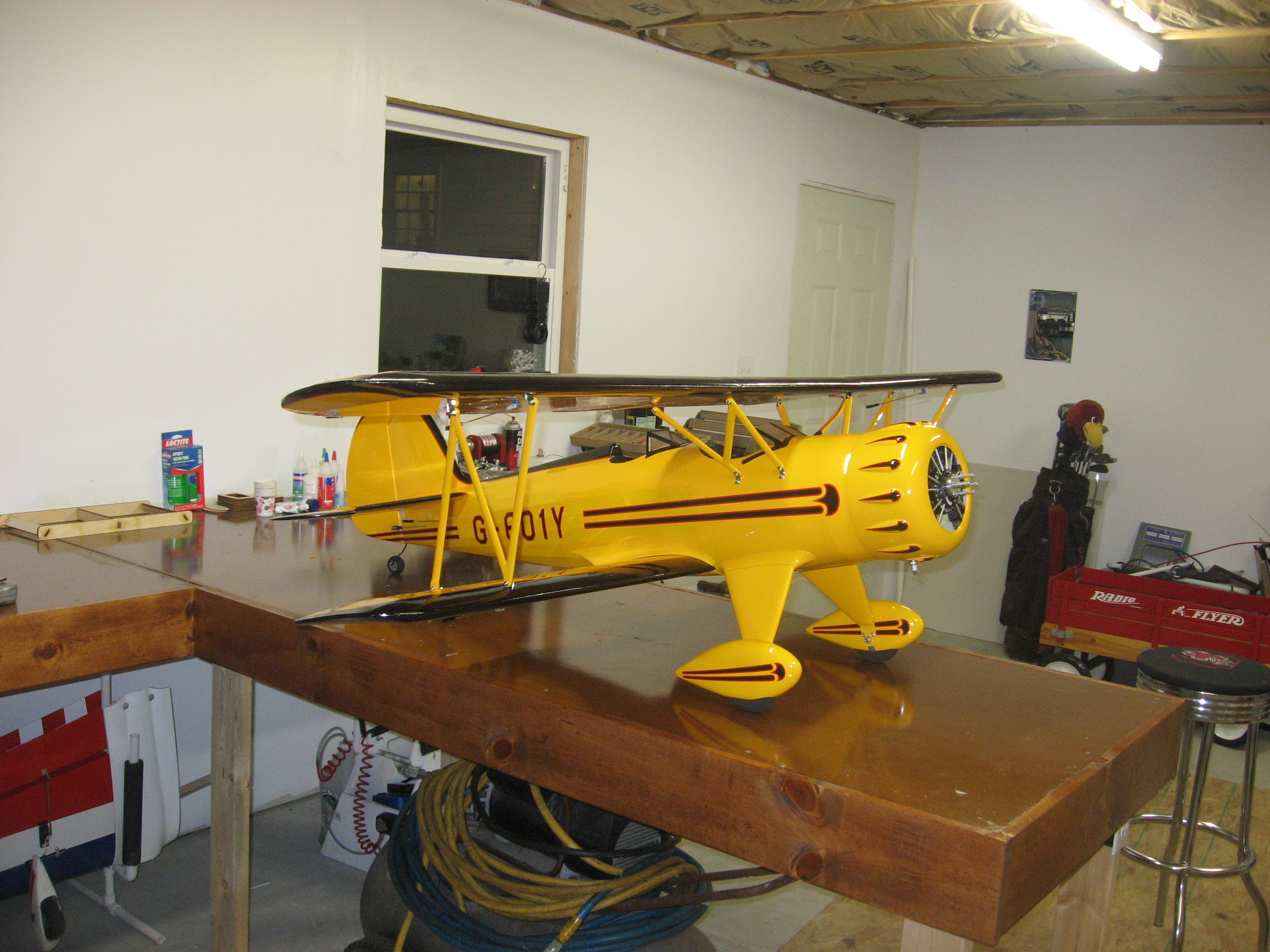

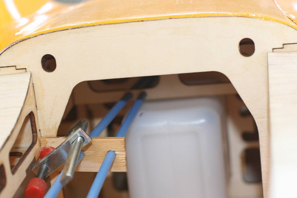

Just a few pictures of my Waco build. Using a DLE 20 with stock muffler and changed out the tail wheel. Also installed a servo for the choke.Have a broken turtle deck fairing due to shipping damage. Do not know when they will be able to replace it. Maybe not till May.

Hellcat, Excellent install, but are you aware that the area under your tailwheel screws is all balsa ? Even soaking that part with thin CA may not hold up from repeated landings and strain. Can you tell us if this area has been re-worked with a Basewood plate implant and epoxied ? I'm not trying to be rude, I simply care enough about your plane not to see any possible problem. If you have re-inforced it, great. Respectfully, MM

Well guys mine is done and here are some pics of it. I am waiting on a muffler from Jtech and props from Valleyview. Hoping for a maiden next weekend. Have to balance when the muffler and props are installed but she is a little behind the cg at the moment.

The tailwheel is installed with a hardwood plate and yellow nyrod for the screws soaked with thin ca. Should be strong enough.

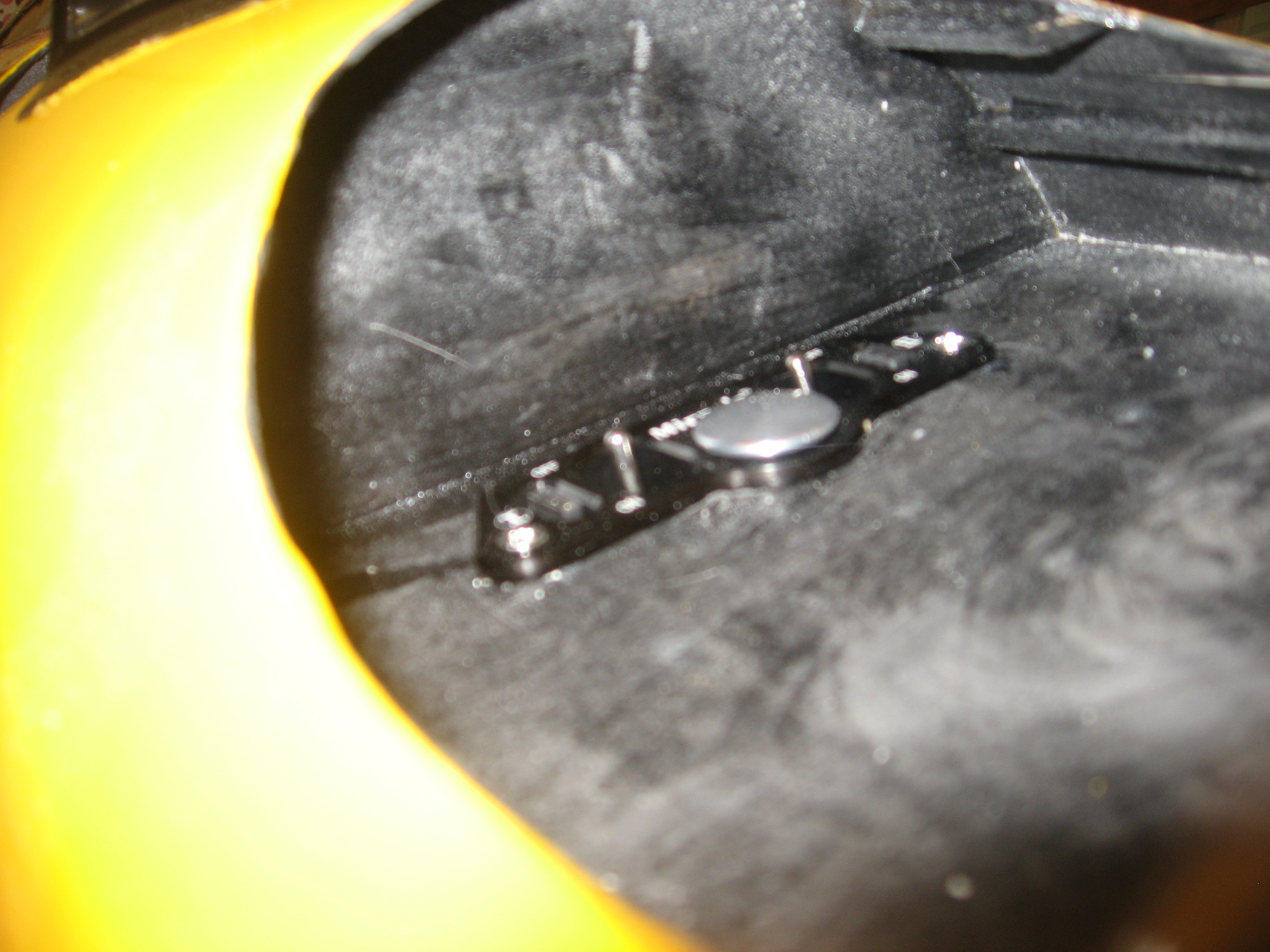

Look'n good. My DL-30 should arrive on Mon. along with a Jtec Pitts muffler. I have the same "Miracle" switch/fueler set as yours and installed it in the same location as you did. What fuel line did you use. I've got Tygone on my Giant Sun Dancer but have to change it out about once a year as it gets stiff. I may use the black neoprene tubing this time. ACF
