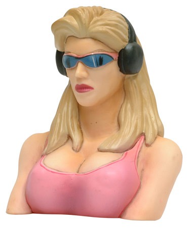

Should I show you who my pilot is gonna be?
