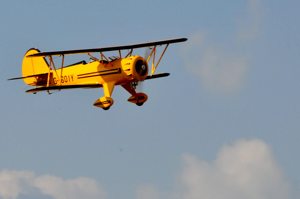

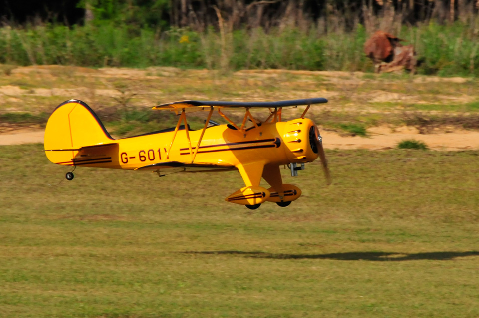

Guys what size pilots are yall finding that works good?? Any Ideas on where to get some good ones? I have got the hang of flying this plane and want to finish her out with a pilot and a scarf!!

ORIGINAL: skillet92
Well, for starters, your plane would be 1/5th scale, if it were scale.
Bill, Waco Brother #1

Go to Ace of Iron pilots. I used the 1/5" scale WWI pilot.

Thanks guys!! P51, Great site! They also have a nice looking Pilot for my Corsair that I just finished!!!
