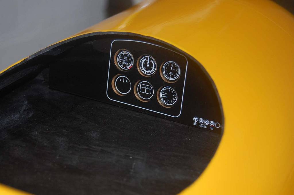

I'm chugg'n along with my WACO, but discovered a problem. I went to peel off the larger instrument decal to place on the solid lite ply panel and the black part released but the darn instruments stayed behind. No way to remove them with destroying them. Looks like the die cut went too far through the sheet. Anyone else have this problem? Luckely I had some Jtec scale instrument sheets and was able to use those so all is not lost. I also painted in inside edges of the instrument cutouts with brass paint then sandwiched them together. Have my dummy engine finished, just need to do the air flow cut-out. ACF

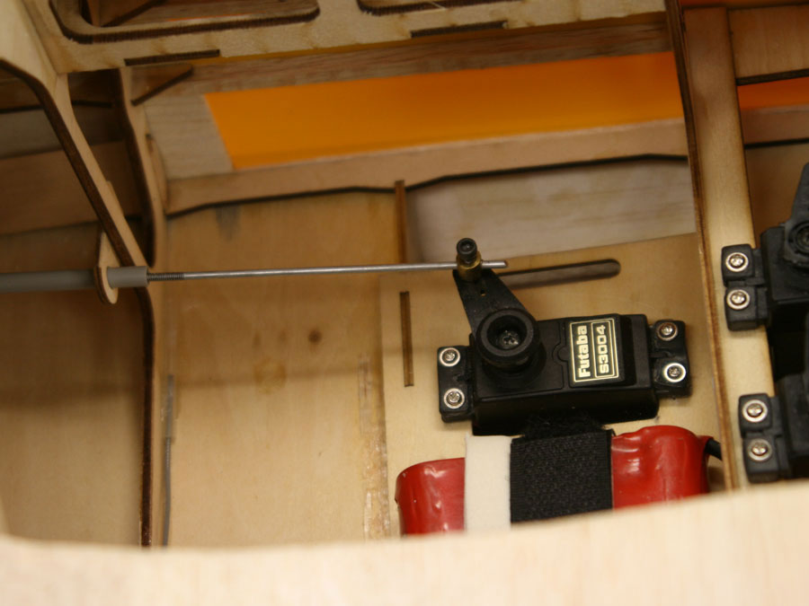

Here is the installation I'm using: I lengthened the throttle arm with a DuBro servo horn. I don't know if it's really necessary, but I wanted a little more clearence for the choak pushrod.
I cut about half of the threads from a pushrod, screwed a nylon ball cup onto it and bent the wire as shown to clear the tank.
Then I mounted the servo to the receiver mount (You'll need to cut the servo opening and add doublers to the bottom for the screws). This worked out great as it's now a straight line and you don't have to snake the pushrod all over the place.

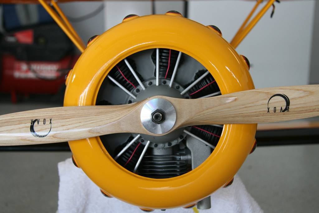

Installed the DLE 20 with the stock muffler. Using a Xoar 17x6 prop. A few pictures of the installation with the dummy radial. What a pain to install. I could not get the recommended procedure to work for installing the cowl. Used my own method and came out nice. The vent line has not been secured yet, that is why it is hanging out of the cowl.

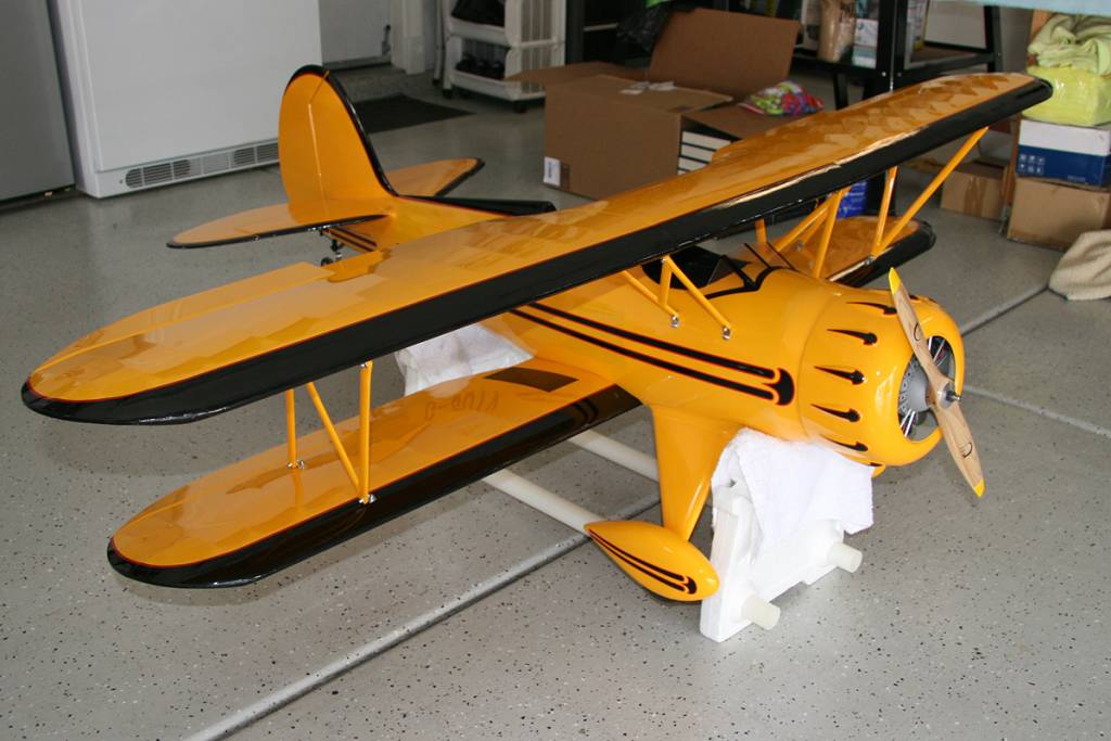

Jusr finished up the Waco today. It weighs 12 lbs 13 ounces with the DLE 20. Turns a Xoar 17x6 prop 8200 RPM and idles at 1700. Hope to maiden in the next few days.
