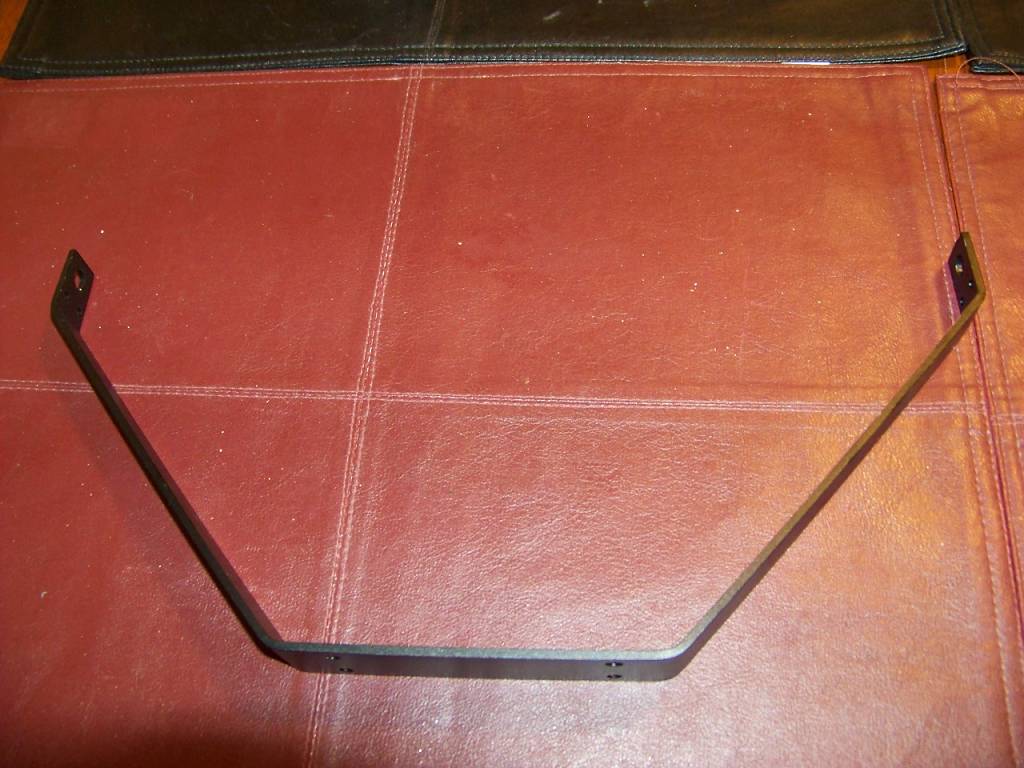

Now I couldn't resist taking everything out. The frist thing I noticed was there were no wrinkles in the covering

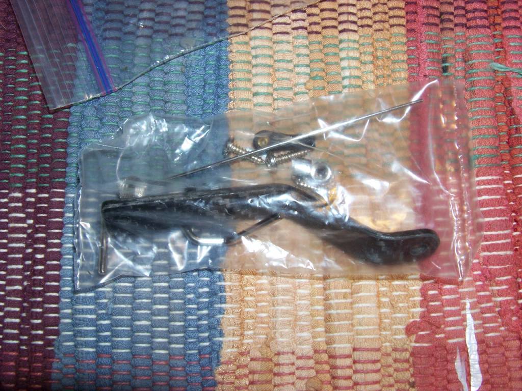

The pull pull cables for the rudder are already installed.
This plane comes with a carbon fiber wing tube for extra strength. It also comes with a carbon fiber tailwheel assembly for strenght and light weight and a aluminum landing gear.
It even comes with allen wrenches.
I was also suprized to see a glow motor mount included.

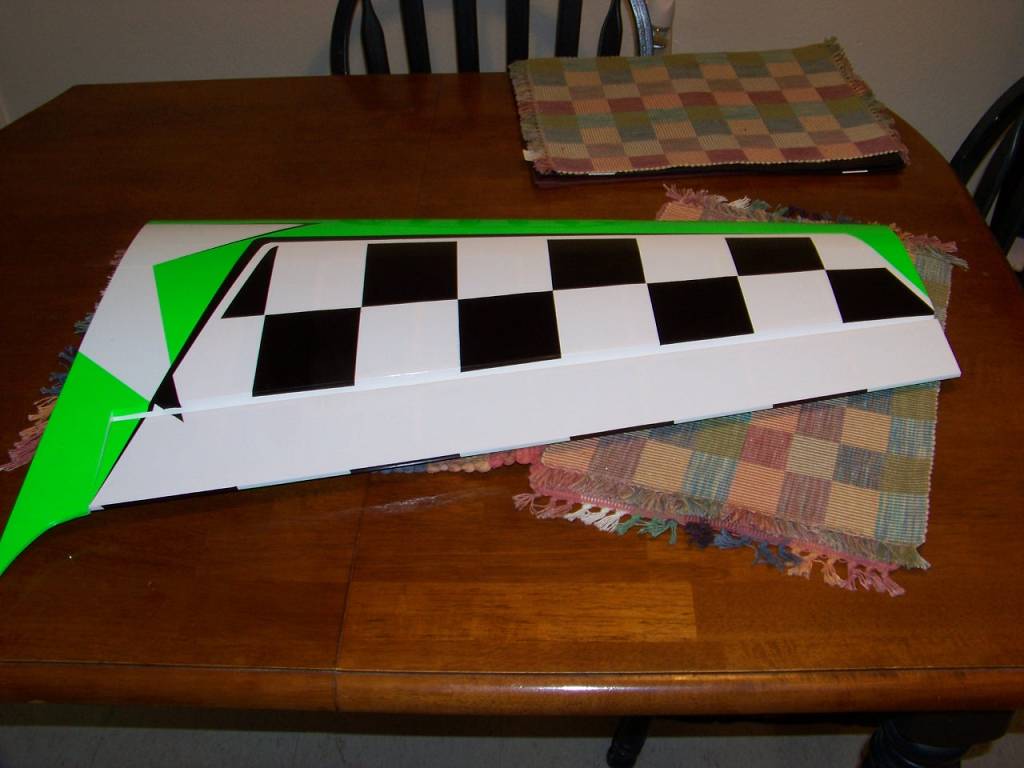

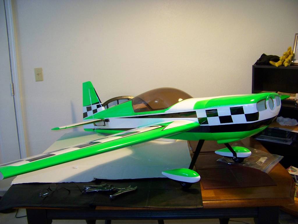

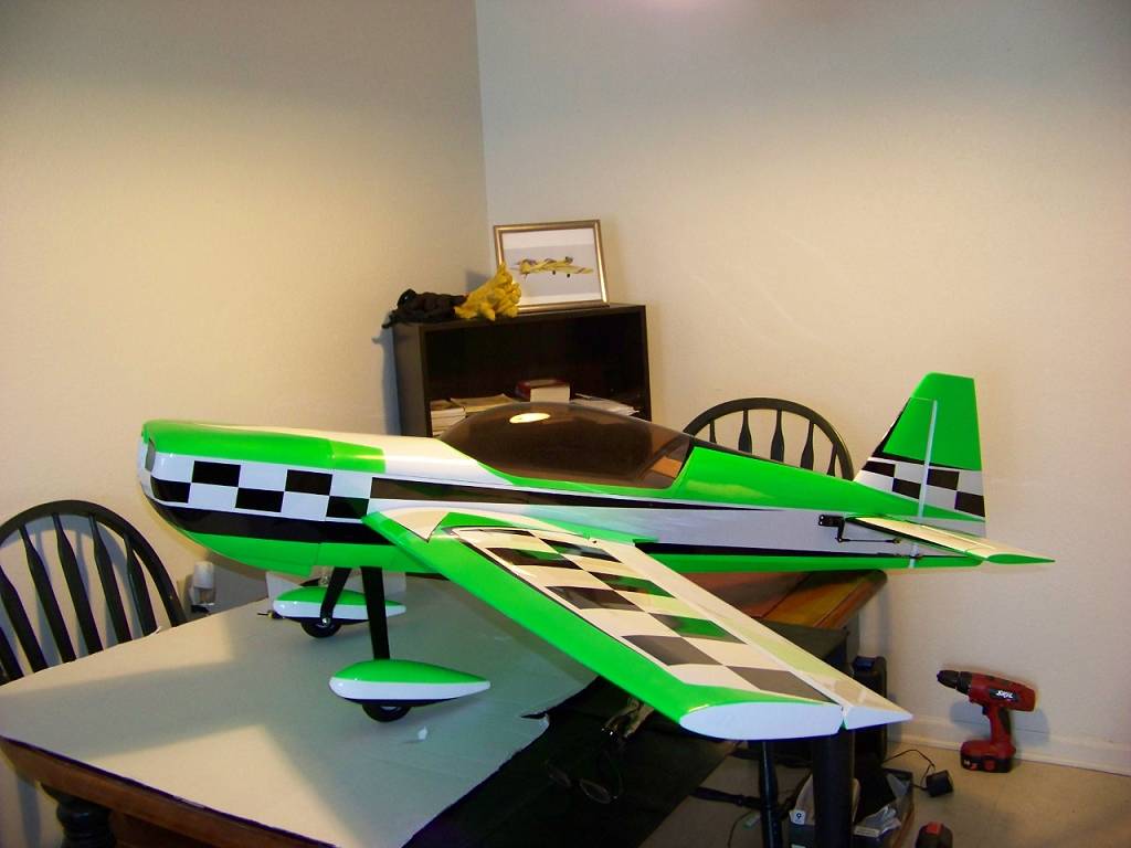

She really brightens up the room when you put the wings on her.
As I was assembling her I noticed that I can use either a single servo, or dual for the elevators.

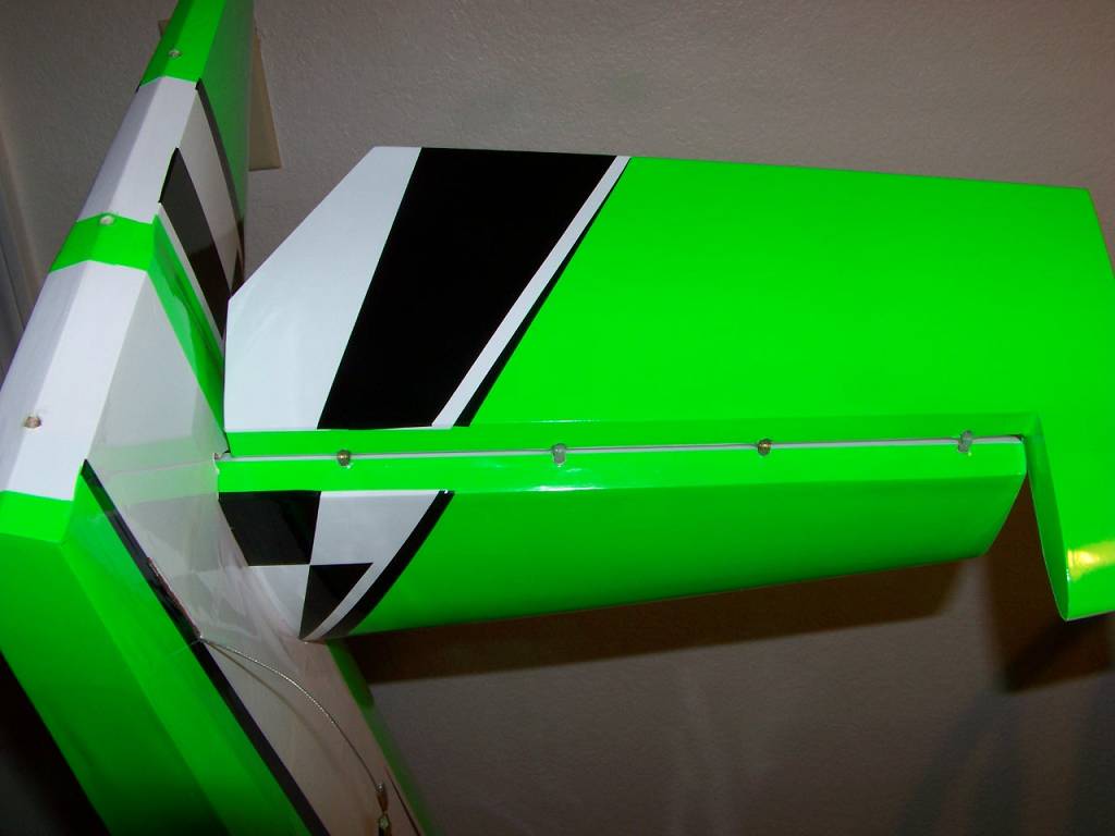

I started my build and have made alot of progress along with a few mistakes.
I of course welcome any input and pictures or video's.
I started by applying vasoline to my hinge pins and and wetting a couple of paper towels with acohol to wipe any excess epoxy. I use one for wiping down the the part after I've finished it I keep it really wet
I then mixed up the 5 min epoxy and coat the predrilled hinge holes in the rudder and one end of the hinge. Carefully putting the hinge in the hole I would remove the excess epoxy with a tooth pick.
Once all the hinges were in the rudder I put it on the vertical stab and worked the rudder back and forth to center the hinges. I then very carefully removed the rudder. Wiping it down removeing any epoxy and fingerprints.

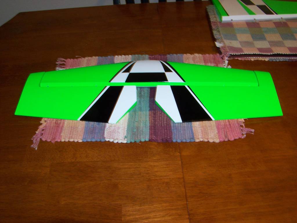

I did the same thing to each elev half

next i put the horizonal stab in the fuse and centered it up. I then took a sharpie and drew a line on both the top and bottom of the stab. Now where the line was there was 3 layers of covering and I went through 2 blades cutting the covering being careful not to cut itno the wood.
then making sure I had plenty of acohol wetted paper towel I slide the stab in just off cented and applied epoxy on the top and bottom of the long side.
I then pushed the stab off center on the other side and applied epoxy. I then slide the stab back to center all the while wiping an epoxy off.
Now when I cented my stab I pulled a line from just at the back of each side of the canopy to the leading edges of the H stab.

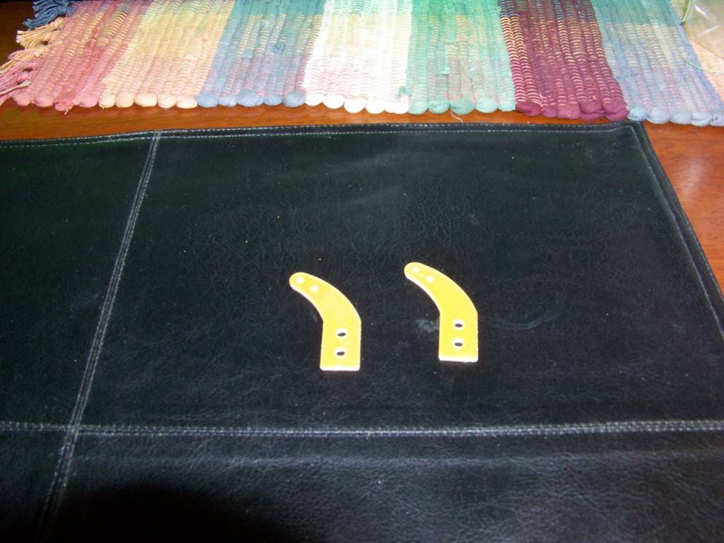

Next was the the surfaces control horns. I started by sanding the control horns and cutting out the slots on the surfaces. Now on the ail this was no problem but when it came to the elev's and rudder there is 3 layers of covering and those slots are hard to find. I ask them in the redwing MX thread where the slots were at but I was wanting to do that job so I lifted the covering and cut the slots out. then On a low temp I resealed the covering.
I then installed the ball links on the control horns and epoxied them in place.
No on the rudder control horns I had to sand the back of them to make them a little rounded so as they would go into the slots. I glued my rudder control horns the same way I glued my H stab. But after it dried I noticed it was 3 mm off center.
I put an old blade in my excto knife and using a lighter I heated the blade and after little time I was able to get the horns loose. I then reglued them this time getting them centered

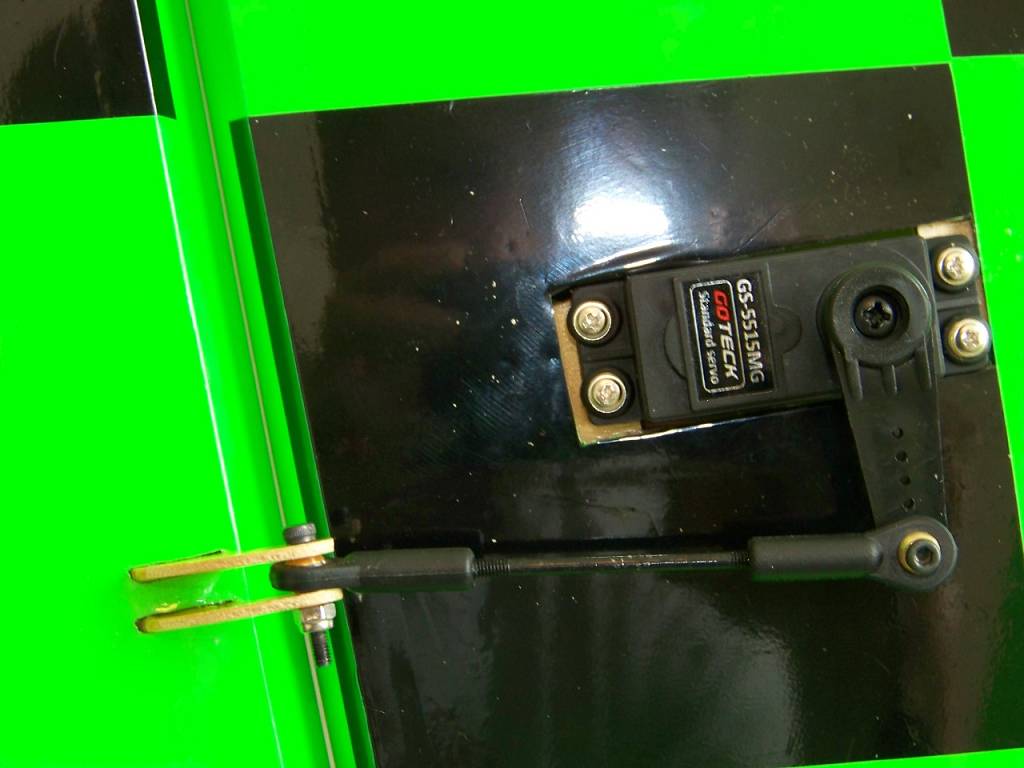

Next I Installed the ail servo's. I went with GMP's GOTECK GS 5515's http://www.giantmodelproducts.com/in...t34o4ffrng3ot5
I then assemble the servo control horns to the supplied control arms and adjusted the linkage.
I found that I had to cut my End point adjustment on my 9C was back so I elected to use the GOTECK sevro arms and I was able to use 100 percent on the EPA of my 9c then
I found that even though my ball links were stiff the GOTECK's had no problems centering

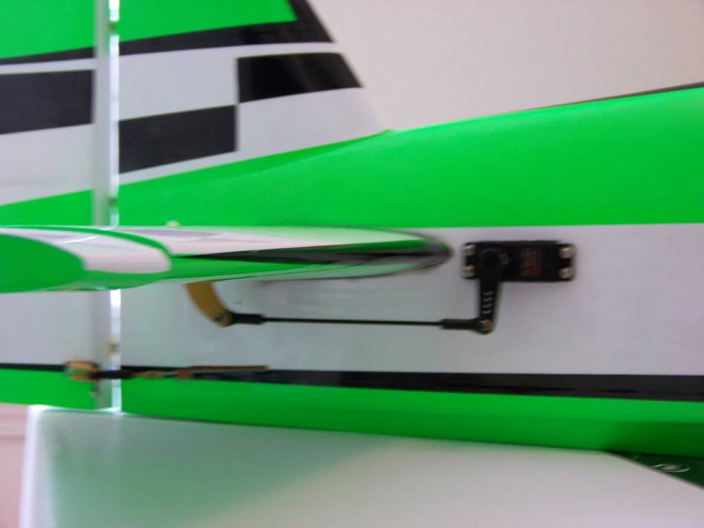

Now when I put the elev servo's in I had a bit of a problem drilling the holes for the servo's because I should of drilled them before I put the stab in.
I used GOTECK 5511's on the elev halves and once again they had perfect centering.
I also used GOTECK's supplied servo horn's saving some weight, yet still getting full deflection. these servo's also have great centering.
I elected to use the dual servo's option. It was really easy to set up with my Futaba 9C. I used the AILEVATOR function on the 2nd screen that uses channel 2 and 8

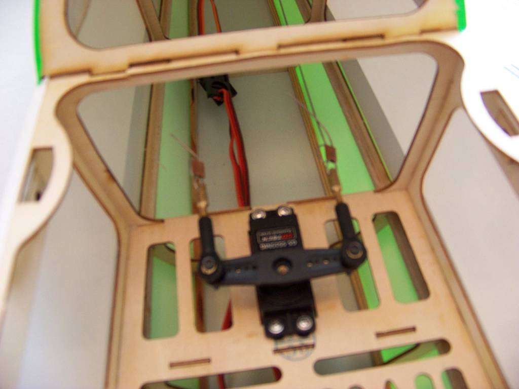

I went with the GS 5515 on the rudder also along with using it's control horn instead of the GW servo control horn. I still had to cut my EPA back to 90 percent. I put the ball link on the rudder horn and tighten each cable and then ran another loop through the crimp tube before crimping. now my rudder is working perfect.
These GOTECK servo's are high voltage servos that can run on 7.2 volts

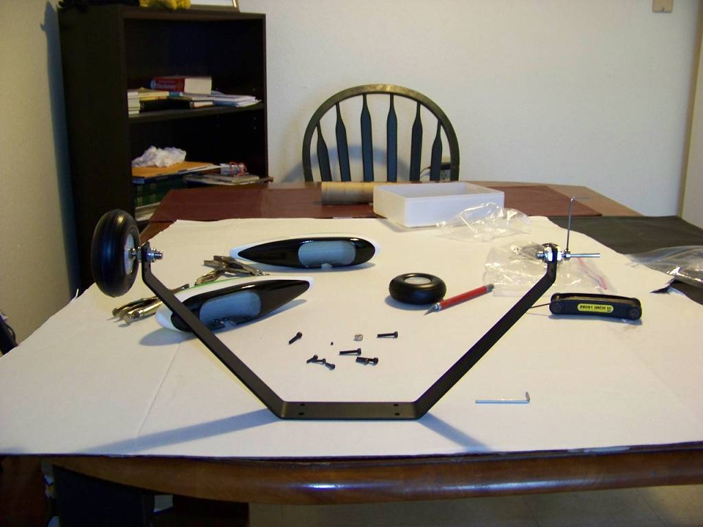

I worked on my landing gear though it was so simple as most of the work is already done.
I started by bolting the axles to the gear.
Next I put the 1st wheel collar on the axle leaving just enough space to be able to slide the wheel pant on. I also put the set screw poing down.
Then I put the wheels on. The wheel fit really well. not to tight or to loose. of course next was the outer wheel collar and once again with the set screw pointing down for easy access.
It was only a matter of bolting the wheel pants on an the job is done
