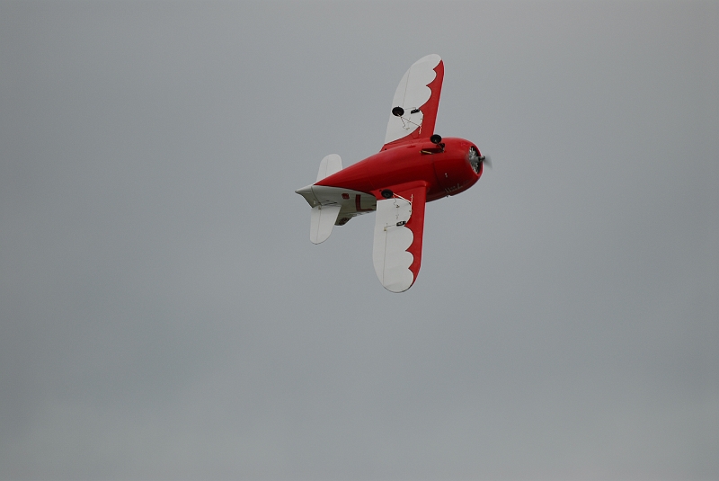

#316
My Feedback: (10)
Joined: Aug 2004
Posts: 284
From: Rittman,
OH
unfortunatly not of the landing mishap. I have a few minutes of some flying. It was getting dark and the auto focus on the camera was going nutts. I have a good friend that is going to help go through the wing and we may rebuild it, and hopefully make it better than it was. I would recomend to anyone getting this plane to peel the covering and strengthen the wing.
