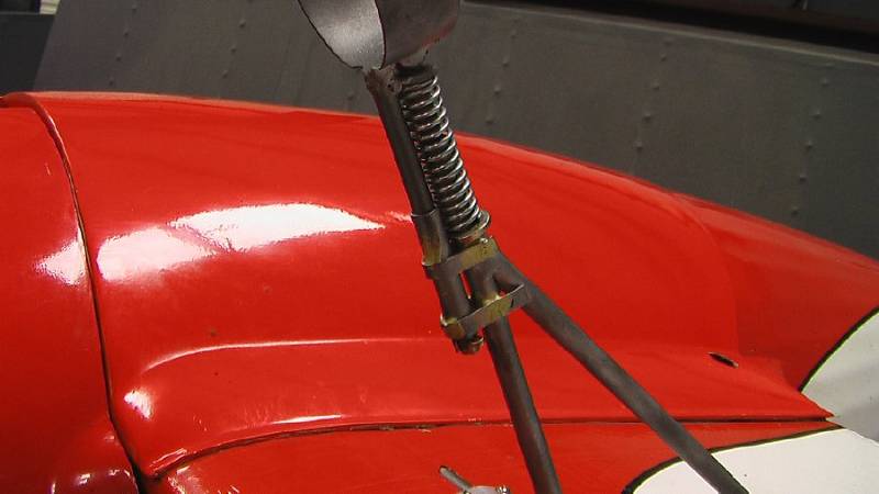

I found the instructions online on the Robart website. Basically you have to disassemble them, mount them on the wing, mount the spats, then reassemble them.
http://www.robart.com/RoboStruts/dra...tions%20BW.pdf

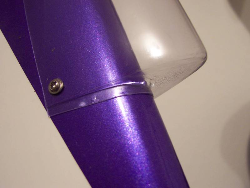

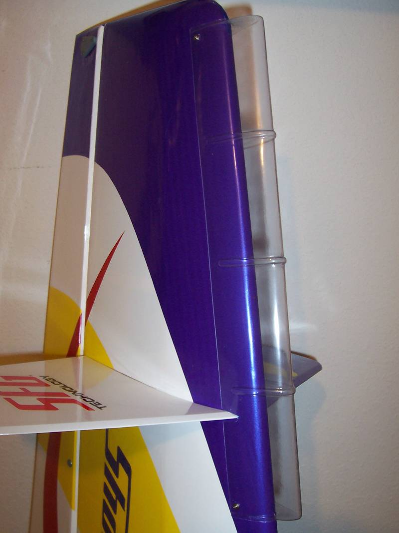

Place some Training Droops on the leading edge of the wings!!!
Guys have had wonderfull results with these on there H9 Showtime!.....
Clear, and probly wouldn't even see them! I bet it would help the landings HUGELY!!!
It is worth a try!!!!!!!!!!!!
