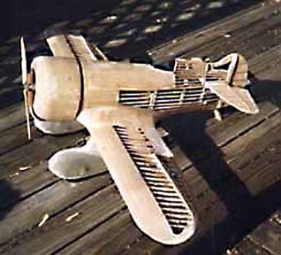

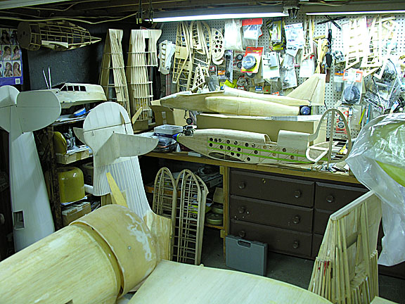

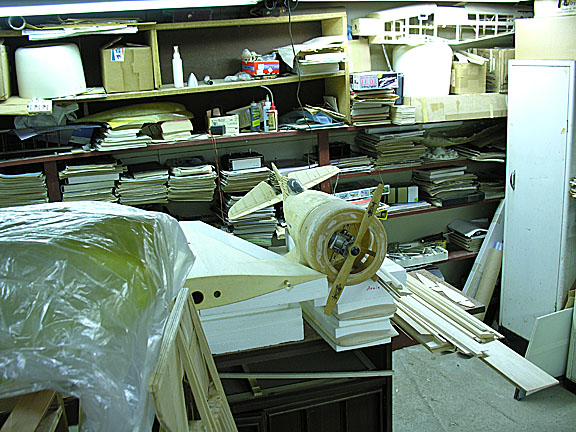

My Gee Bee's. Notice none are done except one that did a cartwheel. That one is in repair.
Charles

You are the king of framed up Gee Bee's !!!

Hey avaiojet what plan and span is that gee bee z model?

Pencon,
Which one?
In the photos are 33% Don Neill Gee Bee Z's. These span 90". I framed one up, covered, from his plans years ago. The other, standing on end and striped of covering, is one I'm repairing. It actually flew. I traded a couple of NIB Rossi engines for it.
There's two 25% fuselages part framed.
The bottom photo is a Adrian Page kit I bashed. This model is 1/5 scale and actually has "close to scale" outlines. Span is 58". I have an OS 80 2S in in for the benifet of the larger prop.
I may still have drawings of the fuselage and wing changes someplace. These would be the changes to Page's plans. I made the glass cowning and the spats can be purchased. At least back then, this was years ago also.
Everything I have seems to be years ago?
Great kit BTW even without changes.

A 25% Z would be 72" in span. I have two fuselages, of this size model, partically framed. See photo. Plans are from Henry Haffke, and are available but don't know from who?
I picked up a copied set.

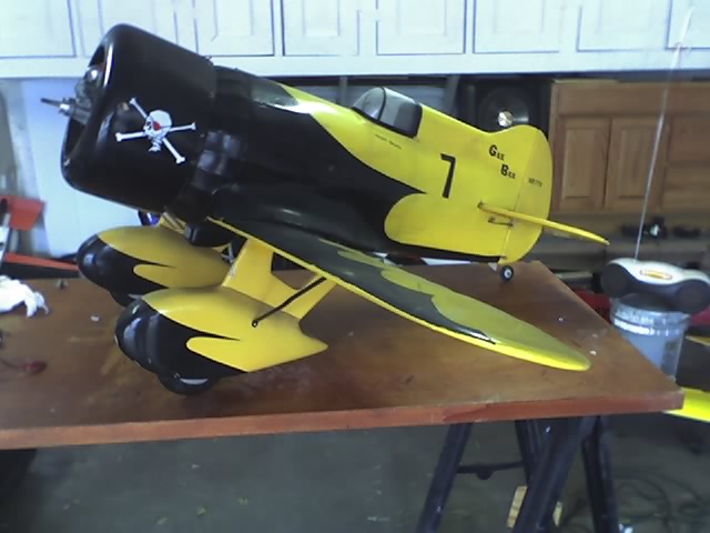

Here is my Hafke 72" that I picked up. Needs to be completely recovered and gone over structurally as well. I have a great planes that I fly regularly.
Working my way up to it.

How much did the hafke 72" end up weighing? What scale is that plan? I thought the z was a little longer than the r2 , that photo makes it look just as stubby. Is it easier to land than the r2 or about the same?
