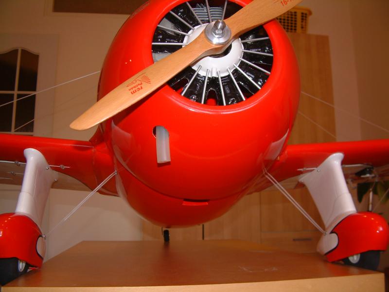

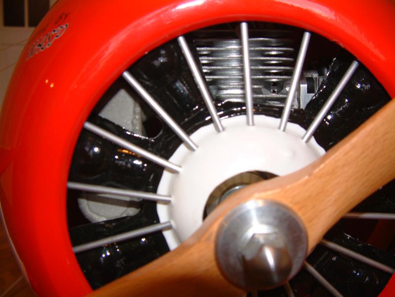

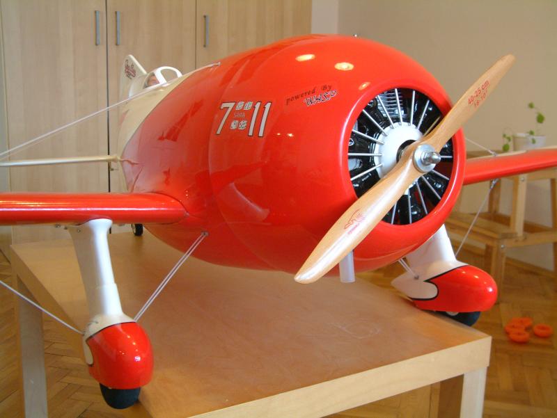

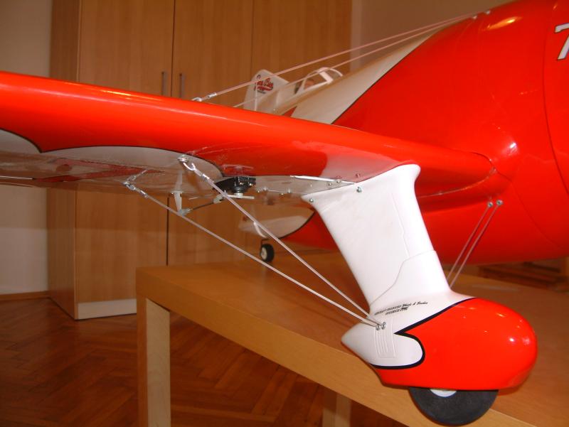

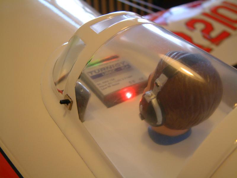

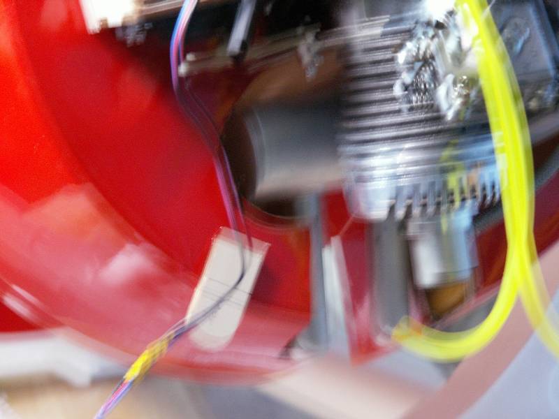

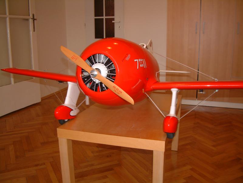

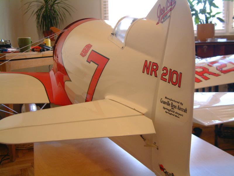

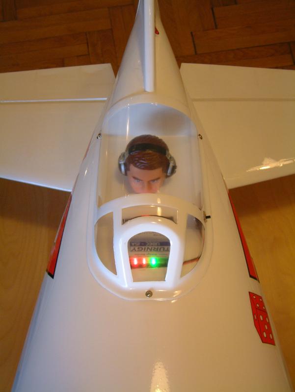

Old 02-27-2009 | 07:55 AM
  #615
Joined: May 2006
Posts: 22
From: Prague, CZECH REPUBLIC
Default RE: GP GEE BEE
My Gee Bee is just finished.
I use a FTL 26cc Gas Engine.
Weight is 5430g
Wing load is 113g/dm2
Radio Futaba 7C 2,4GHz
1x lipoly 2S 2100mAh + TURNIGY 8-15A UBEC
I use one battery for ignition and Rx at the same time (I have red several forums about this setup and my conclusion is it should be ok with 2,4GHz. I am going to test it on ground first.)
I wait for a better weather now to run in the engine, then I'll try to fly the fat girl and land again.
Does anybody fly this beauty with a gas engine?

Old 02-27-2009 | 01:25 PM
  #616
Posts: 7,816
Received 10 Likes on 10 Posts
From: Upplands Vasby, SWEDEN
Hi!
That is 500g (0.5kg )more than mine...
Good luck with your landings!

Old 03-01-2009 | 02:56 AM
  #619
Joined: May 2006
Posts: 22
Hi Rev,
Yes, you just pull the flying wires and release. The wires are joined with an elastic, it is hidden in the fuselage, so it is not a problem to pull and release.
Sorry for your first GeeBee. It is a really pitty when you loose your plane because of such a problem.
Did you use with your previous GeeBee a glow engine or a gaser?
I am curious what would be your weight with a MVVS.
I would say 5430g is an average weight or slightly more then average. Still it is 239g lighter then the geebee in the RCuniverse review using a 120FS. So I believe I have a good chance to handle mine.
