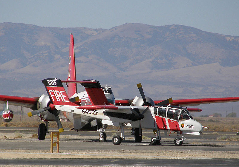

I live in Australia and was a Police Pilot for many years, in planning security for the 2000 Olympics I was the Aviation Security Project Officer, I was in contact with the California Department of Forestry. We almost had a deal with them to borrow 2 OV10's as our Police Patrol aircraft. I had studied the flight manual for weeks in anticipation of an endorsement.
The idea was canned by the Australian Government who didn't want US Military planes flying over the Sydney "Friendly Skies"

Rob, both of my Broncos are in the same scheme as the first pic you posted.
