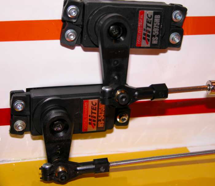

From: Las Vegas, NV
Default RE: Elevator/Rudder Servo Arms
I tried turning the rudder servo around and the linkages still hit. I just cut off some of the arm and I think I have enough for the high and low recommended throws but I'd have to do something completely different if i wanted 3D throws. I'll start off on low rates, progressivelly move to high rates and if I think the thing will 3D, then and only then will I do something to change the setup. Thanks for the suggestion.
I turned my elevator servos around. I have just enough clearance for the medium size servo arms that come with the Hitec HS-5475s. It is also the same size as the heavy-duty arms you can get from Dubro.
Old 03-11-2004 | 11:26 AM
  #211
Posts: 1,346
From: Hampton Cove, AL
Jim, nice clean solid and secure set-up. Glad you got this one worked out. Did a nice job. Those socket head screws sure are nice to work with, aren't they.
