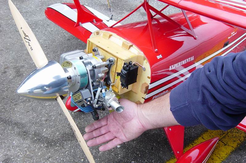

I had a Fuji 50 in a Pitts and did use the short hub extender that comes with the 64. Fit perfectly so I had about 1/8 " clearance between the cowling and the spinner. The CE measurements are most likely a bit different that the Pitts, but the short shaft is an option. If you use the 64 hub extender make sure you also get the prop bolt. The threads are different between the 50 and the 64 hub extenders. Fuji may have resolved this by now, but this is what I had to do to get mine to work. Pictures are of Pitts-1 with the Fuji engine. Like NavyE6FE said, this engine flew the plane just fine. I lost it in a bad crash and putt a DA 50 in Pitts-II. The DA vibrates a bit more than the Fuji. Guess the big flywheel on the nose of the Fuji helps with this.

Jim, you should be able to find a good bit of info on this engine. You mention that you have the SA model. This is the first model if I'm not mistaken. If so, I had the same engine in Pitts-I with good success. The engine flew my Pitts very well. In fact, it had less vibration than the DA 50 I have in Pitt's-II. The only thing I experienced with this engine that I had trouble with was that it was difficult for me to flip start. I never got the hang of it. I used the Megatron two handled starter by Sullivan and that solved this issue 100%. Starter is a dream. I used the 24 volt configuration with two 12 volt batteries. Unbelievable starting power. I used a Pro Zinger 20X8 prop. Also used the stock spinner, but quickly found that the brackets failed with the starter. Too much torque for the brackets. I had the prop bolt drilled and threaded so I could use a True Turn spinner adapter. This solved the problem so I could use the stock spinner. I also had to cut the spinner for prop clearance. Would also recommend using a Zenoah velocity stack on the carb. Roger Yarrish did this in the MAN review on the Pitts with the Fuji 50. It does make choking the engine easier.

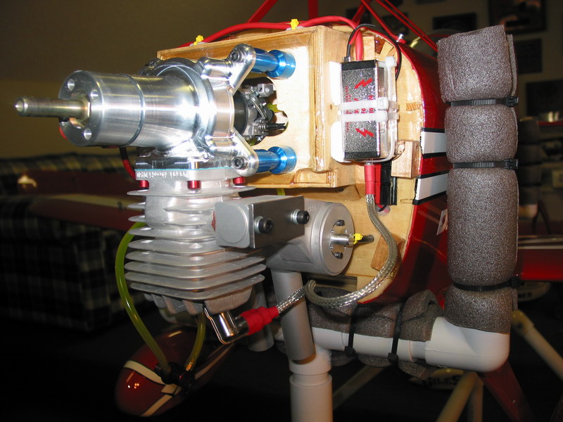

r180reef - Didn't when I had this airplane. I had second thoughts about doing this as well, and did much research on this and discussed with others. You probably already know this, but let me stress doing range checks with the engine running and off to be sure. I also had a Simple smoke system in This model and now in Pitts-II, As mentioned, I aligned the throttle servo with a choke servo in Pitts-II just behind the tank on a servo tray. Now the electronic ignition for the DA is on the box in the same location that I had the throttle servo on Pitts-I. Below is a picture.
Jim, correction on the above post about using a True Turn adapter. This was incorrect. Sorry about that. I had the prop bolt tapped and threaded so the above mentioned spinner bolt could thread right into the prop bolt. No adapter needed. Keep in mind, this was on the Pitts so on the CE the lengths may be a bit different. Please excuse my error on this. I thought about it after I went to bed last night and was think about this and realized I had made this mistake. Again, this solution really did work well in solving the spinner bracket issue with the stock spinner.
