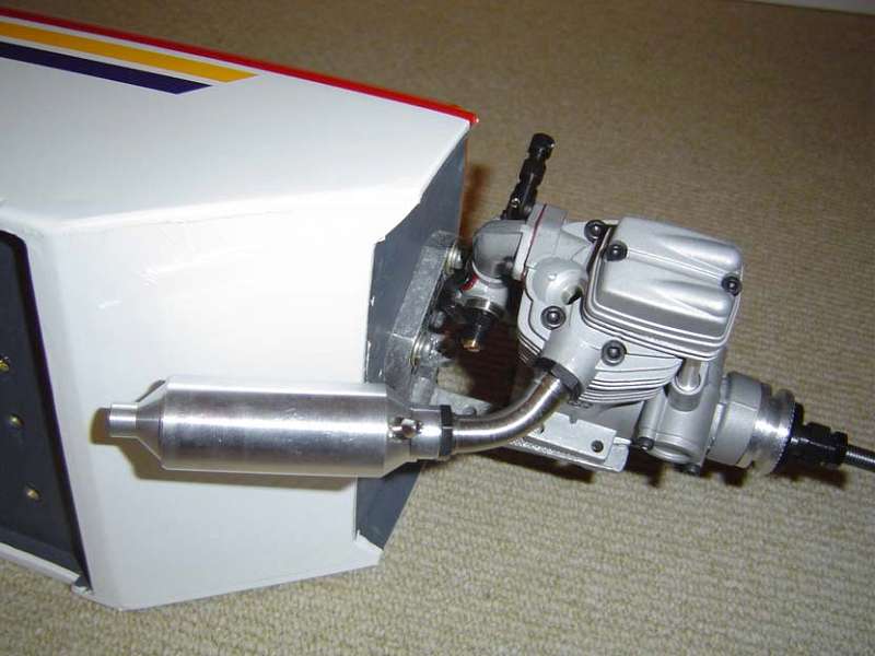

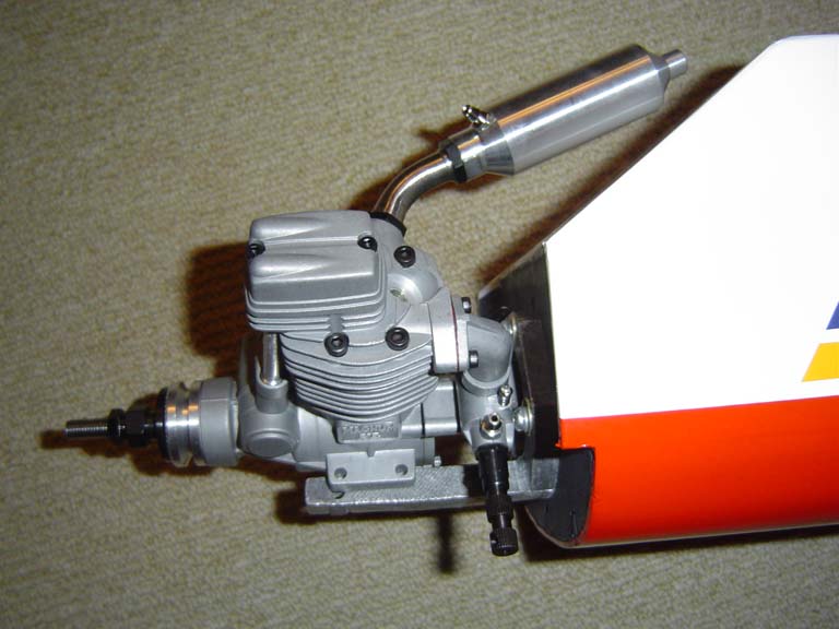

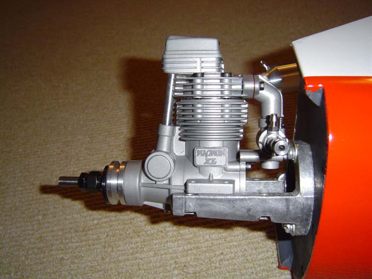

hey, i finally got the giles202 and the magnum 4stroke motor. However, when you sit the motor on the mount, the rear carby doesnt allow it to sit far enough back. The motor is too far off the edge of the mount. Does anyone have a solution?
I am thinking that either I
1) get a nylon mount to suit the magnum 61RFS and redrill the firewall to suit
2) buy a noisy 2 stroke!!
i really want to keep the idea of the 4 stroke happening though.
Anyone got a similar motor in their plane?

aeronaut,
did you have any problems with the mount? or did you just put a new mount on it?
do you have any photos?
thats a bit weird that it balanced right on... i mean, if the 4stroke is so much heavier than a 2stroke, im surprised that all you had to do was move the servos!
where did you store the Rx battery?
mike

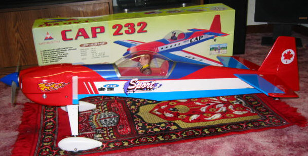

Ok guys...here she is. Worked hard and long on this one. This is one really nice built plane...the Phoenix Cap 232. I didn't use their stickers. Used all their hardware except the clevises....I just like metal. I didn't get to use the ASP .52 because the Silencer was too long. I used an OS .46 FX instead...fits nice in the cowl. I put the ASP .52 on my TT FUN TIGER EXTRA. We'll see how both flies this Spring.....about 4 feet of snow on the ground [:'(]
Well...here she is...

If you feel like a little work, you can save around 4 oz by removing the pilot. Believe me when I tell you they are heavy. That's one reason I could go with the OS 70II in my Sukhoi. Removing the pilot offset the added weight of the bigger engine. The pilots are solid and of the hard plastic variety.

Hi Aeronaut,
Thanks for the info about the pilot.....the cowl is sealed. I'll just fly it come spring, and if it needs more power, I'll consider the bigger engine. I'll try the ASP .52 with an OS 46 muffler and a bisson pitts style muffler. If either gives lots of power....I'll switch.
Oh....another thing....this plane came it with a weight of 5.5 lbs. That's pretty light for an OS .46 FX. My Dolphin weighs 6.2lbs and is really fast with the OS .46FX....and that's an aerobatic low-wing trainer.
Thanks again for all input.

Kaz, nice to hear that the weight came out at 5.5lbs.....considering the Sukhoi and Giles seem to be slightly heavier, and still fly great!
I wonder what's up with the different color red on the control surfaces though? Even still, the covering looks good...does it seem to be Ultracote like the Sukhoi and Giles?

I don't know their reasoning for having red ailerons....that's kewl though......it's covered in monocote all over. It tightened really good with a heat gun. It's stiff without sagging anywhere. I'll see how it holds up outside in the Spring.Phoenix has really improved a lot.....I can't believe the quality of this plane.
Hope you guys liked it......It wasn't hard work at all.....not even the cowl.

The only thing i deviated from on the plan was the CG. It specified 85-95mm (from memory) back from the leading edge. I think mine was about 15mm further back than that and I didnt think it would make much of a difference.
With the engine fired up, it took ages to get off the ground. Also when maintaining straight and level flight, it seemed to be "bobbing" and wobbling around the sky. Turning resulted in losing a lot of height and the plane seemed to struggle to regain altitude. I got as much speed up as possible and tried a loop - it snapped to the left! I had never had a plane do that before. What causes the snap? is it tip stall? warped flying surface? lack of airspeed?
Anyhow, landing was just ok but took more concentration than what I would have thought acceptable.
So now i have removed the Magnum. I am installing a OS46FX which i HOPE will be a little more responsive. Also, i weighed both motors and the OS is a little heavier than the Magnum - this should help with the CG. I am also relocating the battery to under the tank (I had to cut the film off the front just behind the firewall and will make a ply plate to screw in place. I am also moving the servos right to behind the tank. Incidentally, i bought a sullivan 8oz flexitank and it fits in PERFECTLY; not cutting or dremelling required.
I hope this will help the plane fly a little better - at least it couldnt be any worse!!
mike
all replies and suggestions gratefully received!
