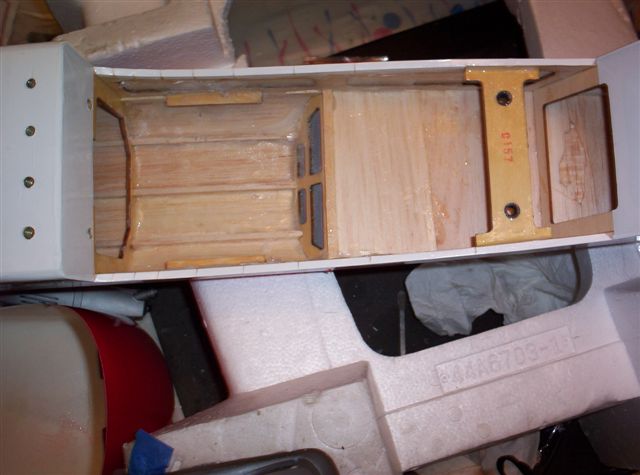

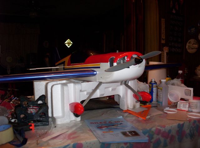

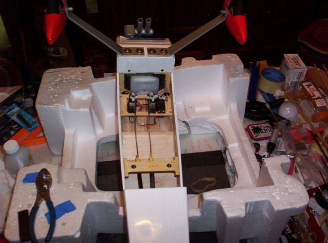

Thought I'd post some pics and explain what I've done so far after reading a few posts from others like yourself.
First thing I removed the plastic pilot. Not only does he look like a retard he weighs too much. (No offence to the mentally handicapped or the over-weight intended. I probably qualify for both.
Second I brushed a thin layer of 30-min epoxy from the cockpit panel to the firewall , laying fiberglass cloth in strips between every stringer and along the edges of the wing-mount area. While I was at it I epoxied the wing hold-down bracket and any other hot glued item I could find. Weighing the fuse before and after glassing showed that I gained less extra weight than that stupid pilot weighed in the first place. So I then tented the canopy black and threw the little pilot to my German Shepard who decided the plastic was too hard to mess with and buried it . Good boy !!!

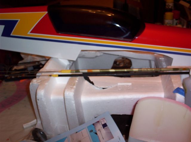

For the elev/rudder rods I decided to stay with the solid rod concept . The only problem here was that the supplied wooden rods both broke on me during assembly. Seems they had started drilling the little holes and realized they were measured too far back. Instead of starting with a fresh stick they opted to start a new hole and grooves from the ends. Not a good choice there Suzy.
I used a CF rod for the rudder and a alum arrow shaft for the elev. Going with two control rods on the elev for support.

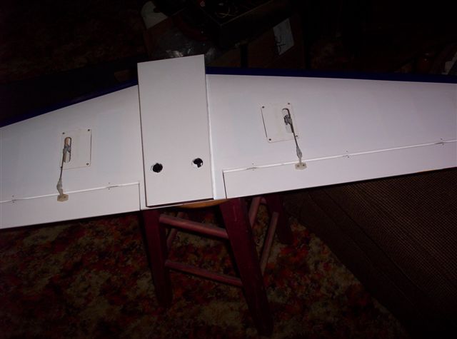

On the wing I soaked the two LE dowls in thin CA and gave the holes they go in a few drops as well. After reading about the wing coming off and breaking the fuse in mid-air this was my first clue the front supports may be shipped weak. And they were btw.

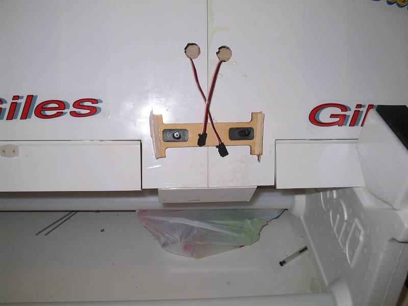

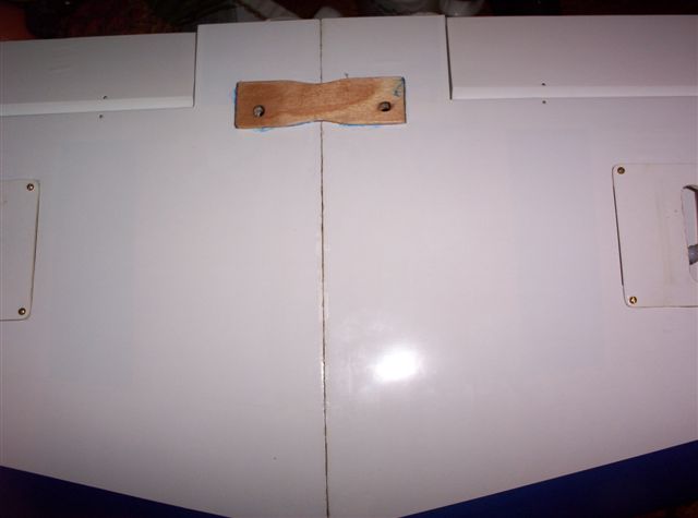

Also cut out a wooden plate to add support for the wing-bolts. I noticed the nylon DuBro heads were already starting to cut through the thin wing mount area. My UCANDO needed the same treatment. (God bless the two-piece wing.) Wish they were all two piece.
I measured the distance from the firewall to the back of the prop nut with the .46AX mounted. 4 3/4" exactly. All I can say is that we must be getting differant ARFs with the updated factory changes made on some and not others. Several of the mistakes listed on this thread and other posts have been fixed on this shipment.
The wing and the horizontal tail piece are the two weight culprits here.
That sheeted wing is heavier than it needs to be IMO. And the metal rod they used for securing the two elev halves is way more rod than needed. A CF rod would have been perfect and decreased the tail weight alot.
The cast-alum motor mount would normally get a toss in the spare parts box. But in this case I may need the extra weight up front.
This will be a beater plane for me. But for some,, it may be a second or third ARF. I hope they see these posts and correct the flaws and mistakes before doing the maiden flight.

If the wing breaks off in flight running an OS.46AX after all this glassing then I guess I get to use Tower's great customer service.

Nice write up Sturtz. Looks like you're building a tank. Keep up the good work.
I ended up getting rid of the alum-alloy motor mount and used a Dave Brown 4650. .90deg. These 2strokes will run fine inverted or at 45deg. But the closer to 360. the better. Good old 90-degrees with a nice head-hole in the cowl.
Now I'm down to one last detail. (besides reshaping the warped LG) I need to figure out how and where to run the throttle push-rod.
The Pitts muffler leaves me with only one area to travel back to the firewall. Then I'll have a fuel tank in the road.
Suggestions ?
More pics coming tomorrow.

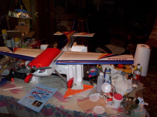

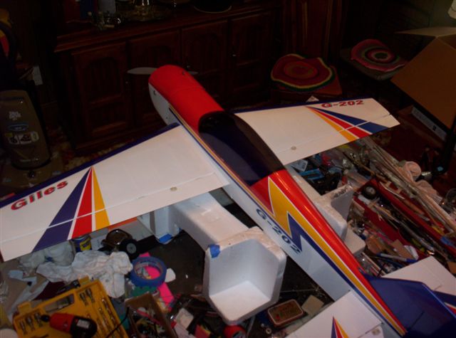

Almost finished. A few things left to do and then CG and maiden. I noticed after taking these pics this morning that the trim stripe in the middle of the wing doesn't line up. But that will be inside the fuse. Notice I cut the covering under the fuel tank so I could install the blind nuts easily and fit the tank and throttle rod. I also cut a patch back at the tail section underneath to ease pushrod assembly.
I'll iron the covering back before flight. LOL !!!
I test ran the motor last night checking the throttle servo, tank and pressure. The OS.46AX is well broke in and I used a 11x7APC.
I had been running a 13x4-W APC while flying it with a TT Extra300 FunTiger profile. Wicked vertical and with the low weight of that plane the larger prop had no ill effects . This plane weighs more as you know so the oversized prop is out of the question.

Ok,, it's only lacking some canopy glue and trim then to do the CG. But I knew I better take a pic of it now while I was thinking about it.

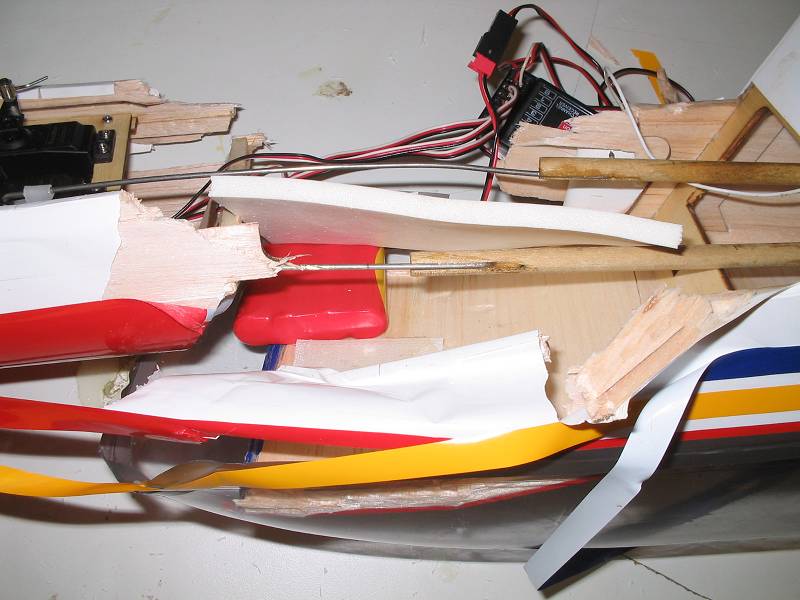

This was mine with the 11.7 apc with the 46 apc. Couldn't be happier with the plane when I was flying. Switched from 11.8 wood to 11x7 apc and look what happened after what to me sounded like a helicopter reversing pitch. Good Luck. It is a great flying plane but just watch the speed.

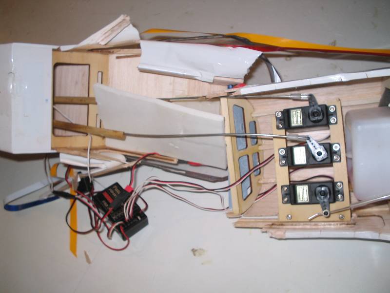

On the pic above notice the wing and that the plywood is still attached, the ply did not break it was the balsa it was attached to that broke. Possible weak point?? I think so.

Well I don't think it was the prop that caused your trouble. Although you can get some speed from an 11x7 thats for sure.
Unless it was way out of balance. I also noticed in the pic that you used the stock wooden push rods,, they are weak. Also noticed they aren't wrapped or have any heat shrinking where the metal rods attach. It wouldn't have been long till those failed anyway.
The wing saddles are very weak. Same as the Seagull models. In fact,, they are basically one in the same. Same wood, hardware, covering,, everything. Even the manuals are printed the same. Except the name. It's no wonder,, they are both made in the same factory in VietNam or someplace similar. One is sold by Horizon , the other by Tower. Half the hardware and even the landing gear I'm using came from my crashed Seagull Extra300. But with a little reinforcement during the build they hold up pretty well. Even when over sped.
