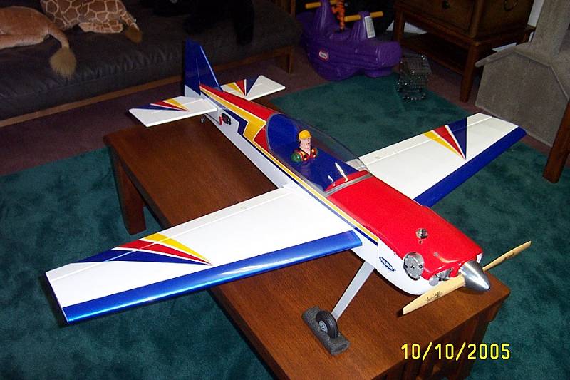

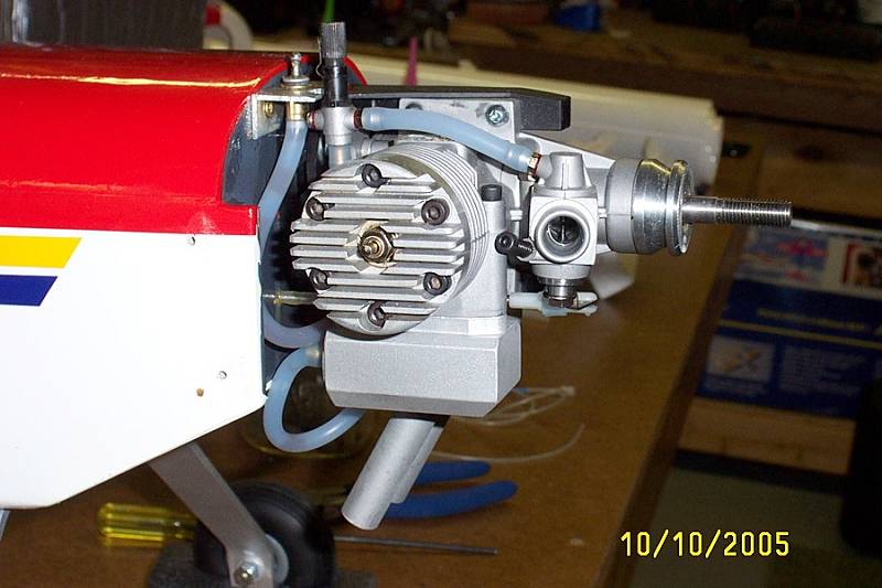

I just finished my version of the Giles 202 : Magnum .61 2-stroke, side mounted, Slimline pitts muffler, GP adjustable mount, 5 cell 6 volt pack next to tank in nose (on left side to balance engine), servos in tail to get CG right. Hitec 475 servos. No extra weight needed for balancing. All up weight on digital fish scale : 6 lbs 9 oz. Here are some pics. May maiden her today depending on the weather.
#85
Joined: May 2003
Posts: 314
From: Cranbrook,
BC, CANADA
Flight report: Take off - no fuss - the tail comes up super quick and minimal rudder input is needed. Airborne after 30-40 feet. The Magnum .61 with a 13x4 prop provides unlimited vertical. I think a .46 will not do this plane justice. The Slimline Pitts muffler sounds great. The 13x4 prop also helps to keep the speed down and reduces the risk of flutter, I don't think this plane was designed to go fast. Needed 5 clicks of down trim to fly hands off. Tracks very well, the 2 degrees of right thrust seems spot on. Roll rate is astounding ! ! Snaprolls are a blurr. Exponential rates are a must to fly this one smoothly. ( if you don't have a computer radio keep the control throws down ! ! ) Knife edge flight is effortless - pulls a bit towards the canopy but it is easily mixed out. Flat spins nicely. Landings : it actually flies fairly stable at slow speed but be sure to keep a bit of power on to avoid a surprise. At idle the 13x4 prop acts like an airbrake. I used Hitec 475 servos all around except on the throttle (Tower TS53). With the rudder and elevator servos in the tail no other weight was needed for balancing. Battery is a 5 cell 6 volt 1700mAh NiMH sitting next to the tank. Tank is a Hayes 13oz unit - not the supplied one because of the bigger engine. I use a third line for refueling. I used different hardware but the supplied hardware is also OK. Make sure you have no slop in the control linkages, the control surfaces are big and flutter could be problem. In all - I like it, it looks great in the sky and is real easy to transport without taking the wing off.

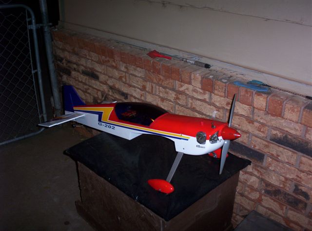

I would like to add another Giles 202 to this thread...
I have:
Super Tigre .51 Ringed
Master Airscrew 10x5
S3151 Digitals on R,E,T
HS-475HB Karbonites on the Ailerons
4cell GP3700 nicad (Big battery! That's all I had on hand, but I can fly all day!)
I basically used everything from the ARF kit. I did not use the Clevises it came with. There's no barb on it to hold the rubber ring back. I used a flex cable for the throttle.
Since this is my first Glow plane, I had trouble at first tuning the engine. I was close, but yet, still far from tuning the engine good enough for a good flight. So I dead sticked it many times. 2 times I broke the landing gear off of the mount. I used Poly Urethane glue to put it back together. Now, it's stronger than ever. I'll probably end up glassing it later.
Mine came with the aluminum wing joiner. Because I fly alot of gliders, I taped the giles' wings together with the joining rod. Alot of gliders that I flew, the wings are held on by electric tape. The wings go up, because of the lift, not out. So it holds just fine. I've been flying my giles like this since. So far no problems. Better yet, it's easy to pack down and save space in my honda.
I've owned this plane since July. I haven't flown it since the last time I sheared off the landing gear., so the engine is still spanking new. I took it out last week and got a friend to help me tune the engine. We had trouble tuning it, but I forgot to mention to him, it's new! But it flew nicely without any dead sticks this time. I did one flight and left. Yesterday, I went out alone to run the engine more. This time, it's running a bit better. I'm feeling more power coming out of it everytime I fly it. It's SLOOOOOWL breaking in. I'm only 1/2 a gallon through this engine. I ran the first 2 tanks on the ground BTW. But I guess that wasn't enough for breaking in a Airplane Ringed engine. My OS 50 Hyper engine on my Heli was easy! to breakin and run. Airplanes are a big difference.
I like how it takes off, tail picks up when you take off. I take off at 3/4 throttle. Sometimes half. and still manage to take off less than 50 feet. I can only fly it at 1/2 to 3/4 throttle right now, I haven't gone full throttle alot. Just briefly. Since the top end is VERY rich, it makes no difference from 3/4 to full throttle. So I can't tell you if I get full vertical or not with this engine.
It flies nicely slow with a little bit of nose up. It flies fast when I dive it at 1/2 throttle. and still manage to get to the same altitude as before at 1/2 throttle too. Too slow, it'll give you a suprise alright... Snap rolls are scarey fast. Rolls are super fast on high rates. Inverted flight is no big deal. Just a touch of down stick. I'm going to move my CG back a little anyway because i'm flying with a bit of up trim. I have no weight in the nose. I think it's actually a little nose heavy!
Landing this plane is easy. I just make a large turn around the landing strip. Line up, 1/8th to 1/16th throttle, once it gets low, I get into idle and just flare it out.
So far, this plane is fun to fly. I can't wait for my engine to be fully broken in so I can have more fun.
Questions: This plane is darn heavy for it's size, but I notice, the control surfaces look like they are able to handle a bit of 3D. I won't be able to find out until my engine breaks in, but I would like to know if any of you guys are prop hanging it? If this plane last for a while, I'm going to for sure! put a YS63 in it when I can afford one and put my .51 engine in a 40 size stick for some bashing around fun.
I notice a few guys were talking about putting a YS63 in this plane, but I don't see anyone talking about it on this thread.

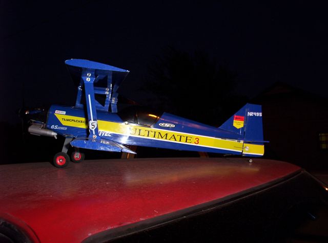

Went out and flew the Giles this evening,, just got back. The OS.61 SF w/Pitts muffler gave it the vertical zoom it needed. Used a 13x4w APC for the testing. Easier to slow down just in case.
Flew around for a bit just doing some simple loops and rolls,,, no problems except it seemed I was having to add lots of up trim. I figured that I would need to CG again and that I was just a bit nose heavy. Not so. Went vertical with high rates on to see how she hovered. When I came out of the hover I had little if any up elevator. [X(][X(][X(]
Bob Pastorello "Aerobob" was at the field taking a break from flying his new UltraRC Giles 29% when I said to him that something is very wrong here. He said "LAND IT NOW !!"": I had to abort my first attempt because the throttle was way too high. So between jamming the elev up and trimming up at the same time plus trying to trim down the throttle I managed to land. Taxied back to the pits and shut down. "Whew"!! What a scare.
Removed the wing and discovered the whole servo tray had come loose. Needless to say I packed that little plane up for the night.
Luckily I brought my little Ultimate Bipe and got a couple of good flights in on a perfect evening. 3mph slight crosswind.
Took the digital camera but forgot to take any pics after the near gopher hole digging. But did grab a couple of the Giles after I got home. Also the little Wattage Bipe.

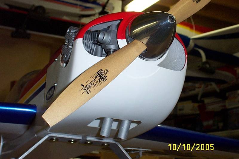

Got the Giles ready to fly this afternoon and it does very well with the larger motor. Used a 12x6 wood instead of the 13x4 APC and found it to acually be slower feeling for some reason. Also you can feel the added weight of the .61 compared to the .46 but it's worth it when you point the nose up. Just keeps climbing unlike before with the .46AX.
What prop works the best with the OS .61SF ?
Thanks in advance.....

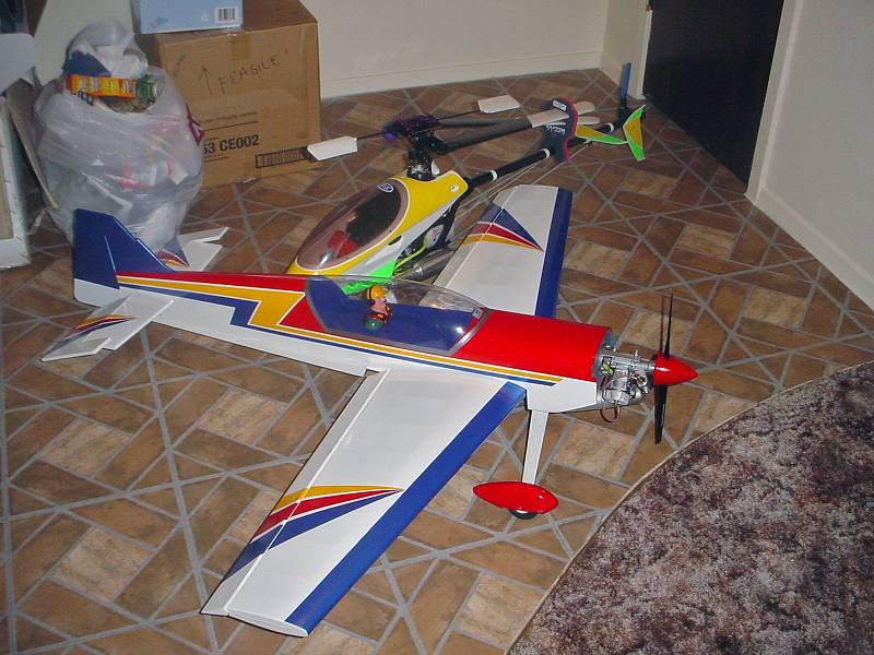

I"m currently using a 11x5 APC on my SuperTigre .51 ringed 2stroke engine. It's a bit fast at full throttle. At half it flies great. But now I'm looking for a prop size that will give me better thrust and less speed. Should I go with a 11x3 or a 11x4? I think I can hang with the 11x5 prop for now. It's flying just fine. Point the nose up and away it goes. (After the engine is broken in!)
I took the man out and painted the inside of the canopy black. Man it looks better now. I also glued the wing halves together with Elmers Ultimate Glue. That polyurethane stuff instead of epoxy.
Oh boy I can't wait to fly this thing. I haven't flown it with the cowling on yet. My engine is almost fully broken in so I think i'll go ahead and slap on the cowling.
Also, I think I want to get a different type of landing gear for it later on. I want a one piece instead of that two peice it has. Maybe I can get something lighter.
