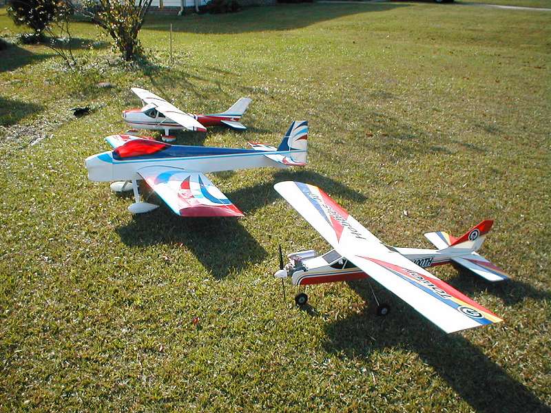

Well I just got home from flying my Phoenix Giles 202. This is only my second plane, but I think I am in love. I got this to be my low wing trainer before I fly my UCD .60. The plane is a joy to fly, just a little different than a trainer when it comes to turns.... ALOT FASTER! I am new to this, but I feel like this model needs more power. I am running a Tower .46 with a 11X6 prop. The plane is slower than my trainer was with the same engine and prop, but it is heavier.. Does anyone have any good suggestions for a prop/engine combo that would be better for this plane? Also can someone reccomend a better tail gear for this plane? Since I land on grass the stock bends every time.

If your flying that giles the UCD .60 will be a snap for you, A friend has the Phoenix Sukhoi with a OS 52 4-stroke and his needs more power too, I am planning on getting the giles too for my YS 62FZ but that can be a bit pricey but I have read that the saito 72 is also a good match if you want to try a 4-stroke if you want 2-stroke there are many 50 ish engines that would be a drop in replacment for your 46 also you could try a 12x4 prop, it would slow it down a little but give you much better climb with your 46

Try an 11x5 APC prop too. Speed won't really be effected, but you should notice more pulling power.

I would try a O.S. .50 SX with a 13-6 or so. It's not that mutch more power, but with the right prop, it should give you unlimited vertical.

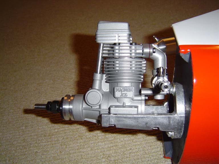

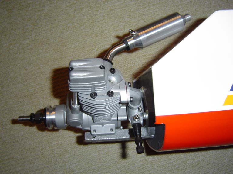

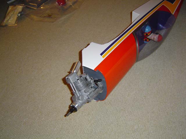

as some of you may know, i have just received the kit of the phoenix giles202. The motor i had selected (because i got a deal!) is the Magnum 61RFS 4stroke. But when i sat it on the metal engine mount, the rear mounted carby stops it from sitting close enough to the firewall.
I think I have either 2 options:
1) get a new plastic composite mount to suit the 4stroke
2) get a 2 stroke motor!!
I really like the idea of the 'slow sounding" 4 stroke and i think the 61 would be a good combination for the Giles as the recommended size is a 40-46 2 stroke.
Will the weight be a problem? I think the magnum 61 weighs almost 40% more than a 40 2stroke, and if it has to sit further forward, then i am going to need some lead in the tail. And from reading the posts, it seems that the Giles is already heavy enough with a high enough wing loading as it is.
Id appreciate your thoughts people..........

Mike,
What's the Magnum weigh? I know that a Saito .72 is only slightly heavier than an OS or TT .46.........
If the Magnum really is that heavy, you might need to worry about the weight.....I don't have the Giles, but I have the Phoenix Sukhoi SU-31, and I had to move the radio gear and battery to the rear of the radio compartment to balance it with a TT Pro .46 up front....

The Saito72 is slightly lighter than the Pro46, but pretty much equal to the 46FX and AX. The Mag61 is actually lighter than the TT and OS 46 2c's so I wouldnt worry about that.
baxternick
Have you checked out the new Mag XLS 52 2Stroke? One of the guys I fly with is getting one for his Phoenix Sukhoi. How much does your Giles weigh? I have the Sukhoi with a Pro46 and APC 11x5 prop and its a rocket, I also tried a APC 11.5x4 and it slowed down alot but gave it a little more pulling power, I tried a 11x7 MA wood prop, but didnt like it very much, I went back to the 11x5 APC.

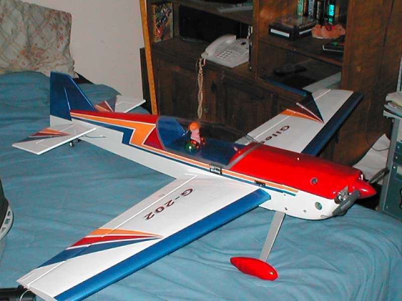

I am working on a Phoenix Giles for a guy at our field who has crashed it twice and now want's me to figure it out. It seems on take off that the plane doesn't want to come off the ground and when it does it goes vertical and he get's nervous and chops the throttle and piles into the bushes at the end of the runway. I wasn't a witness to these 2 flights but the guy isn't a bad pilot. I haven't had a chance to really get into it yet but all the incidence look ok and the CG is at about 4" with at 61 magnum 4 stroke on it. Any ideas before I start chopping on this thing. I haven't checked what kind of throw he had in it yet either. Just doing some preliminary investegation with you guys that are flying them.
Thanks in advance.

diggs_74, this is uncanny!
I have the same plane and am attempting to use the same motor with the same problems!
When using the magnum, twice i ran out of runway and ended up rolling into the long grass and tipping over.
When it finally gets into the air (luck) it wallows around the sky with a "tail -down " stance.
I have also tried the same plane with my OS 46FX. It gets of the ground better and will fly "ok" with full throttle but i have to keep the speed up in the turns.
I thought the magnum didnt work because it wasnt fully run in, so i ran the magnum in properly and wanted to re-try it (i like the sound of a 4 stroke)
Same problem; not enough power, or so it would seem.
Twice the plane tip-stalled on me and i only just recovered it.
My Giles with magnum and radio gear (minus fuel) weighs 6.25pounds ( i am not sure about the wing area).
My conclusion is that the plane is too heavy for its small size, or that it needs a larger motor with a lot more authority.
Seeing as i havent got a bigger engine yet, i am flying something else with the magnum (56inch span) which pulls almost unlimited vertical (only weighs 4.25pounds!)
I have never crashed the Giles (lucky again) but it is in the garage doing nothing!

Gday Mike, The wing area is 3.5 sq ft which says at 6-1/4lbs = 28.5oz-sq ft...heavy !!
while I havent flown mine yet , it sounds like we need more power/speed.
it might help to wash the ailerons out a bit to help with tip stall.
ALSO there is a WEAK area in the fuz sides at the cockpit start ,where the wing rest is highest, beef up the sides with a 5 ply 1/8" doubler thru the whole wing seat area.
I'm going to take the MAGNUM 53 2st out of mine and go for a 60 2st or a 90 4st.....heavy planes have to fly faster.
