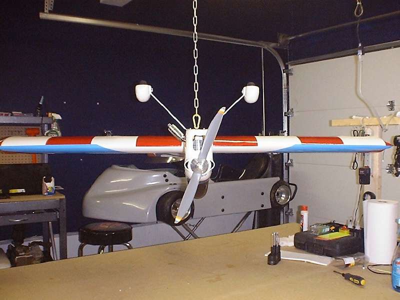

Speaking of CG, along time ago someone showed me a trick for setting CG in both directions at one time, To this day Ive used it and never had to add more than a click or two of trim.
You have to find the Center of the fuse/wing and glue in a doubler, then drill a small pilot hole to thread in a hook, set the CG by setting weights around on the plane and wing tip to get a perfectly level plane.
Pull out the hook and put a trim dot over the hole.
PS love this Forum and all the great advise!!!!

Joe, my GP cg machine works well. I tape two 3/32" thick balsa sheets ( approx 3"x6"), one on each side of the wing root. This is to prevent depression on the covering over the open bay caused by the pedestal of the cg machine.

Pook, I really like your balancing machine. Now thats what I call perfect CG balance. Very nice work. As for the weight, I thought mine was heavy @ 7 lbs. 14 oz., which is pretty close to 8 lbs. Joe would be the better one to respond to this. he hates weight... I am using a 14/6 APC prop on mine and I have no problems. I can take off in about 15 to 20 feet and go vertical and just keep on going unlimited.
