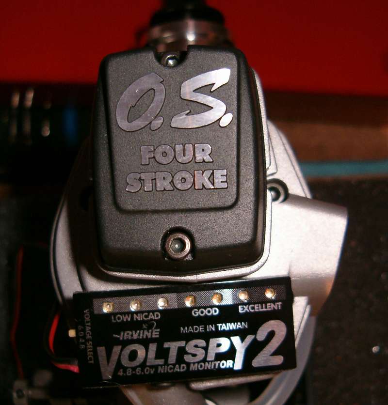

What a clown.!..i forgot to tell ya what i came her for...dont know wether you can get these but ..bought a SWITCHABLE " voltspy 2 " yesterday, like the voltwatch thing from Tower but with a tiny, tiny switch to get ya from 4.8v to 6v...not seen/was'nt aware of such an annimal ....o.k. if ya runnin a 5 cell set up

Yeah,Coo...
It's actually a Irvine product distributed by Ripmax, but SMC stock the @ .... www.Sussex-model-centre.co.uk .. Ripmax do a couple of variations on the theme... www.ripmax.com...( these things are suitable for NiMh's too )
Sussex is good..just type in " voltspy " in the search on the left hand side of the home page....
Ripmax...is ..... "products" then.. "accesories" then.. "Extra electronic accesories" when,

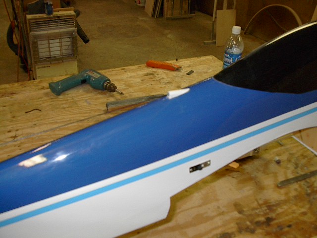

Gentlemen, just finished up the cowl with the motor and mount, now, in the correct position. Still don't know how I missed that one. With the cowl on, we will see if the nose pitches up as without. I will continue testing for the perfect thrust angle. Still at 3 degrees, was hoping the 15/4 APC would have arrived by now. Surely with the 16/4 it will need 4 degrees right thrust. Wanting to see if it will need any up/down thrust. Adjustments will just be a bit more tedious with the cowl. This coming weekend looks promising, chance of rain, but the jet stream is going up towards J Dubya's area and is bringing in some warm air with less wind. We will see. Joe
Update: just checked the lateral balance of the wing.......dead on right out of the box. Found the center, front and back, stuck a pin in both centers and hung it off a string. Can't get any more accurate than that.
