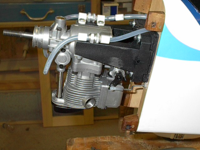

ok guys, im about to swap the Saito 100 for a YS 1.10 I am afraid as this is my first exp with a YS and I was told the needle settings are screwed up with this engine (thats whay I got it so cheap)
For those using YS, what type of fuel tanks did you guys opt for? I am considering a Hayes myself. Also is there a schematic of the plumbing thats required? Mine came without any instructions so im not sure how to plump it

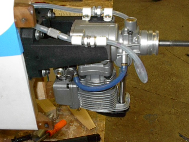

Also some good reading can be found at http://home.comcast.net/~mark.fuess/ys11o.htm Here is the way I routed my lines and an exhaust mod with a Hatori Header. Don't forget props, you can swing a 16/6, 17/4 and a 17/6. Good luck, Joe

One more for good measure. The stock muffler on the header proved to be problematic. The free flow of the exhaust down the 5/8 inch header is now backing up where it joins the stock muffler due to a size restriction. Heat builds up at the connection and is subject to failure. I guess I need a small can muff to make it right. The open header is great but exceeds decible limits at the field. The exhaust routed this way leaves the plane goo free, which is a big plus. Joe

Joe and Barry thanks for the info. It looks pretty straightforward. Need to get some check valves and a few T's, otherwise looks like it go in pretty easily. I might stick with the stock muffler and have it hanging out the cowl like I have it now. Its not going to win any awards for being pretty anytime soon so im gonna leave well enough alone

Matt, did the seller include the supplied check valve from YS? If not I would recommend getting original equippment, as it is superior to the valves I've seen on the aftermarket. Joe

thanks for the info Joe, no the seller did not provide me with the stock valves, I will have to visit the LHS and order a few as I have 4 YS's now!

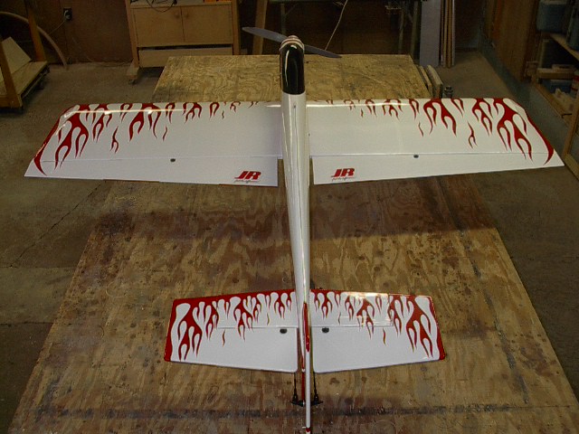

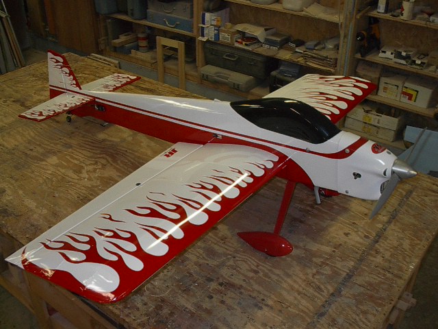

Spring colors, well actually it looks like a fall color scheme. The last two seasons we seemed to have our share of cloudy and overcast days. With the two shades of blue on the UCD it was easy to lose in a gray sky. I posted somewhere here when I changed to flames. Well it was worse, perhaps the flames were too small, or its just these old eyes. So I got jiggy with a pile of ultracoat and put the boomerangs back. I missed the original scheme and I can see it now, at least untill fall. Check it out. Joe

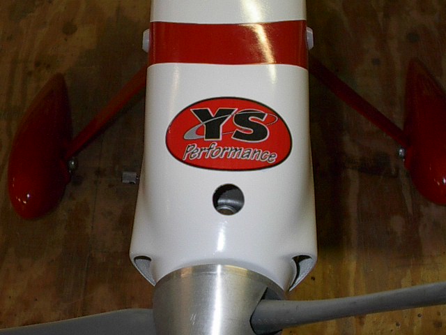

I forgot the best part. Joe

your skills with the covering are outstanding Joe! Nice job there

Joe,
She looks great, nice job. I see you cut a hole in the cowl to fiddle with the regulator some too huh??

Stoney, the hole is there, but havn't had the need to put a screwdriver to it.
