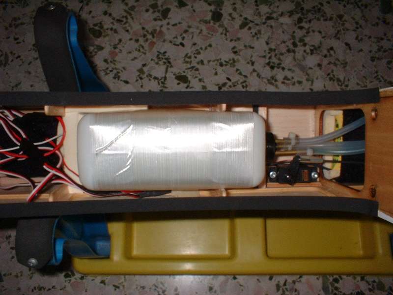

Thanks for the help men Do I put the center of the fuel tank on the CG?I was curious about the thrust because all the guys with the ys were going 3% with a much larger prop had me wondering about 2% thrust change. This is my first U can do and hope to do it right the first time thanks to all of you who have spent many hours refineing this fine plane

yea tugman, put the center of the tank as close as possible to cg without going behind,a little in front is ok but not behind. like this.the black strips are weather striping to snug it in when i put the wing on and holds it tight without having to secure it with crossmembers.

Gary, here's a tip. Wrap a few rounds of filament tape around the tank to reinforce it against pressure buildup when using a cline system. If you need me to post a pic, let me know.
