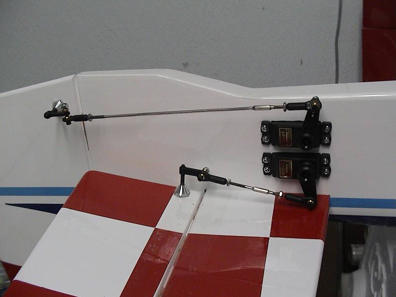

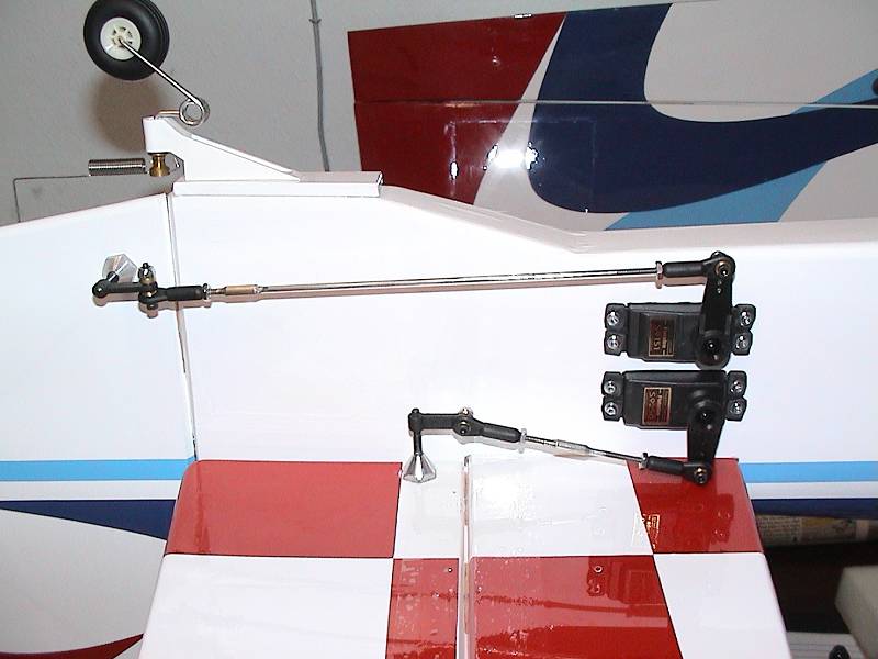

Could I get the dimensions from you as to where you cut the hole for the rudder servo opening?
Also, how long are the push rods? They look like they are so long that they would bend/put a lot of weight towards the tail?
I was wondering why you didn't use cable instead?
Thanks for the information. John.

Servo hole location is 9 to 11-1/4 inches from the rudder hinge line or end of fuse. It puts you directly under the right side elevator. The 4/40 rods, pin to pin, is 9-3/4 inches. I went 4/40 over CF rods or wire for the needed weight in the tail. joe

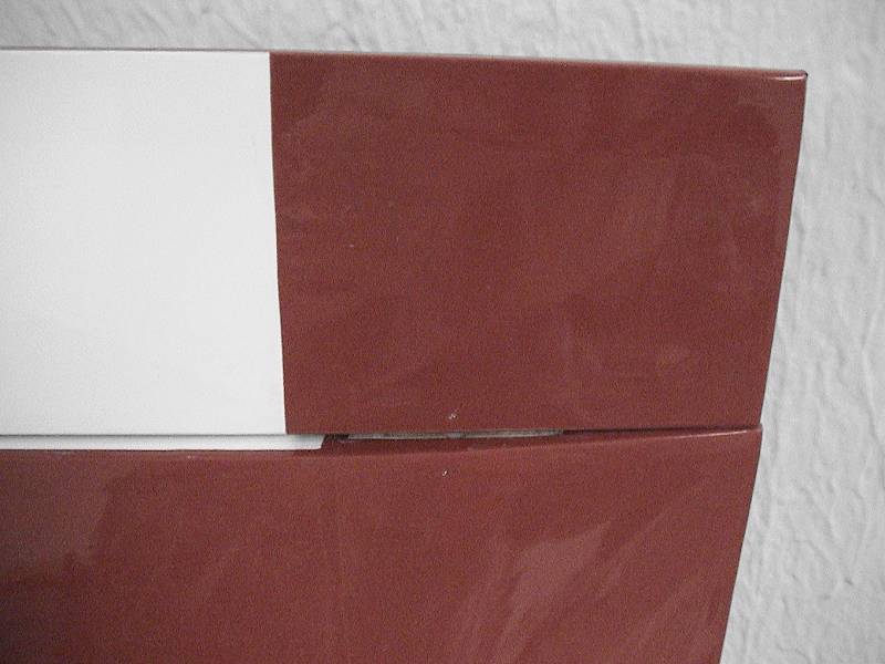

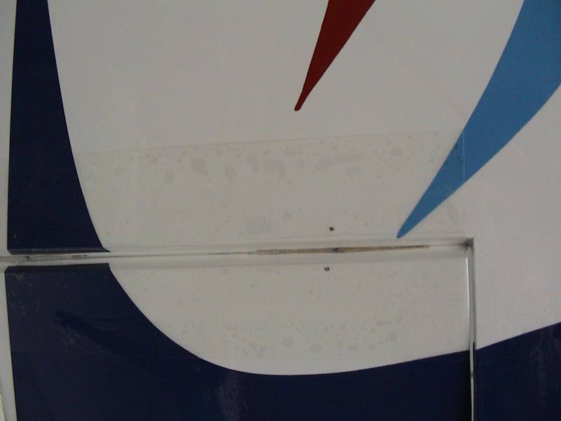

I'm building my first UCD 60 and I am concerned about pulling out the stock hinges during flight. I have done CA hinging before, but I would appreciate and feedback from this effort. I glued the hinges in using thin CA and also pinned each one (in the ailerons, elevators, and rudder) using the end of a medium T-Pin. Then, I sealed over all the hinge gaps with clear Monokote. I have attached a picture of the results. Also, the instructions seem to indicate that the hinges are supposed to go in "short end first". Mine seemed to fit better "long end first". Can anyone tell me if this should cause any problems?
Thanks in advance...Joe H.

Seems as though you have covered all the bases as far as CA hinges go. When I used to install CA hinges I would insert them the long way. I've also seen where the hing was longer than the recieving stock, so I guess it would not hurt to install them on the width. Regardless of how well they are installed, sub torque servos or a weak linkage setup will destoy them if flutter results. Good luck, Joe

Thanks for the note of confidence on the CA hinging strategy. I understand that there are no guarantees, but I appreciate everyone taking a look so that anything obviously wrong could be pointed out.

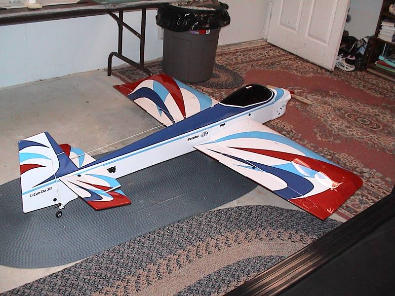

To follow it up, I am also replacing the stock rear wheel with the Sullivan Tailwheel. I installed it by epoxying it to a piece of Monokoted plywood that is shaped to the bottom rear of the UCD 60. The plywood is also epoxyed it to the exposed balsa. Then the whole thing is screwed on using #4 wood screws. See the attached picture.
I am using the stock setup for the main landing gear, although I am considering drilling out the 6-32 blind nuts and replacing with stronger fasteners.
Also, I am using 4-40 pushrods on the ailerons, elevators, and rudder. Futaba S9250's power the ailerons and elevators with a Futaba S9151 on the rudder. Has anyone seen or used Dubro Heavy Duty Ball Links on both side of the 4-40 control arm like the picture shows? Note, also, the Dubro Heavy Duty Control Horns and the Dubro Super Strength Servo Arms. I have seen flutter destroy two aircrafts; it is not pretty, so I try to avoid it with strong servos and zero play in the linkages. If there is anything obviously wrong, please say so.

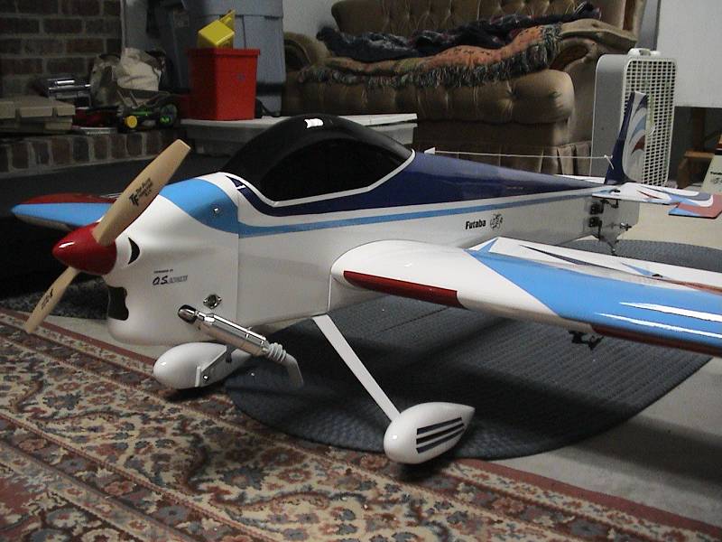

I am using an OS FS 91 w/pump in the front. I think that the reason it is so tail heavy is because I used the OS Aluminum engine mount which does not place the engine out in front far enough. I also used 4-40 rods all around and a Sullivan tailwheel, which adds weight to the rear.
I am really upset about having to add any weight at all to the plane. Plus, I won't be able to use my Tru-Turn spinner because now I will have a Harry Higley Ultra Heavy Hub on the nose.
