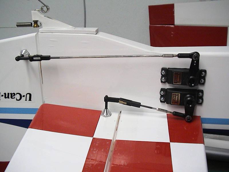

Fortunately, I found a issue with my control linkages before I took my maiden flight. As you can see in the picture, I have ball links on each end of my control rods. Plus, I have Dubro Heavy Duty control horns. Well, it turns out that the control link connection on the Dubro Heavy Duty Control Horns swivel around the end of the 6-32 socket head screw. The ball link control rod ends allow them to swivel very easily (that's what they are supposed to do). Obviously, this swiveling action changes the total length of the control rod, thereby changing the control surface position. Boy am I glad I saw this before I took my maiden flight. This would have been a sure crash.
So, now I need another set of control horn clevis' that won't allow the control horn to swivel. Maybe just simple Great Planes 4-40 Steel Clevis.

I finished my UCD 60 last night. I solved the control surface linkage problem with Dubro Safety Lock Kwik Link 4-40 at one end of each control rod and 4-40 Ball Links at the other (see the pictures).

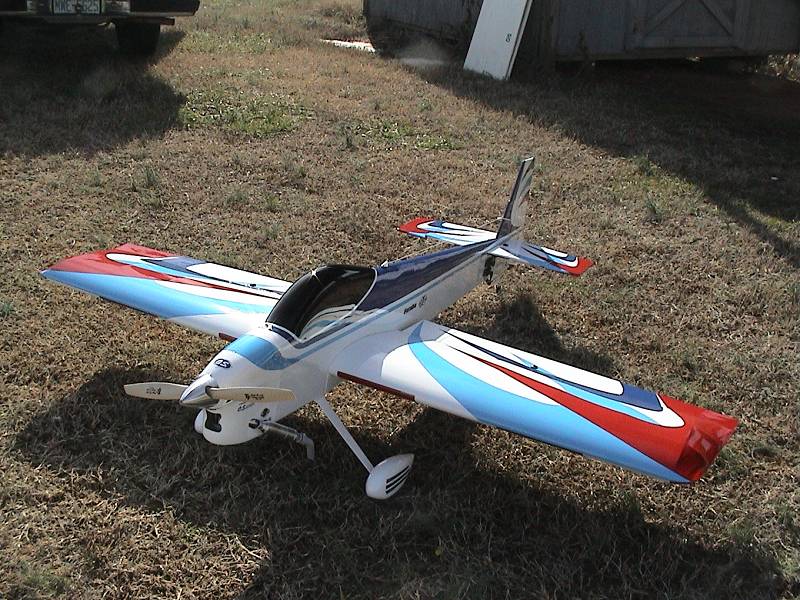

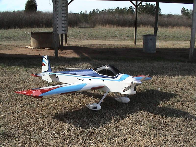

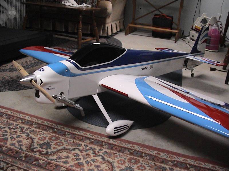

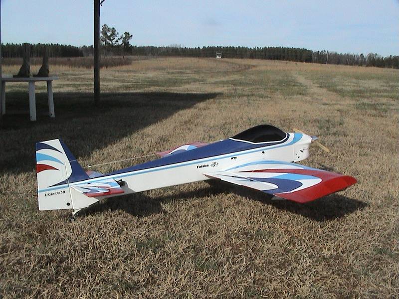

So today was the maiden flight for my UCD 60 and everything went perfect. What a great aircrafy to fly!. This thing does whatever you tell it to. It's even fun to land the aircraft.
First I set her in the grass and took a few photos of her (see the attached pics). Then I did the range check thing; it came through with flying colors; not even any jitters. I just love PCM 1024 and Futaba's R138DP receiver.
I took her out three times. The first time was just a check out; get her up in the air, trim it out, try to get a feel for her, and bring her back down. Went over the whole aircraft to make sure everything was still as it should be; nothing moved out of place; great. Second time up I tried some simple maneuvers like loops and rotations to check out the control surface alignment. She tracks really straight. Third time up I tried some harriers to get a feel for when she wants to stall. This aircraft can move unbelieveably slow! Elevators must be simple to do with the UCD 60 (maybe tomorrow). I didn't try anything like hovers and torque rolls yet; I don;t trust the engine until I get some more time on her.
I setup the control throws as per the instruction manual only to find out that I only used the (manual's) high rates. So, tonight I will set the current high rates to be the low rates and program some REAL high rates in it. Tomorrow I'll take her out again and begin to get a bit risky with her. This aircraft is FUN!

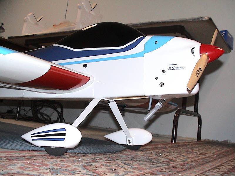

I included three degrees of right thrust and zero degrees of down thrust (with Ernst Thrust Plates) when I built my UCD 60 with the OS FS 91 w/pump. I checked the thrust angles by flying over myself and going throttle on and throttle off and it seems to be right on. I haven't been able to hover very long with the UCD 60 yet (new engine is still too rich), but my attempts at it don't seem to wander left or right with the throttle. I notice that I need a bit of elevator during a knife-edge, but I don't think that is a thrust issue.
You can see the Ernst Thrust Plate in the attached picture.
