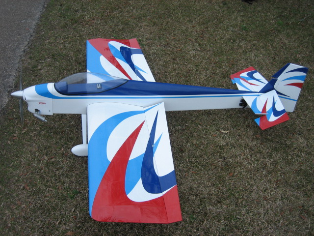

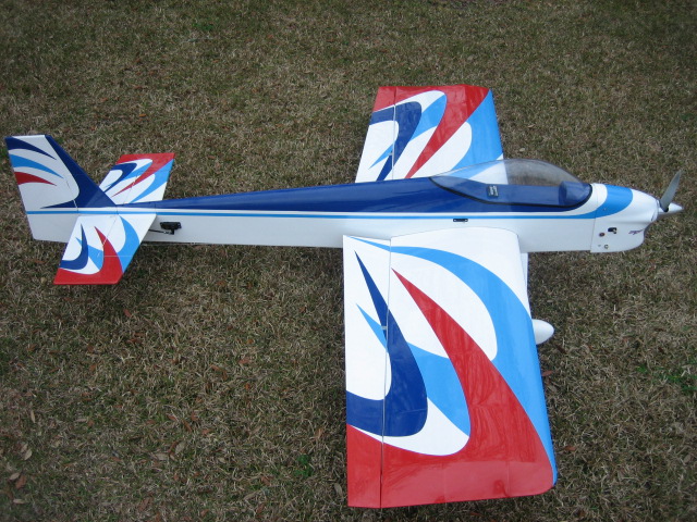

Hi Chuck, i just remaidened mine after it took a break for about 8 mos and i still love this plane.
the suggested rates worked well for me the first time and should do well, you can go from there
here are a couple of pics of mine since installing the saito 125 (i love this engine in this plane)

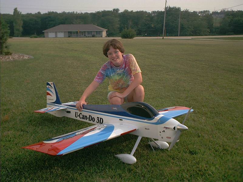

Hey, Downtrodden...You're a man after my own heart. I also believe in overpowering but you are taking it to a new level. Let us know how it flies.
I have an O.S. .91 pumper in my U-Can-Do .46 with a Master Airscrew 14-6 and it hovers just beautifully. I think this is the engine for the 46.
I came on this thread to see what you guys are using on a U-Can-Do .60 as I've had one behind the furnace for a year. I was thinking of using a Y.S. 1.20 as I have one on my Dave Patrick bipe that I can just switch.
I just started 3-D flying last spring and am an ex pattern flier. I haven't been able to hold a hover for longer than approximately 10 seconds, but am having a ball flatspinning. I mean pancake flat. My elevator is set at 50 degrees up and down and my rudder all but hits the elevators. 3-D is another challenge for me and I enjoy being able to scare myself again, trying new manuevers.
It's winter time in PA and I've only flown 3 days this month in the snow. I have an Ultra Stik on floats for snow. Lots of fun.

Great to hear all is well and thanks for the info on mixing Fred! I went out yesturday hoping to Mainden but no luck
Rain and low ceiling so I am putting it off it seems! I am going to try an attach some pic's to show you what I have so let see what works! Thanks again all and I just need to get the idle low without cutting out! Thanks guys!

#1396
Posts: 1,418
From: Back home in,
OH
Chuck,
Good lookin' plane!
Looks like you did a very clean job on the canopy.
I "smoked" mine...wish I had only lightly tinted it or left it clear.
I'm going to try to attach a pix of mine.
Good luck!
It will fly great!
JLK

Chuck, looks good! Don't be nervous, this plane is very forgiving. Suggested low rate, same for CG and you'll have a big ol' smile on your face. Bear with the Saito, it will come around. I feel that they really don't settle down till about the third gallon. Good luck and enjoy, Joe

May I suggest you use "Testors spray enamel #1257 transparent blue." I'm going to upload a pix of my U-Can-Do .46 canopy to show you.
Seems that most of the canopy material on these ARF's can not be tinted with the old tried and no longer true Rit dye process.
You may notice that my landing gear is not stock. I used Dubro gear fastened with 1/4-20 nylon bolts.
