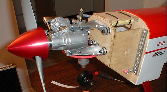

Well, it is finished. Looks fantastic. Need to add about 6 oz of weight to the front with the Saito 180. Where/how did everyone mount the lead in the engine box? Just curious...

Well, I tried to balance it after I added the 6 ounces, and it is still tail heavy. I have also found out that I cannot balance this thing alone, I just don't have the equipment or space. I need another set of hands....As of right now it is balancing at around 5", definately needs more weight in the front...

NOVAflier,I balanced mine at the fuse.What I did was measure to 31/4 inches on the wing tip in the center, took a couple tee pins stuck them in the wing tip where I marked and ran thread from one to the other side of the wing.I then presssed the thread down in the center and measured from the recessed area in the wing to the thread just to make sure it was even.
Take a piece of tape to hold down the thread and stick it to the wing.This made me able to use my great planes balancer with the plane inverted.I then was able to balance mine by lightly sticking the weight on the motor box until it balanced.Also use some old shirts or towels and lay them on the ground were your rudder is going to set and then you can hold the front of the plane up with one hand and move the balancer around with out scratching the rudder.This worked fine on mine and when in did get a extra finger to hold the other side it did balance where chip said to should . hope this helps.

Sounds like a good idea. Racsanone suggested that I look at possible moving the weight more forward, thus requireing less...I'm thinking about how best to secure the lead further out, but cannot think of a clean way..

Novaflyer, If you are creative, you can make a mold out of lite ply and melt the lead, then poor it in the mold and mount it directly to the front if the engine mount. My guess is you are going to need about 10 oz. mounted to the front two bolts of the motor mount. Mold the lead in a U shape and hammer the ends flat then drill a couple of holes for the bolts that correspond to the front two engine mount bolts. replace the front bolts with longer ones, bolt the engine in tight with a set of nuts and then use two more nuts to hold the lead to the bolts. I know it is a pain in the arse but works well and gets the lead where you need it and secure too. alternatively you might be able to screw it to the front of the engine box but you will need more lead, probably 13-14 oz.
One other thing. The stickem that comes on the back of those premade lead sticks has a habit of softening up and letting go when installed inside a cowl, which leads to some interesting flying. (Just ask me how I know! [&o] )
For reference purposes, My GSP Katana took 12 oz. of lead to balance with the Saito 1.80 and stock muffler when the OS 1.60 guys were getting by with 4-6 oz. and they were using the pitts style mufflers from slimline. The Saito's are light but have awesome power, I think you will be happy with it and the lead really won't be noticed other then the fact you know it is there. The only drawback to the 1.80 is fuel consumption. I get an 8 minute flight (3D stuff) outta mine on 14 oz. of Omega 15% I would love to run 30% in it but it's just too thirsty.

Novaflier,that is right the further forward the weight the less you will need.I would suggest a prop
washer weight,it goes in front of the prop but is thicker and I believe they come anywhere between 1/2 ounce to 1 1/2 ounces.that is as far forward as I think you could get.
It takes 1/5 the weight to fix nose heavy.The tail is longer and gives more leverage,you can go further out by the tail weight which requires less weight.Check out great planes web site for the prop weight I think there $6.00.
