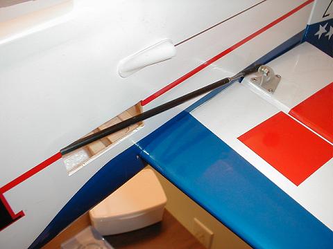

Cap-X maidened today. Needs work on the weight. It's just too much. Flew great. Nice plane...Going to work on putting the elevator servos in the front near the rudder servo to cut some weight out of the back....

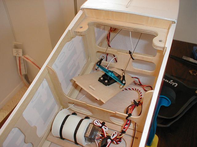

Had a failure on the 3rd flight, had to call it a day after that. Rudder servo tray popped loose. I CA'ed the heck out of it too!!!

ORIGINAL: NOVAflier
Maybe the pull pull cables were binding at some point of deflection? That could have pulled the servo tray loose. Just a guess.

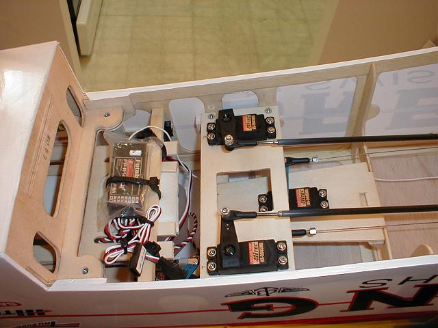

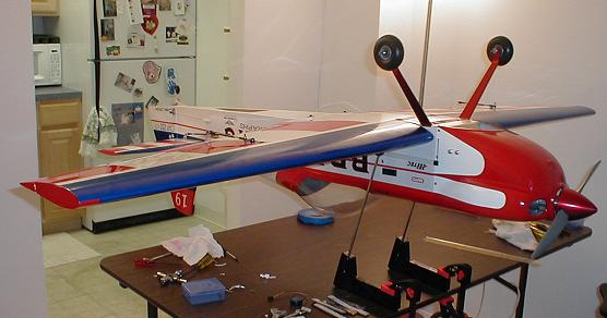

Actually, I am doing a bunch of reconfiguring to the plane in order to reduce the tail weight. I moved the rudder servo tray (since it convenently un attached itself) to about where the CG is, on each side of the rudder but just a little higher up I am adding the elevator servos and am going to run CF rods out the original servo holes to the surfaces. I will have to move my horns about 1/8 inward, but that should not be a big deal...I took out of of the servo trays in the rear of the plane, that thing alone has to weight an ounce or so, combined with the 2 5645's that are moving to the front I should be reducing about 5-6 ounces out of the tail...this should drastically help my lead problem in the front (crossing fingers here)

Nova
To lose 10oz from the nose you do not need to remove 5oz from the tail. This is a basic statics problem.
10oz/distance from CG = Xoz/distance from CG.
Solve for X!

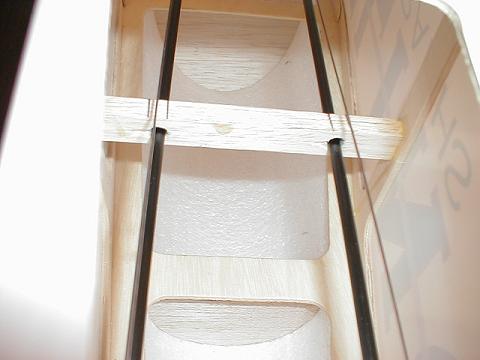

WOOOOHOOOO!!!! Thanks to the great suggestions of my "3D teacher", I have been able to drop the 13 oz out of the nose!!!
I moved the servos to the front, and moved the rudder servo up to the front also. Got rid of the servo trays and ran CF Rods to the elevator horns. Also installed a support to keep the CF deflection (if there is any) at a minimum. After all the reconfiguring, I removed all the weight and put it on the CG machine and it balanced right off the bat, it was a miracle. Now, I am dying to know what she weighs....Cannot weigh till Saturday to get a scale from someone and see how much I saved and what the all up weight is... Here are some pics..
I should probably do something about the openings, but at this point it isn't worth the effort, more unnecessary weight..

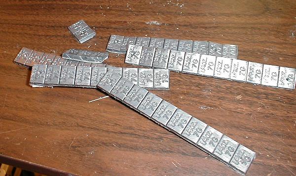

Anyone need some LEAD?!?!?!
