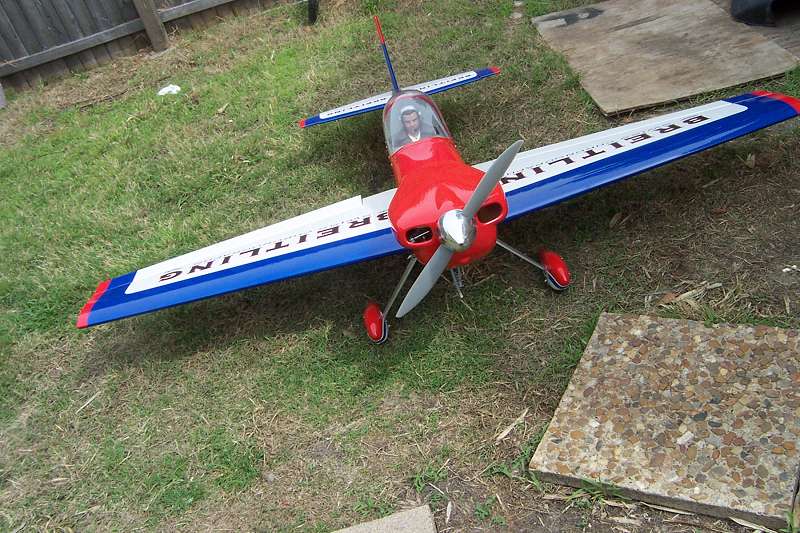

here it is

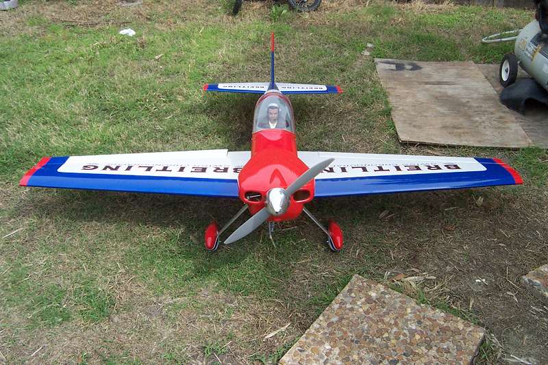

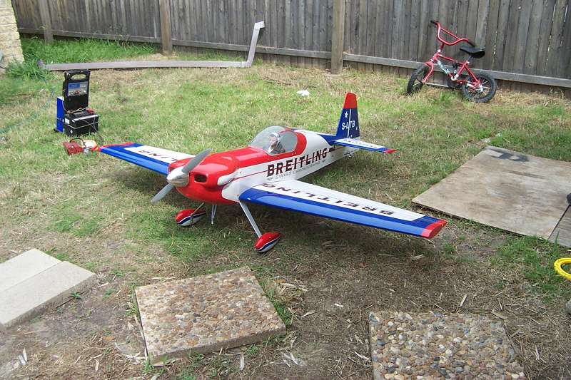

Default RE: Chip Hyde's Cap-X - Building & Flying
newest member to the family
ID:	132083   Click image for larger version
Old 05-14-2004 | 10:57 AM
  #386
Posts: 254
From: Weatherford, OK
That looks good! What pilot is that? Looking forward to your flight report with the Saito.

Its a pilot I've had awhile cannot remember where I picked it up at but its funny if you have real flight and you look close at the cap 232 its the same pilot.
Well wish me luck will post a flight report tommorow along with some video? and pic's.
