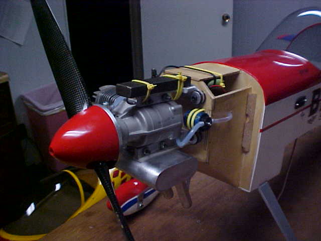

ORIGINAL: Bryant330L
Running the OS 160 w.bisson pitts and Perry pump.
do you have pics of your engine setup with the Perry pump?
Old 03-22-2004 | 11:15 PM
  #182
Bryant330L's Avatar
My Feedback: (126)
Posts: 955
From: Salem, IN
Default RE: Chip Hyde's Cap-X - Building & Flying
I will get you a picture tomorrow.
Old 03-22-2004 | 11:22 PM
  #183
Bryant330L's Avatar
My Feedback: (126)
Posts: 955
From: Salem, IN
might as well do it now before I forget... here you go

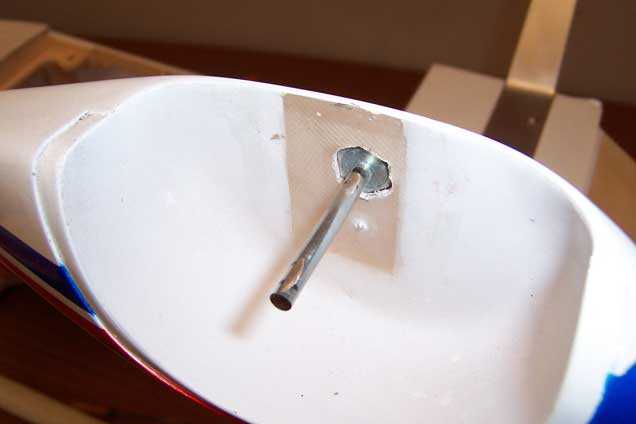

Richard,
Thanks for the reply Re: the pushrods. I bought the Du-bro 5/32 axles but they won't fit in the gear. Did you have to drill yours out to fit? I assume that the axels go in the bottom hole on the gear?
Scot
Old 03-23-2004 | 07:13 PM
  #186
Maudib's Avatar
My Feedback: (51)
Posts: 5,833
From: Ashland, KY
Terminator,
I can't recall the size but yes, drill out the bottom hole until the thread end can JUST pass thru. Then it is held in place with a nylon locknut.
The pant should be "notched out" too to tightly fit over the outer hexshape.
The upper hole is for a screw to "lock" the pant in place and prevent it from rotating. (But if you notch out a nice little hex shape in the pant, it will help too..
See here:

What batt does the pump run off of? The reciever pack or it's own pack? The pump would be good in another way in that it would add more weight to the front
Old 03-24-2004 | 07:30 AM
  #195
Bryant330L's Avatar
My Feedback: (126)
Posts: 955
From: Salem, IN
The pumps do not run off of a battery. Perry makes the vp 30 which runs off of crankcase pressure from the engine. and they make the vp 20 which simply operates off of engine vibration. With the vp 20 you just mount it from the engine backplate and hook the fuel lines to it and that is it. Very easy to hook up. With the vp 30 you have to drill and tap the backplate for a pressure fitting, which is not that big of deal either. Both work well and I think they are the same price, if I remember correctly.

Actually the one in the picture is the vp 30. I bought this engine used from Ebay and the pump came with it. I had the vp 20 on an OS 1.60 I had last year. If you need any other pictures I will be glad to help.
