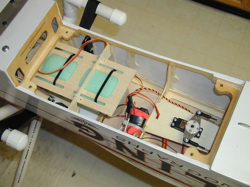

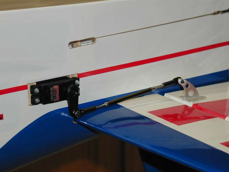

#142
Richard,
I can't quite make them out in the pics but, if those are new 5600 series Hitec servos, exercise them at least 20 minutes before commiting to flight. All the ones I've seen go bad do so in the first 10 minutes or so. If they make it that long they should be good to go. I know I'd hate to lose one of these on a maiden flight. A friend gave me the same warning when I installed four new ones on my old GP Giles. One aileron servo went hard over and stayed after about 10 minutes. He had experienced the same thing. I replaced it with another one and never had any trouble.
basmntdweller
basmntdweller

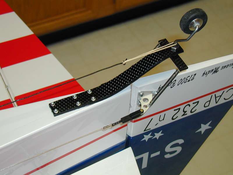

Richard -
What size CF rod did you use for these push rods?.
Which pump are you running?
Plane looks great!
Thx,
Drew
Plane looks great!
Thx,
Drew

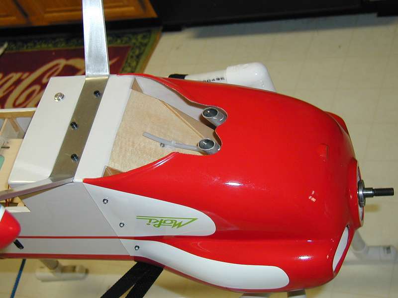

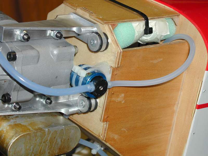

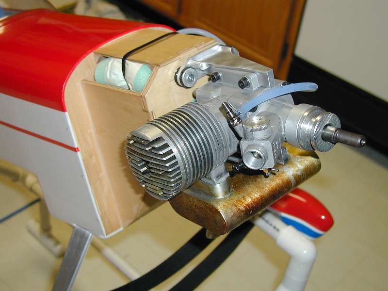

#145
Joined: Aug 2002
Posts: 391
From: Tomball,
TX
The CF rods are 3/16 with 4-40 ends, JB welded.
The pump is the Perry VP-30. The one that uses crank pressure to power it.
Right now I'm sittin at work. It's 74 degrees out, low humidity, partly cloudy and 5-10 mph wind.....I'm hurtin real bad wanting to fly my Cap again[&o]
Richard
