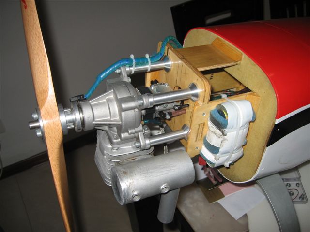

Hi guys !
I am currently building one of those WM extra 300's as well. Mine will be powered with a DL50 (similar to DA50)
I am a bit puzzled about the CG. In this and other forums it was mentioned the CG should be between 6.25 and 6.5 inch. However in my kit manual it says 3.9 inch (100mm). There is no way that I can reach that without a massive load of lead !! Can this be a typo ? I check the manual
on the WM homepage and that one says 6.5 again......?
Thanks for your help

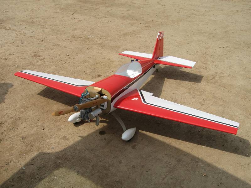

I have to agree with Shesha. There must be much better choices.
I bought one as there was nothing else available in a short time. IMAC is going very well but 3D not so good.
Hardware is absolutely a JOKE !! I have several WM planes and it was always reasonable but this does not work at all. It is the same stuff as on my WM Ultimate 120, which is much smaller.
Wing mounting (tapping screw and normal screw thru wingtube) gives a lot of play on the wings. Dowels in the wings have already a lot of play after 10 flights. Broke both main wheels even without hard landings and tail wheel is far too light.
I fly it with a Chinese DL50 which is doing very well.
It can handle hard landings. I made a serious smash on the landing strip when landing with a 20 mph cross wind and besides severely bending the landing gear, the main wheels (again) and a little crack at the landing gear mounting there was nothing wrong.
For me it was the first step in the gas world and will use this one to trash around after upgrading the hardware, but have a SD Models 30% YAK on it's way :-D

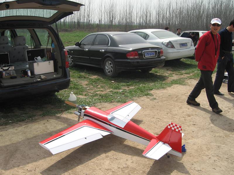

I dont know how other planes end up in weight. MyWM Extra is 7,5 kg (16,5 lbs). That is with 50cc gas engine. CG came out nice between 6.25 and 6.5 inch without adding any lead.
For me the choice was easy, there was nothing else available at that time (are stationed in China) and it was dead cheap. Plane and engine were cheaper than a OS FS120.......
It flies good but I am just not impressed by the hardware and wing mounting, just not usable and not of the normal (reasonable) WM standard.
By the way, I lost the cockpit as the dowels broke out. They were just directly glued in the balsa......Luckily nothing really badly happened
Roald
