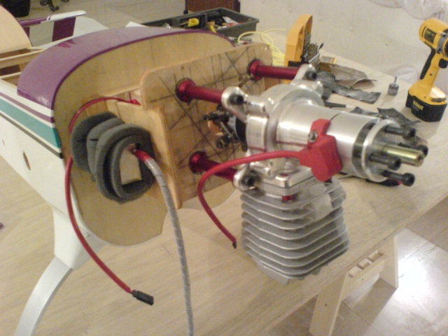

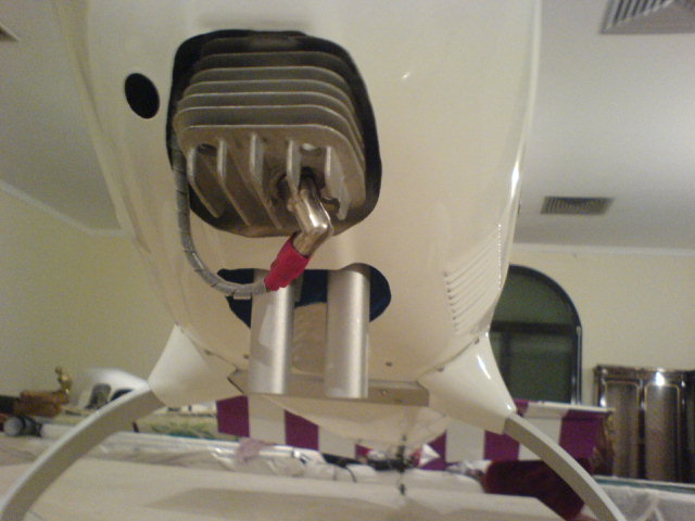

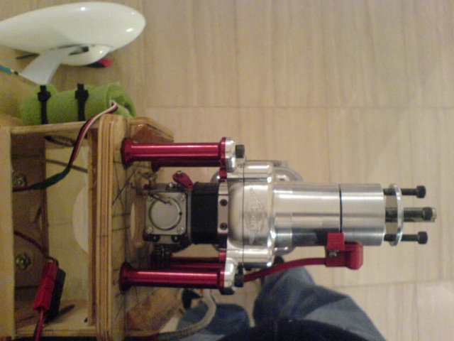

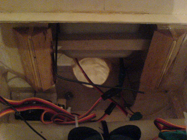

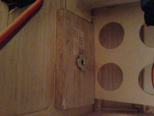

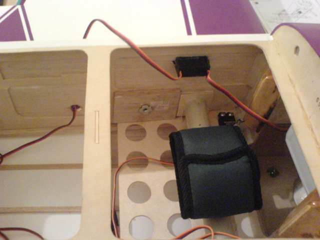

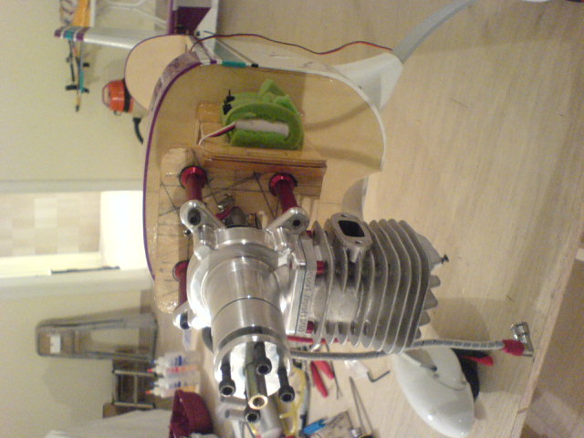

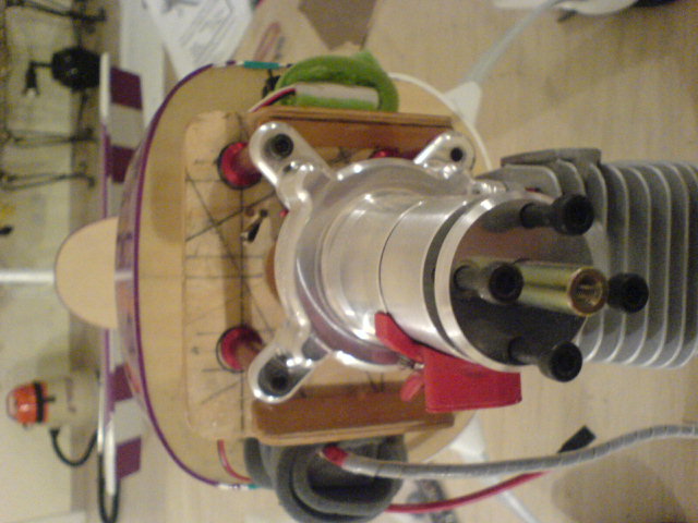

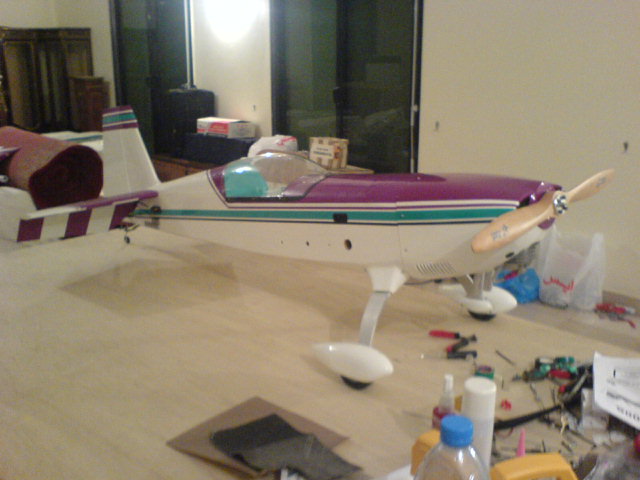

Here finally got some pics going, sorry about the quality took it, from the mobile phone.
As you can see in the pics the the da50, and the, reinforced wing bracket to support the wings instead of the flimsy bolt nut and self tapping screw that WM incorporated, the entire firewall has been run over with epoxy, and finally agev a coat of paint for added protection.
Going to cg the plane hopefully this week, came across this interesting article on another forumn
I qoute " For sure you need extra power to do a good hovering and other 3D maneuvers. Something like 1 to 1,4 kg/HP.
I see more details:
World Models reccomend a 1.6 engine like OS160; this engine is 0,95 kg weight.
The DA50 is 1,33 kg, so you will need to compensate the CG about 0,38 kg. Maybe you will need to add some weight in the tail. Zenoah is almost 2kg ! No way! To compensate about 1,1 kg will be crazy and you will increase a lot the wing load. ( Drop like a stone in this case, even if you compensate the CG).
With DA 50, and the plane around 7kg, you will have about 1,4 kg/HP, more than enough for a good 3D.
So, I think your best choice is the DA50 and do not forget to reinforce the plane for this powerfull engine.
I do not know if the hinges supplied in the kit are good enough and I reccomend some fiberglass reinforcement in the fire wall.
Also use good and strong servos.
Good luck and good flights "
Which should be nearly the same when I cg the plane this week.

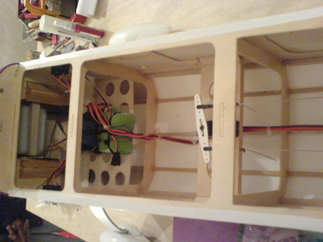

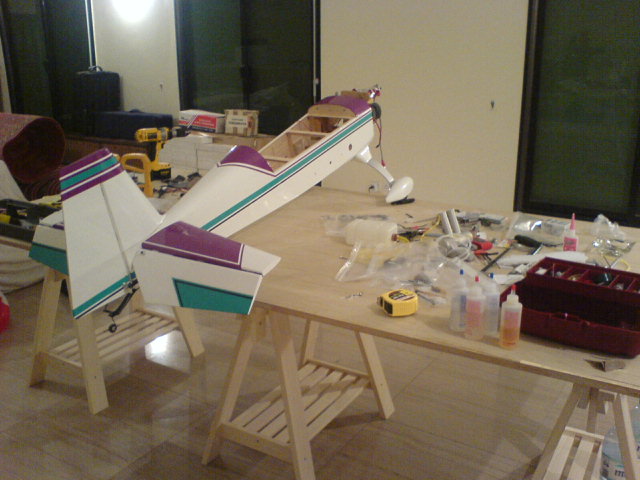

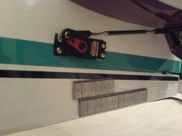

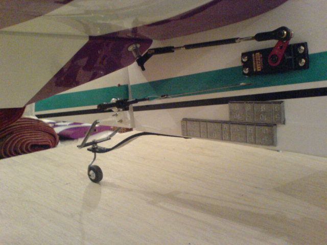

Here are the final set of pics for her, completed.
She is weighing in at 7.5 KG, thats about 241 Oz , and about 16.53 pounds. I had to CG her with 90 grammes on either side of her tail, and no weight whatsoever on the wings. Total added weight to cg her was 180 Grammes at the tail.
She hangs nicely, though the tailservo mounts am a bit concerned about going to re-enforce them with epoxy just incase.
Also using a temporary choke lever, will mount a remote servo handle the choke.
Maiden flight scheduled on 3/2/2006.

Do you think that if the rudder pull-pull setup you have was switched for a servo mounted in the tail would eliminate some of the "sticky" weights ?
CJ
CJ
#32
Joined: Jul 2005
Posts: 452
From: Kuwait, KUWAIT
It would lessen the weight required for sure, but you will need some weights in there, unless you going to find a servo to equal the weight out.
IMHO the added weight is not going to make much of an effect on the flight, ith a DA50 on there she will be fine.

Well no luck on the weekend to fly her, the wm300 extra spent her time in the garage doing checks and rechecks, came across a problem with excessive vibration from the engine being mounted to the firewall directly.
Close inspection yielded the following issues.
Fuel tank was not clamped down enough, so inserted foam and balsa blocks to support the tank in one position completely, as opposed to the stock tank mount. The amount of air bubbles that was generated previously directly related to the execessive vibration has stopped completely. Engine is running better.
The engine needles were rich, causing alot of mid range stutter, readjustments were necessary, which resulted in a smooth idle, will need to tach the engine this coming weekend.
Though the engine vibration is excessive, I believe the prop is out of balance and will require some sanding to balance things out, hopefully lessening the amount of vibration.
I would believe a monokote film placed on the one side of the prop, and prop to be aligned counter the direction of the crakshaft rotation would do the trick.
Will provide feedback shortly.

Yeah baby, the maiden was completed. the plane flew nicely and predicatbly, and man does it it fly on rails, I was flying in at least 20Km wind.
The plane did not need any trimming, dead stick landing was predictable. The CG of the weights are bang on. it just glided in.
Those wing bolts I posted worked perfectly.
I need to open the cowl a little on the down corner side since the muffler is rubbing.
The day ended with some DA50 issues, that am working on at the moment hopefully will fix her up before next weekend.
