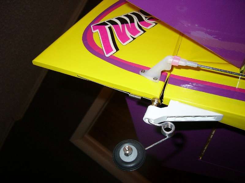

#381
armpit, thanks!
Yeah, the tailwheel is steerable. I used a Sullivan tailwheel assemble instead of the stock one. It mounts to the fuselage instead of the rudder. This takes the force of a rough landing or grass field off of the rudder and onto the fuse. I recommend it along with lots of other Twist owners. Some people use nothing but the Sullivans in all their models. I will also in the future!
