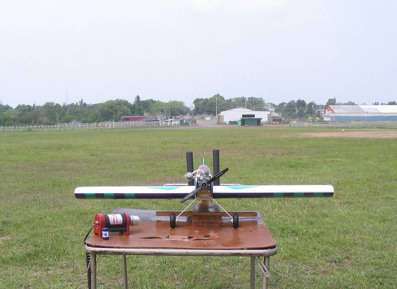

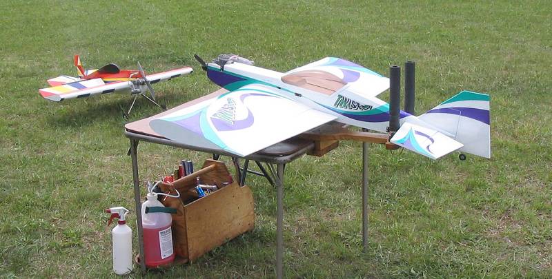

Review of the Twist PNP, Evolution .46NT package:
I received the PNP yesterday at two pm. It was in the air by 1:30 pm today (might have been earlier except for charging the 700mAh bat that comes with it). The first thing I noticed was the short arms on the servos and knew I wouldn't like them. Worse, I have no JR-type long servo arms so had to use what they gave me.
The plane was fine, except for some dimpling of the Ultracote, fixed with a hot iron and blower. When I measured the distances between the wing tips and the elevator tips, the whole scheme was right on, within 1/32th of an inch. Likewise the fin was perpendicular to the fuse. The plane was aerodynamically perfect, except for one slightly bowed aileron, fixed with a heat gun.
I installed the charging receptacle, separate from the on-switch, only to discover my Futaba female plugs don't fit it. You spend the most time setting up the servos with this package. Everything else goes together in a hurry, especially, as in my case, if you've already built 8 Twist ARFs. I referred to the manual only to find something on the Evo .46--nothing, except a reference to "read the Evo manual that comes with the package." None.
I maidened the PNP alone. 80 degree temps, 65% humidity, winds gusting to 23 mph. The engine started immediately and ran through a tank. Without the Evolution .46NT manual, I called Horizon and a tech said break it in with an 11x6 prop. But he said the engine doesn't really need a break-in. (?) The pre-set high end needle doesn't turn more than one full turn, weird. For break in I turned it full rich, but it only took a half turn to fine tune the high end for the maiden flight. I wonder about that needle--and there's no hole in the cheek to deal with the low-end breather setting. For all that, the engine transitioned well and didn't flame out, though the low end needs some tuning. I have a drill.
So after the first tank, I installed an APC 12.25 x 3.75 prop (which the tech said was fine), and put her up. Two clicks of "up" elevator was all she needed. [The CG came in at 5.25, so I added an ounce and a half weight to the drive shaft. She maidened at 4 and 7/8ths--so tail heavy.]
In high winds it's difficult to "read" a plane, but the PNP flew well and the .46 responded well, no flameouts even with my inverted, through outside loop, to hover maneuver. Very good news for me.
I got her to hover in the wind. Got one full revolution of torque roll. But the deciding factor on this bird are the small throws! They are HALF what my other Twists have with long, Dubro arms and S3004 servos. So 3D flying is a challenge, esp. in the wind.
Eric, there's your problem. The throws are minimal--and I have mine, with given equipment, set at the OUTSIDE of the arm and the INSIDE of the horn, maximum for the set-up. I have no longer JR arms, but I'll order them right after this missive. The plane's a punk, a trainer, without those throws!
Consequently, this bird flies predictably, like a trainer, and easy. I landed cross wind twice, then came through the trees to land upwind just to see how she floated--with a CG at 4 7/8ths. NO problem. She flies like a dream.
I couldn't get a good inverted spin, but the throws and the wind were ag'in me. I hovered her at high alpha in the wind for a long time. There was no falling off on either wing. Loops into the wind were perfect. Knife edges needed just a little aileron mixing (because of the wind?). The plane is aerodynamically sound--which holds much promise. I flew her at 100% throws after I trimmed her, two minutes--and for the next two flights. Then the rain came, and I had to close up shop.
This bird, even with minimal throws, shows the identical snap right my other Twists have when given full up elevator.
Without serious throws, she's just another plane. Without dominant tail feathers (rudder and elevator), she's no 3D bird, I'm thinking. On a calm day… maybe. [Who has "calm" days?] But I'll fix this bird with longer servo arms, THEN see how she does.
You have to love the absence of yellow/pink/purple.
More later.
J

Sorry Jack, but your "Secret Plane" isn't a secret anymore! The color change is nice, but as you know I'll not be sending any more of my hard earned cash to Horizon...Someone has to make a stand when it comes to poor service, don't you agree? "Those that have been screwed, unite!"

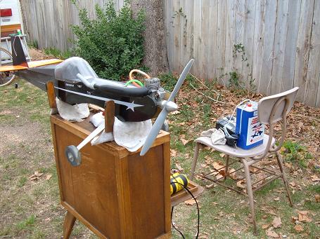

Tim C,
Is that a Four Star? Do you have any problems with the black covering? I'd also love to see a few pics of your field box/ airplane stand, wow! You must have built that 4*, as I don't recall them offering it in that color in an ARF . Was it a pleasure to build or did you have to fight it all the way? I have a 4* 60 that's been sitting around in kit form for over 2 years.........if you say it's worth the time, maybe I should get busy building. What do you say? I have an O.S. 91 FS that would fit nicely in the front too.....how do you like it's flight characteristics? Questions....Questions....Questions......
Yes! The Impress does have ailerons. I've used a single Hitec HS 81MG for the ailerons, two Futaba 3004's for the rudder and elevator (I'm saving my other Hitecs for a special project) and a HS-55 for the throttle. I had mounted the battery quite a distance back thinking that's where it was needed, but was I ever wrong! I initially added (just to see what was needed, never intending to fly with that much) 2-1/2 oz of lead in the nose to balance it out! I have since removed all the added weight and just moved the battery as far forward as I could (abutting the firewall!) I haven't weighed it yet, but I'm guessing the all up weight to be 1-3/4lbs. I haven't flown her since the other day, but I'm expecting 11-13 minutes out of her 4 oz tank. (She flew for six minutes the other day on a hair more than half a tank, but that was fighting 25 mph winds, too.) This is the smallest glow-powered plane I own, but I have a few engines all the way down to a Norvel .049 RC just looking for a home.......any ideas? I would love to see a 1/2A airframe similar to the T _ _ _ T.
