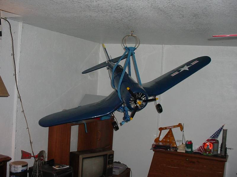

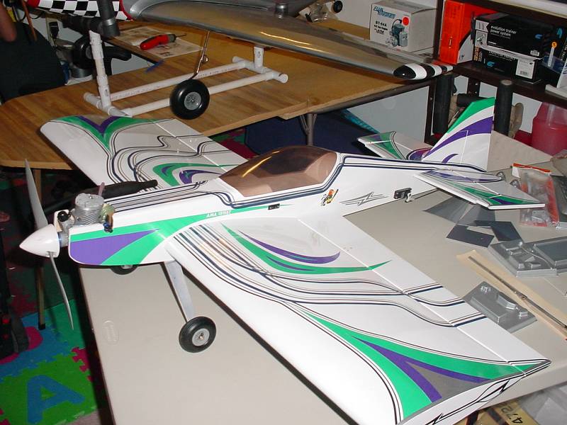

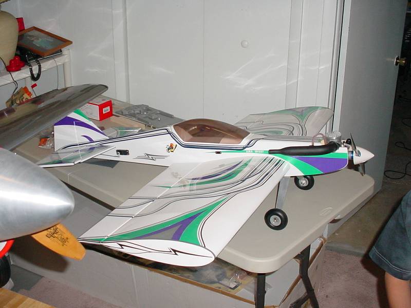

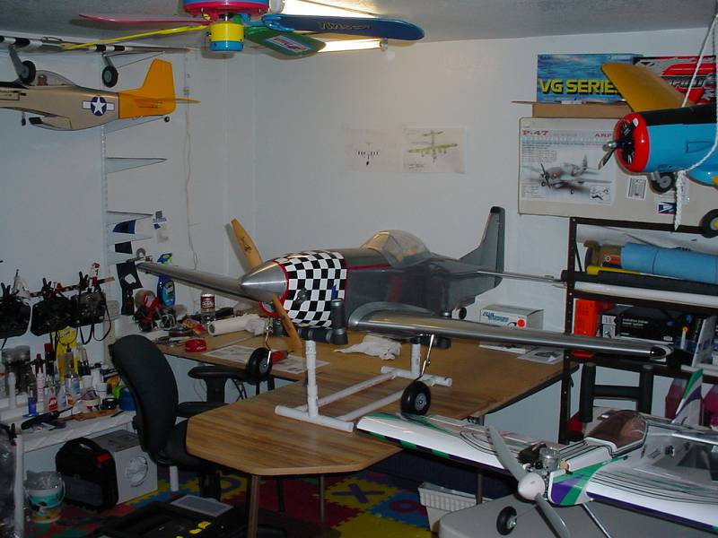

Just thought I would show a couple pics of the TWIST & threw in a pic of the P-51 I'm building & corsair. Pics on the wall behind the mustang are some designs for planes my son drew for me. I'm done now.
