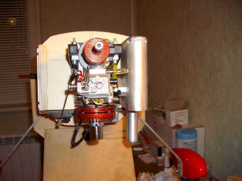

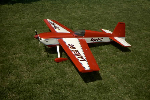

I have just completed a Lanier Edge 540T 1.20. I am using an OS 160 with a Bisson Pitts Muffler. I would like some feedback on the suggested CG of 4.0 to 4.75" from the leading edge at the fuselage. I chose not to mount the elevator servos in the tail, as suggested in the manual and installed two servos in the fuselage with carbon fiber rods crossed to control each half. I also have a pull-pull setup for the rudder. The installation turned out better then expected. The problem that I am having is that I will need to add almost 14 oz to the front behind the firewall to get the recommended CG even with my battery(1100 mAh) and the throttle servo also located behind the firewall. I would like to hear from some others concerning their setup with this plane.

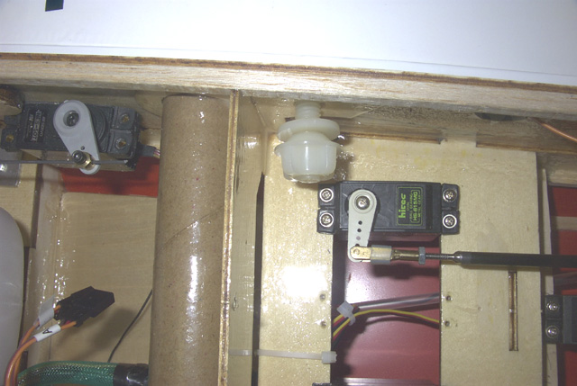

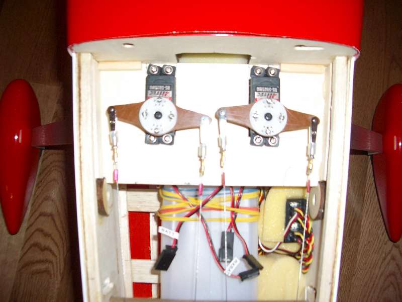

I am adding some pics of my build. We have added wing bolts at the fuselage instead of the bolts through the wings. Also, note that we built a box and attached it to the bottom behind the pitts muffler for the required weight to balance at the recommended CG. This way we can adjust the weight with the hatch on the added box.

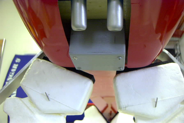

Old 04-12-2004 | 10:40 PM
Liv2Fly's Avatar
Joined: Aug 2003
Posts: 39
From: Dallas, TX
Default RE: LANIER EDGE 1.20 CG PROBLEM

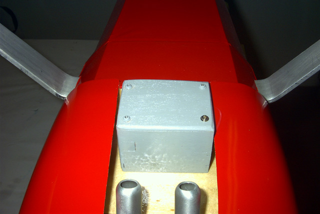

Here are the pics of the box mounted behind the pitts muffler.

Yup, unfortunately, this particular kit does build tail heavy. Having a personal dislike for having to add "dead" weight to planes, after I read about the tail-heavy nature of the plane, I just decided to use a larger (heavier) engine up front. I put my trusty ST 3250 on mine! Given the bigger engine, I also doubled the firewall. With this set-up, I was still able to put my elevator servos in the tail, though my rudder servo (set up for Pull-Pull) is mounted under the wing. With my battery pack up by the firewall, the CG fell right into the recommended range, and it flies great!

This ARF does build tail heavy due to the increased length, almost 1.5" in the rear turtle deck area as compared to other manufacturers planes. When you look at the overall length of the plane it almost resembles a pattern plane from the cockpit back.

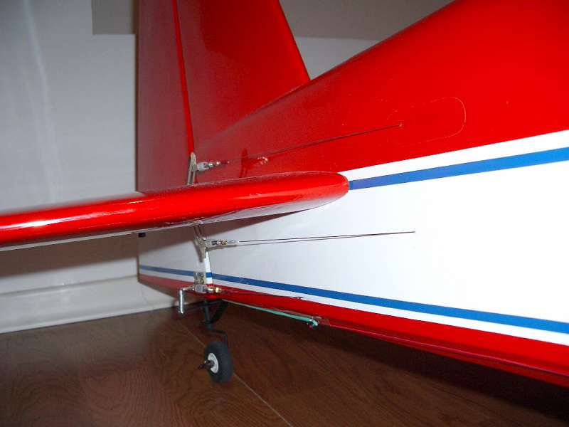

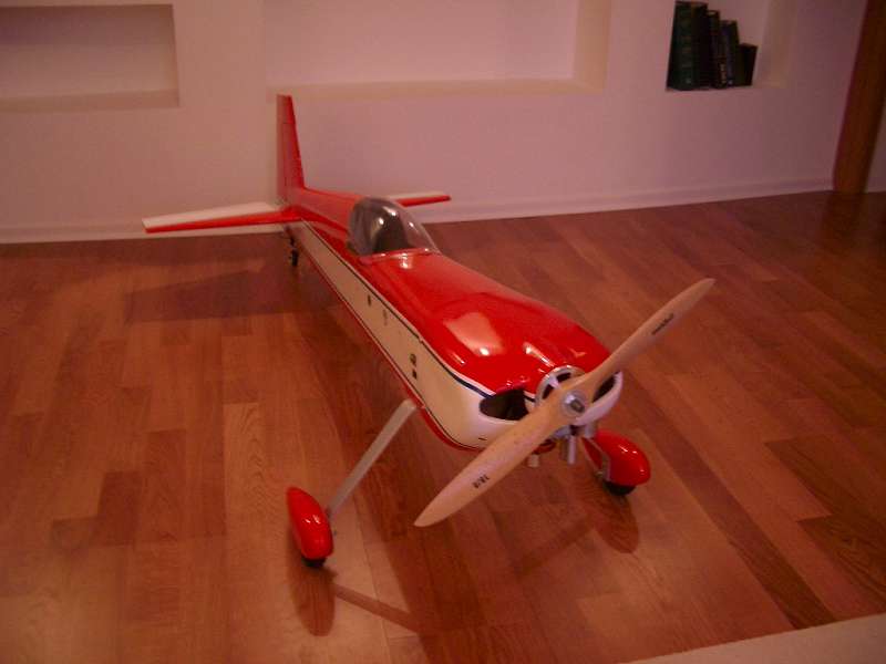

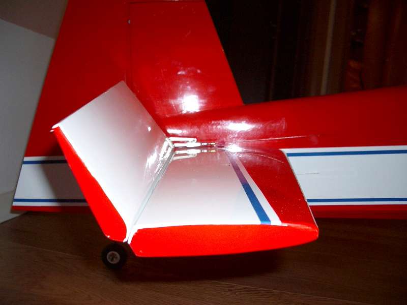

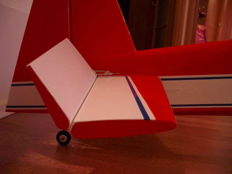

Old 04-16-2004 | 11:56 AM
Posts: 16
From: Moscow, RUSSIA

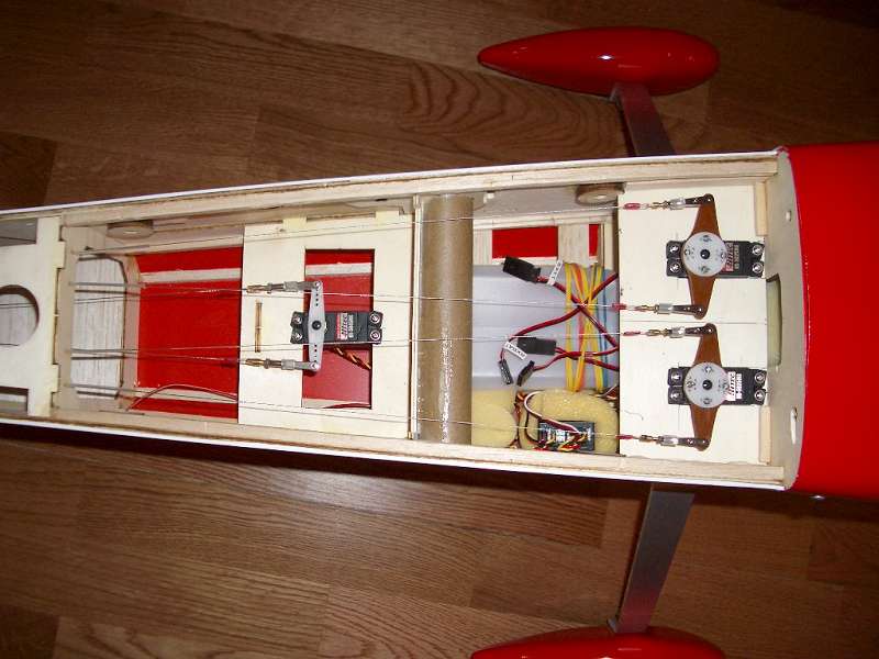

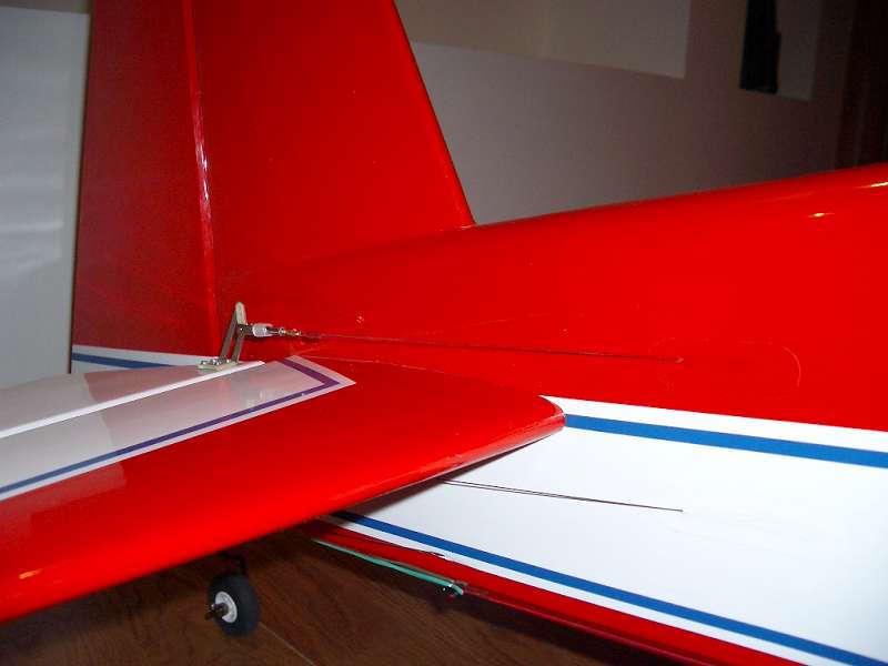

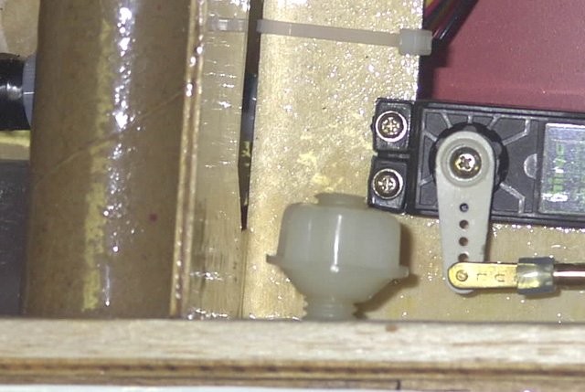

Hi friends
Look What I did to get correct CG.
I was used pull-pull system on rudder and elevators
The plane is with MVVS 160 engine.

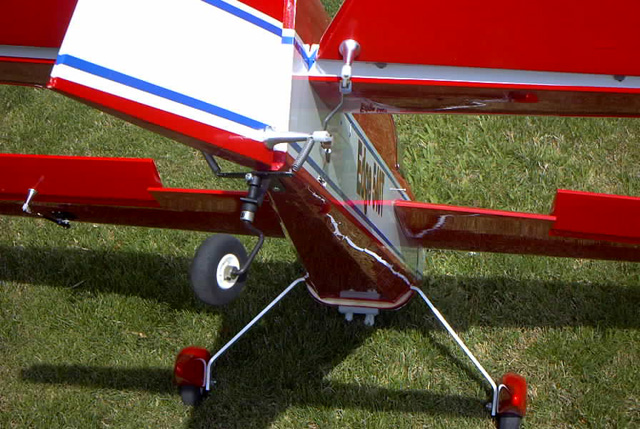

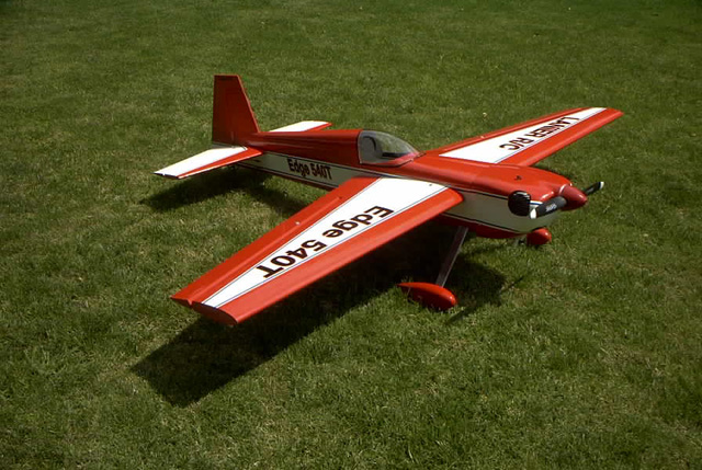

I saw in the marketplace that U R selling this plane.. DON'T DO IT!!!!! This is the best flying plane I have ever had!! It will fly well with the CG aft of recomended.. I have all three servos mounted in the tail, with a heavier Moki 210 up front.. I'm not sure how many inches back from the leading edge my CG is, but with the hatck off, it balances from the wing tube.. The extra long tail moment and the oversized horizontal stab allow the plane to fly with the cg back.. Mine tracks straight and true, with very little down elevator input for inverted flight.. It is a perfect IMAC plane!! It also 3Ds very well! very solid harriers, and easy torque rolls! The only thing it won't do is Wall.. It just flies on through.. Mine weighs 14 lbs.. a little haevy, but that's the Moki!!! It may be on the heavy side, but it flies so good, you would think it weighed 10 lbs!! It doesn't act like it's oerweight!
I'm certain that your plane weighs less than mine, even with a little lead up front! Don't pass this plane up!! It's not a pig!!
