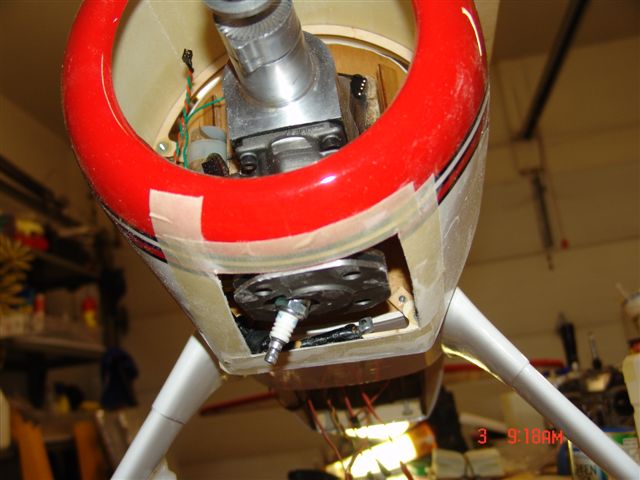

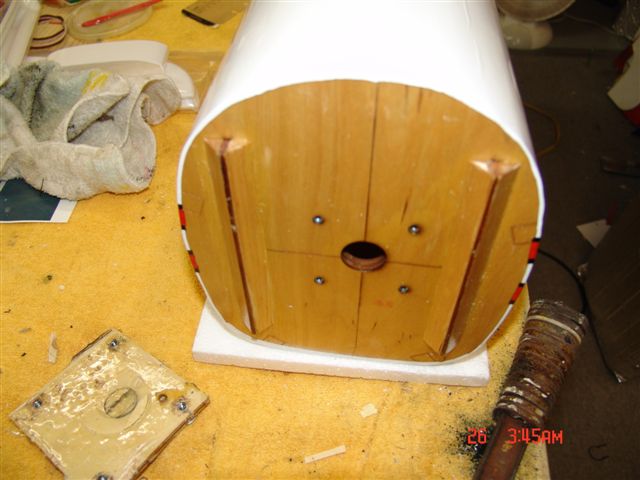

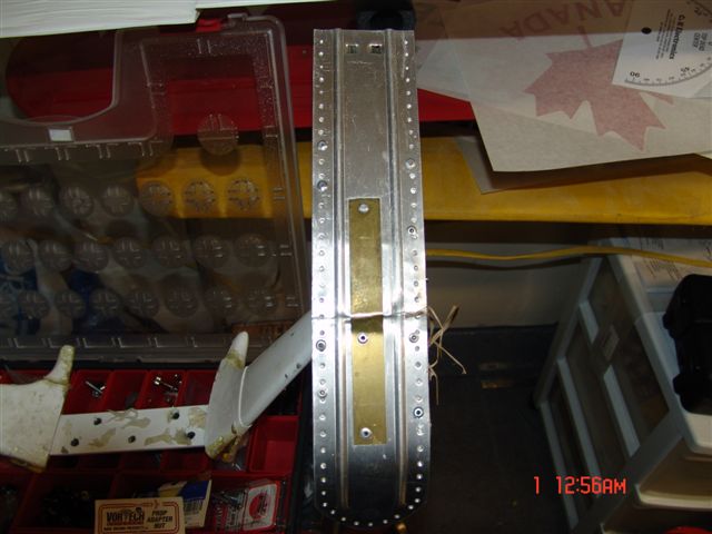

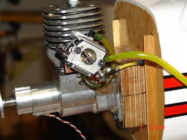

These pic I posted, are the mods I am doing on the new Stearman. you can see the carbon fiber inside and the strengthning of the landing gear plate with carbon fiber. I also throw away the ca hinges and go to Robarts. Gas engines shake and ca hinges are not reliable. I have had problems with ca hinges with gas engines. I only use two servos on ailorons and have had no problems,ran really well, plus I like the look of the connecting rod between the two ailorons.
I will be taking more picts of the build and you will see the spacer I made for the FPE 40cc engine. I am using the smae spacer that was on the one in the crash.
t
t

You can see the wider holes for the blind nuts for the FPE 40cc. I noticed on this kit the dowels for the wing are now in plastic. I used them hoping they wont be a problem. I guess they are lighter than the wood ones that were on the earlier kits. working on it every day; hope to have it in the air in a couple of weeks.

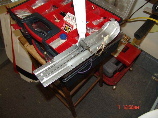

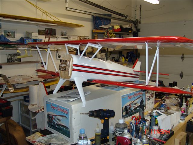

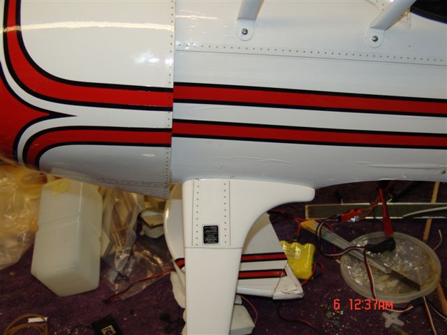

Well, for those that wanted to know about the skis I use on the super stearman, there they are. These mind you have about 800 flights on ice and snow, as the plane had over 1100 filights, so the others were on grass with wheels. The Jay Dee skis wore out, so I had to put a piece of copper, popped rivitted it. but the skis were still bending, so I installed L aluminum brackets and that served me very well.
As you can see the new stearman is coming along very well. I also use the box to elevate the plane, at the point where the cabane struts have to be installed. It makes it easier for me to see everything much better. Also you can see my engine spacer for the FPE 40cc. That's it for now. Hope you enjoy the pics.

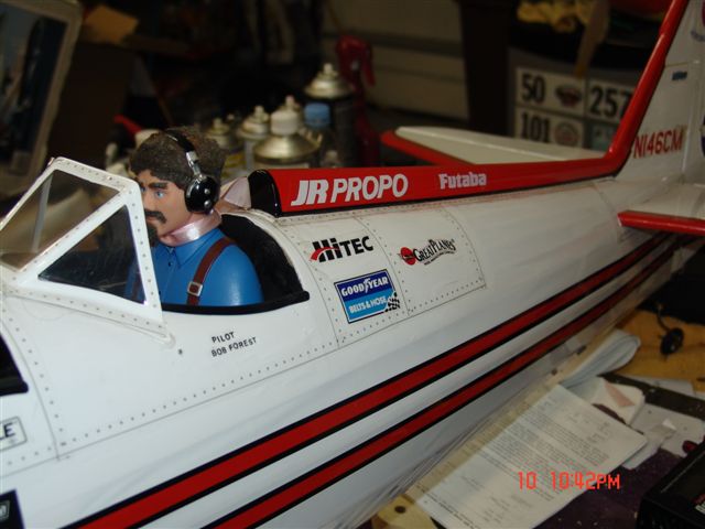

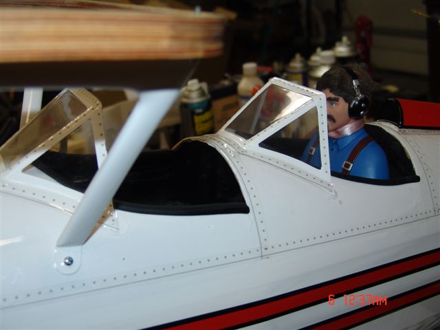

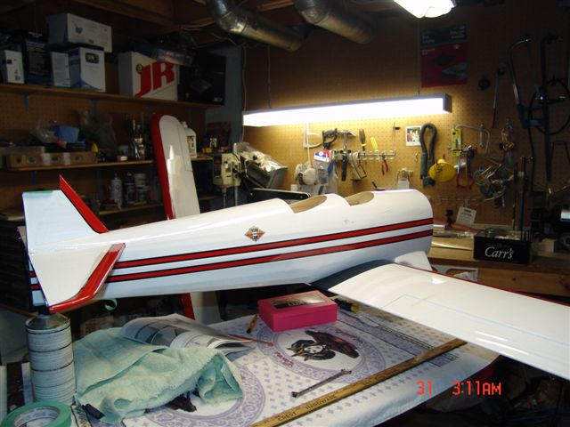

Hi, as you can see my new Super Stearman is coming along. I even used my old reliable pilot. As it was not his fault the crash, it was mine for not checking my batteries. Only have a few more hours and I will run the engine, hoping nothing happened to it in the crash. I re used the pushrods, and I must say, building a second one, was much easier.Also faster, still close to 40 hours once finished. The FPE 40cc fits in really well. I still have to balance it, but it should be ok, as I had no problems with theother one. Don't forget I don't have to add 20oz of lead and a box to balance it.

Hi, well the Stearman is all finished, she weighes 15 1/2 lbs, ready to go. and that is with a FPE 40cc. She balanced right on the money, she is 2 1/2 lighter than my first one was. As the first one having over 1100 flights and repairs, ended up being 18lbs.
I did damage my engine in the crash, I found out when I went to try and start it. So it has gone back to FPE, so now just waiting to have the engine back and will fly her as soon as I get it. The weight is with the skis. I did not even install the wheel pants as I use the steaman only in the snow. Once in the air will have more on her. Oh, by the way, as you know I would put a decal on the old steaman to cover up a hole or damage. I got to like it so much, that I put a bunch of decals on this one. It looks great.
