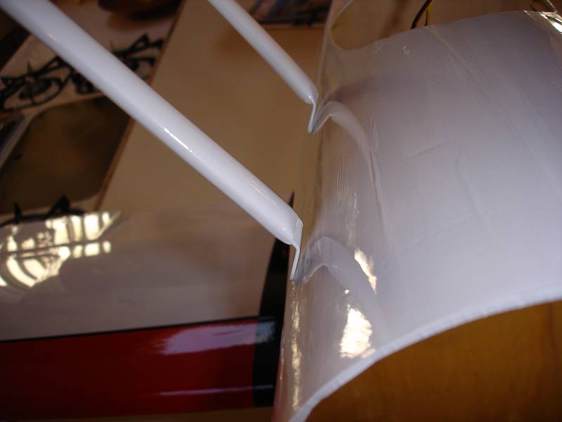

I'm putting mine together and have a couple of questions.Did anyone have any trouble with the cabane struts not being flush with the fuse when I put the top wing on.The left side seems to be fine but the right side is off.i checked everything and I'm sure i have everything right.I even disconected the N struts and it still wont sit flush.Also, if anyone used a saito 150 and you have a smoke system which smoke system and muffler did you use.Thank you
