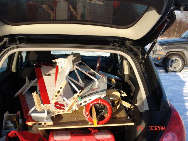

Well guys, they all come to an end. Yester after the 4th flight, did something I never did, forgot to check the batteries. It was extremely cold but sunny and just beautiful. Take off nice, then oh, oh, right ailoron turn, and oh, oh, wont come back, did rudder, and it rurned the plane back towards me, and throtted went to low, that was the last signal it took, and nose down it came. not much left as you can see by the pics. The inverted pass was my last one the flight before. Would you believe the batteries were at 3.6 with no load. Lesson learnt, check, check and check those batteries before it happens. She owes me nothing, over 1100 flights in one summer and three winters, as she became my winter plane only. I am a lucky guy, also found a brand new in the box Super Stearman GP Arf for 350 cdn. So will have one back in a good 3 or 2 weeks at the most.

Tough go, MGA---- Thanks for sharing all your experiences with the plane. Eventually, the cost of admission gets us all, and with 1000 flights, you got a ton of fun out of that beauty. Got any ideas of what you'll do different with the new one? Did your engine survive?

Yes, the engine is OK. Re changes, I will definitely reinforce the landing gear block, from inside with carbon fiber. Also carbon fiber as much as I can see the firewall, that is a weak point of this plane, for engines my size. 40cc. Also make sure the stab is well glued, take off the monokote and make sure it is wood to wood, with 30 minute expoxcy. The wings are OK, will still go with only two servos, never had a problem, and I like the look of the strutte that runs both ailorons. Again, I will use this plane only for winter, so skis will be the way to go. It is a wonderul plane, and a great kit for the money. even at full price. Also will re glue or cover with fiberglass cloth the small wooden pieces that have the holes to put the bolt through to reach the blind nut in the cowling ringg. This is a very weak part of this plane. The wood is cheap and most probably will go to a better plywwod and a little thicker.
Wil coat these pieces with epoxy and very light fiberglass cloth.

Oh Wow! Sorry Dude!!! That looks a lot worse then mine did. Hope you can salvage something out of it. Couldn't help but notice the earlier pics. How's the fishing in that shack???

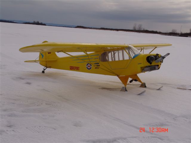

Go to poste 671 and 674 you will see how I dress, yes I dress very warm as sometimes it is 30 below. I wear Ski gogles and that really helps. Yesterday I was flying again but with my 108" Cub
I know this is a Stearman thread, and will be back with a new one in about 3 weeks.
