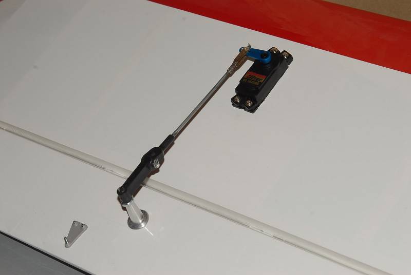

Kvisto: Thanks, slaved servos on seperate channels for Ailerons. Hitec 5645 MG digital servos on everything. I beefed up the hardware for the clevises, rods and control horns on all flight controls.
