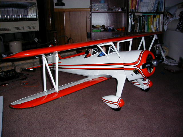

Got mine done and just have to set the throws and balance it. Just waiting on a good calm day for a maiden flight. Lord willin take it home together in one piece.

Mine didnt nead any weight added. And I put a G26 and my battery and reciever were on each side of the servos and stuff. I would figure that you would need a bit of weight. It says with an OS 120 you need about 18oz of weight give or take. Mine balanced perfect with my engine. No doubt that 150 will do the job though.

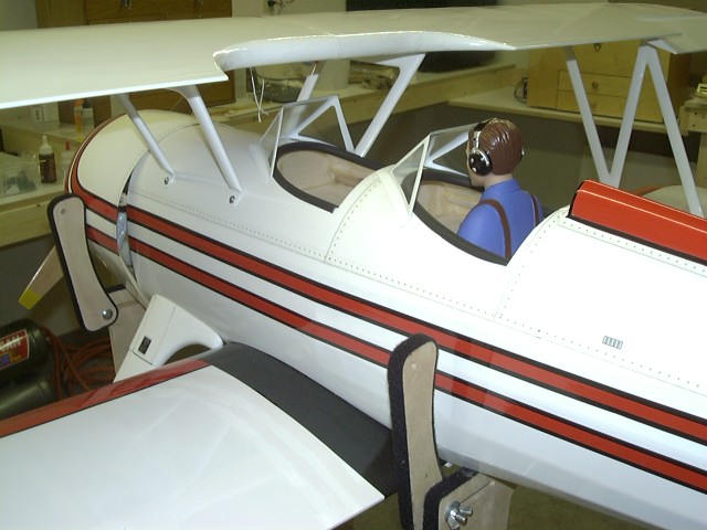

I finished one of these Super Sterman Bipes for a customer last week. A Saito 150 was used, Hitec 635 bb servos for all control surfaces, slaved the top wing ailerons to the bottom, Hitec 425bb for the throttle, Hitec receiver, 1650 Ni-mh receiver battery, Cermark HD switch and no weight was required to attain the recommended balance point. I used an incidence meter to set up the top wing since I noticed that the top wing would "rock" while I was trying to mark & drill the mounting holes in the fuse for the cabanes. While the rivet/panel line decals took some time to cut out and apply, they sure enhanced the look of the Stearman. I did add the simulated flying wires as per the instructions which helped the look a lot.
The test flight was uneventful. The take-off was straight down the runway, the tail lifted after a short run and the 150 had plenty of power for the Stearman. Since this was not my bipe, I just trimmed it out for straight & level flight and landed after a few laps around the field. The landing was great...it just came in for a nice wheel landing, then the tail settled and I taxied it back to the flight station. I think that the new owner will let me wring out the Stearman a little in the near future and then I will let you guys know how this one does.
Great Planes certainly did their homework on this bipe...it builds easily, the instructions are wonderful and it flies great. Also, it is beautiful on the ground & in the air!!!

I have finished building and flying the GP Stearman and will share some of my thoughts and experiences. I purchased a built Stearman of unknow origin a few years ago and really enjoyed flying this thing for several flights. It met an untimely demise when I flew the battery out of it. The old Stearman flew on it's own in a big circle for about 5 minutes losing altitude with every circuit until it crashed full speed into the ground. I haad intended to repair this plane until the one from GP came along. I operate a hobby shop in Van Buren Arkansas.
When I received this ARF I was extremely pleased with what I saw. I havew been modelling for 50 years and I can't build one that nice. The finish on the landing gear and cabanes was superb, flawless gloss white better than I have seen on any model. I don't know if it was powder coated or what but it is perfect.
The parts fit was excellent, I mean excellent for all parts. The construction of the plane took about 12 hours. Wing alignment was eezzzzeeeeeee. The wheel pants and engine cowl eeezzzeeeeeee. Everything fit and everything worked as it should. I installed an new but older version of a YS 120, before the air chamber. I have read the comments about the spinner not fitting the props and the hinges etc. and that because your trying to use too big of an engine and prop. Use what the paid engineers designed this plane for.
I opted for the four aileron version and soldered the two elevator wires together instead of the clamp but this was the only deviation from the plans. This thing is gorgeous when done and now for the flying. The YS has a tick over idle and I mean slow to the tune of less than 1000 RPM and instant throttle response. I used no additional weight and didn't even put in the weight box. I might haave been a tad rearward on the CG but not much if any. It required just a little down trim to keep from climbing and it flies comfortably on about 1/4 throttle. loops, rolls, stall turns great. I have only flown it once and then a short flight. This thing is a total winner in my books.
