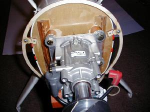

I'm posting my pics of my G26 installation in a new thread in case anyone wants to check them out.
Old 05-14-2004 | 03:22 PM
  #96
My Feedback: (62)
Posts: 1,171
From: Saratoga Springs, UT
Default RE: GP Super Stearman
Where? Can you give us a link? Ok... found it http://www.rcuniverse.com/forum/m_18...tm.htm#1815028

here is how I am mounting mine...
