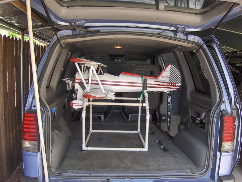

also whats best way to transport this baby? take wings off or too much of a pain?

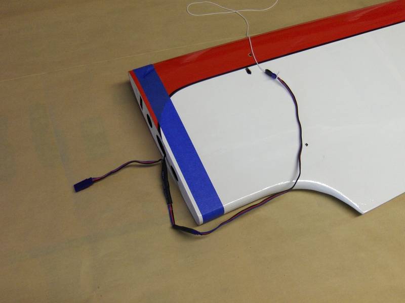

I have a question about using 4 servos for the ailerons. The way I read the instructions is, they are saying to put both top seros in a Y harness. Then they installed one Ernst charging receptacle in the fuselage. I though the left side upper and lower would go together. And the sameon the right side. So you would have two places, one on each side with the the ernst charging receptacle. Then inside the left side would go into a Y harness and the right side would go into a Y harness. I hope I'm not crazy
#1336
Posts: 1,331
From: BILLERICA, MA
That's the way I would do it if I did 4 servos. But why do you need the 2 extra servos, I am just using 2 126 oz servos in the bottom wing and slaving the top 2 off of them.

They say it is easier when removing the wings. And I was thinking of flutter. I'm using a 50cc gas engine. The guy I talked to said that the two top servos go together in a Y harness. When you hook up the control arms they face to the wing tips. So I guess that way they move in different directions?

If you go back a few pages in this thread I show at cool way (with pictures) to install and hide the “Y” harness inside the top wing, before gluing the two half’s together. Someone in a previous post mentioned it and it worked out great for me. You end up with only one wire that plugs into the Ernst plug that looks nice and clean. If you think about it with the way you mentioned you will end up with wires all over the place. I was thinking the same way but I did a few a diagrams on paper. When you see it on paper it makes sense to do it the way they say in the instructions. Actually as I remember I think they didn’t explain it that well.
You don't use just the one ailiron channel, you use 2 channels. The way it’s done is by using an auxiliary channel (I used cannel 6, Airtronics) on the receiver and then mix the aileron and the auxiliary channels together. It has been working very well for me.
Some where in the previous posts I also show how I built a traveling stand for my Stearman. I just mount the assembled plane on the PVC stand, hold it down with bungees then put the whole thing into my Ford Aerostar minivan, then bunjee the stand to the floor. When I get to the field I just pull the whole thing out at one time and I’m ready to fly. I disassemble the plane every few outings to check that nothing is loose inside.

I was going to run one servo wire from each side to a ernst jack. In side the fuselage I would have two Y harness. The left side would be together and the left side would be together. One side would go to #1 on the receiver and the other to #6. I was thinking that way if I wanted to use flaperon mixing. Has anyone tried to use Flaperon mixing? I will go back and see what you are talking about. Thanks for your help !

I found what you are talking about around page 37. I went back to page 20 and never found any pictures. I did find that everyone has their own idea on how to do things. I'm going to do the left side together and the right side together. If I was to have a reason to pull out my cables I would not be able to do it with the Y harness inside the top wing. Thanks for your help
#1341
Joined: Aug 2005
Posts: 356
From: Covina,
CA
Capt. Ron
Sorry I thought I had posted these pics before. I guess I didn't. The old brain ain't what it use to be!
Here is a few pics showing how I hid the "Y" in the wing.
Pic #1 is the wire set up before I pulled it through.
Pic #2 is after it is pulled through.
Pic #3 shows the lead wire that goes to the Ernst connector and wire I used to pull it through the hole next to the cabana.
Pic #4 shows the lead wire pulled through, now the "Y" is inside the wing and the other side of the "Y" that goes to the opposite servo.
Pic #5 shows the "Y" connected to the lead wire of the opposite servo before I epoxied the wing half's together.
(I'm going to try to put all 5 pics on this post. If it won't except them all I'll post the rest on the next post)
I'm not trying to tell you what to do but I have only 1 wire to deal with and I'm very pleased with the way it came out. After you assemble and disassemble the Stearman wings and cabanes a few times you will understand....You'll see it is a pain in the rear putting in and taking out all those screws! There is no easy way to do it. I used Philp head screws but the heads strip out easy. I recommend using the SHCS that they provide in the kit...still a pain.

I forgot to tell you. I covered the lead wire that goes to Ernst connector with white electrical tape and attached it to the cabane with zip ties. It looks nice and neat. And works well since I don't have to disasseble the plane that much.

Here are some pics of the PVC stand I built for the Stearman. It works great! I guess I’m bragging a little but it’s a good feeling when you build something that works well. And I hope others will get some ideas from what I have done.
I used #4 Philips head screws to hold the PVC together. If you glue it and have disassemble it for some reason, which I did a few times, it’s a going to be pain. The 2 tubes in front of stand on each side of the plane are not screwed. I let them rotate so I can sit the plane on the stand easier.
The Stearman is shown with out the cowling because I built the stand before I finished the plane but it does fit in the van with it on.

Hi Shubova. Thanks for all the pictures. I went with having two wires, one on each side. I hope I won't need to take the wings off all the time. I want to try flaparons. I don't know if it will work or not. I might try mixing with the elavator in the landing mode. Thanks again !!

Hey Shubova, What type of minni van do you have? I hope to buy a used Toyota real cheap from where I work. I want to do a split level with some plywood, and some plywood slide outs. My old Ford F350 crew cab dully is to stiff and rides like hell, even with sand bags in the back. Take care

It's a 1997 Ford Aerostar. It's a close fit I have to move the rudder to one side to get it through the back door but once it is in it fit okay. Ford no longer makes the Aerostar they replace with Windstar which I think is a little smaller. Check the length of the Stearman then check the width of the Toyota. Like I said before it's great not to have to brake the plane down every time I fly.
