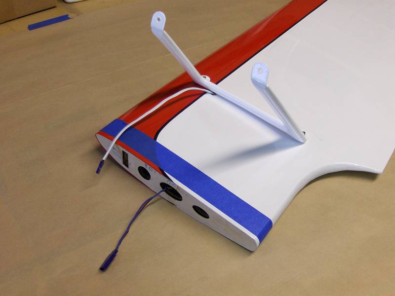

This is a sample of a set of pictures that I took showing how I assembled the upper wing with servos. I hid a Y harness in the wing and only have one lead wire coming out. I covered the wire with white electrical tape (next time I will use white shrink tubing) and will run it down one side of the center cabane. This will connect in the connector that is in the fuss per the instruction. The idea is that wire will be barely noticeable. This pic is the finished assy of the hidden Y harness before I glued the two wing halfs together.
If anyone is interested I will post the full set of pictures that illustrate the procedure.

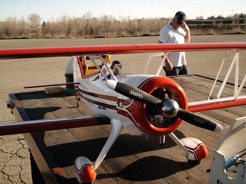

Well I finished my Stearman, it's ready to fly.[sm=biggrin.gif]
I built a stand out of PVC so I don't have to disassemble the plane.
Here are a few pics of the stand and the plane, and how she fits in my Ford Aerostar minivan.
Now days with gas prices as they are I just use the van to haul my planes and utility.
You will notice I had to slant the 2 front uprights forward so I can get the wheels around the stand but it really isn't that hard to load on the stand. Then I strap it down with bungee and load the whole thing in the van. It will fit with the spinner and prop but it's a little easier to load with out them.
The only things left to do are the decals, fly wires and wanted to add 6 red stars across the top wing.
And we are off the field this Sunday for her maiden flight.
Shubova
[8D]
