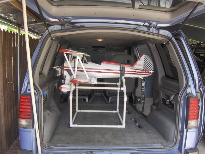

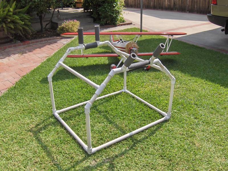

Shubova, very nice setup, now you need to really look at the Cline fuel system , I have it on my Saito 180 inverted on a kangke Waco UPF7 because of this issue. It not only resolves the siphoning problem but provides a positive fuel flow and allows positive engine performance.
