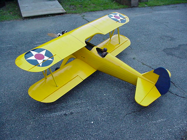

Well, I guess you drew me in on that one. That's okay, but as you can see, it can be taken seriously especially when an incident just took place. So, lets get on with this thread. One should be aware when to step in on something like that or just keep quiet and let it settle down.
Now, as I asked before, what is your interest. Do you have this stearman or would you like to get one? Let's talk about planes. Okay? Great!

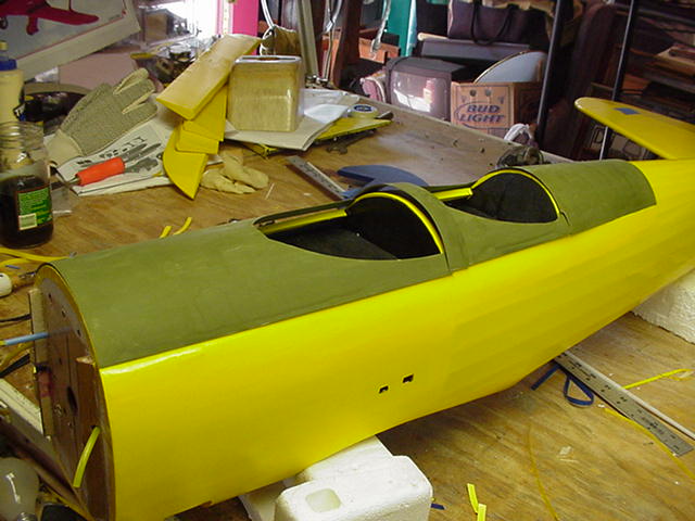

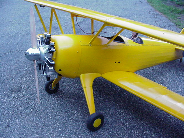

Here's mine after a rebuild. I smacked the ground on a high speed pass and drove the gear though the wing and knocked the wing tip off of it. So, off with the old cloths and on with the new dress. I really enjoyed being able to do a little scale work on it. Scale is my new challenge now. I have been building and flying so long that neither is much of a challenge. So, I decided to take scale on to keep from burning out as I have so many times in the past.
Do you do scale or are you pretty much a sport flier? Do you have any photo's to share? We, at least I am interested in your views and conversation.
Thanks for coming on this sight and being a part of the group. bird.

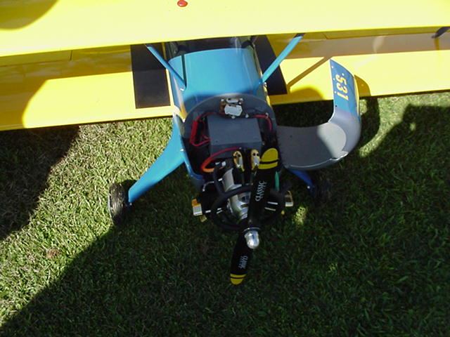

Al and Shubova, here are some photo's of a 170 in a redone GP Stearman at a warbird event. The finish is actually paint and right out of the gun! He claims that he didn't have to polish or wet sand or even clear coat it. Amazing! I posted these before so just in case you missed them, here they are again.

bigbird,
That a very nice plane you have there. Just goes to show wrecking doesn’t have to be a bad thing…look what came out of it. I’m not sure if you mentioned it before but can you give some info on how you did the mock engine. That is a mock engine?
Looks like you and I are about the same age. I got out of the Army in '69. My favorite 1st Sargent (most people hated) always use to tell me "You can't bull sh_t a bull sh_ter", although I tried. May be that's why we got along.
Back to the Steaman what engine are you running in there? Is that new landing gear...mine cracked about the second landing. I was talking with a guy who makes props and masks for movies...I was thinking about taking the landing gear have him make a mold. Stripping off the fiber glass then have him cast them in yellow rubber. Maybe over doing it but its an idea.

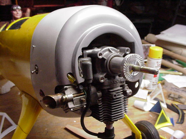

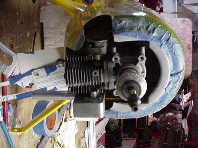

Hey Bernie, thanks for the complements. Yes it is a dummy engine. I have some photo's of the process. I have an original G-23 with a magnito. The only thing I don't like is that it has a B&B box muffler. It keeps the oil in too long and causes it to cook and comes out black! The Pratt 450 manual says that when they are rebuilt it should use about one gallon an hour and when it gets to three gallons an hour it is time to rebuild it. Mine looks like it has a six plus burn! It's worse than wiping glow fuel off! I use the gas mixture to break it down. Does pretty good.
I couldn't install the cowl and engine in one piece so what I did was to drill three holes in the collar that the engine slides into and put back up wood in the engine as a 'nut' and also had to put a tab in the lower left hole in front of the engine and extend a tab down and put a screw thru the left bottom cut up cylinder to steady it. I had to really butcher the bottom two cylinders up to keep them. You can see one of the holes if you look closely. I also filled the two cylinders with micro balloon epoxy for strength. Wasn't much left of them.
Your DI was an exception in those days. They were pretty tough and called you everything but your name! Now they can't be mean to you anymore. As far as I'm concerned it really seperated the boy's form the men. Not as many 'girly boys' got thru back then. Anyway, can't say too much about that cause you don't have 'freedom of speach' in everything, just what they want you to say! Which of those ammendments were we fighting for? I wish they would at least list them. Viet Nam, 1970-1971. No big deal!
bird.
Sorry but I keep editing this thing!
Yes they are new gear. They are cracked already too. Sounds like a neat idea you have. I took my old ones apart and it looks like they cast them and then overlayed them with glass cloth and finished them. There needs to be an AD put out on them! hehe! Perhaps they can relieve the fit area and give them an eigth of an inch or so, so they don't press against the fuselage. As long as this bird has been out surely they have seen the problem. That rubber you are talking about needs to be paintable with fuel proof stuff.
later.

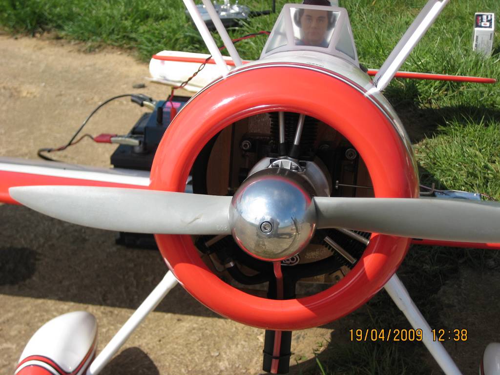

Here is a video of my stearman with a roto 35. Second fligth after a complete re-covering job.
Enjoy!!!

Very nice job there buddy. I don't think I have seen that particular engine. Do you have a photo of it?
One thing I did notice though, when you land, try to wheel land, it will be very realistic. I have found mine to be more managable that way. They seem to bounce all over the place if you try to three point them especially on pavement. We have a very nice grass strip and it is a nice combination.

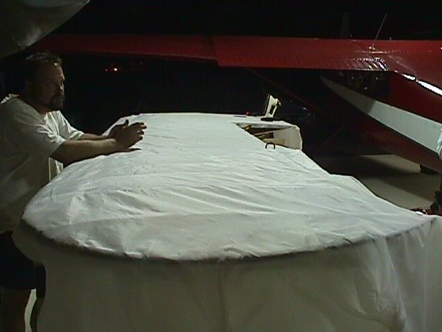

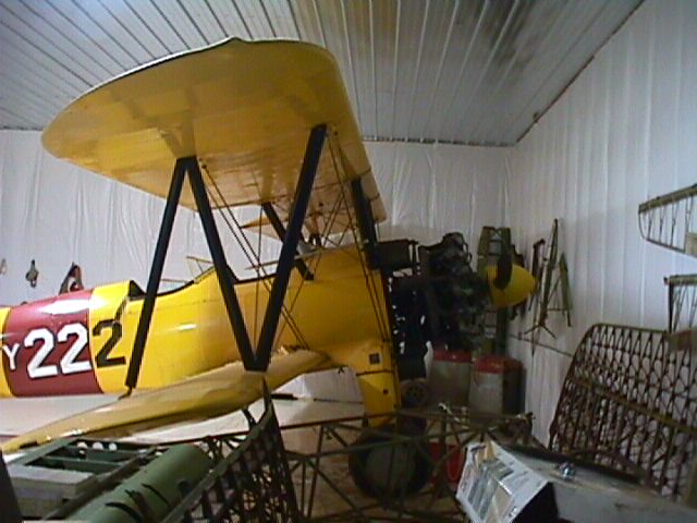

Here are a few photos of the Stearman wings we have been refurbishing for it. Hank is in the first picture. He has enough parts to build about five planes. His plane is what I did my version of. Nothing more than a BIG model airplane! The rotten trailing edge is a result of rodents, rats and mice, getting in the wing and urinating. Very strong smell! All rebuildable.

Hi Bigbird. Thanks for the tip on landing. The plane is nose heavy, and I can´t make it to drop the tail at slow speed, or at least I didn´t want to push it. I have to move thing a little to get a better balance. This will help. Also the wheels are stock, and I think I will replace them.
The roto engines are beautiful, just a little heavy for its size, but they run very smooth. I have to change the prop for a lighter one, to get a little more power and better acceleration. It has a Classic series 20x8.
Here is a link to the engine, mine is the 35vi, red head.
